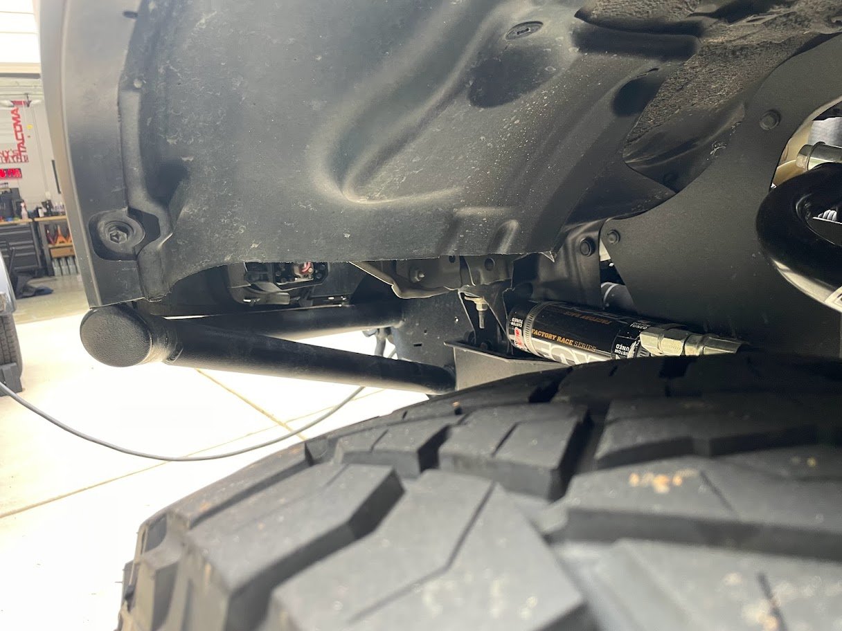

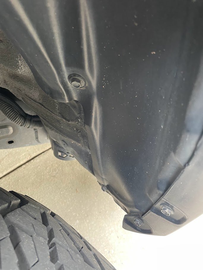

    First pic is the rear of the fender, DRT CMR is in there.

    For true 35's, you're going to have to take part of the fender flare or the tire will do it for you. How much is dependent upon offset, 0 offset might clear with my style of cut but it will be close - you'll definitely rub other places though, my 34's on 0 offset rubbed something inboard, I don't know if it was the control arms or the frame, I could never tell, only at full lock in reverse. I run them with a 3/4" spacer to technically like a -17 offset. If you have SPC arms you get a little extra clearance, maybe a 1/2". Could do the JD Fab lower pivot kit if you're absolutely against cutting.
    I'm getting ready to do a different bumper and the C4 fender liners as I need just a little more clearance on the fender flare. This will set me up for 35's too.
    You'll also need a bump stop spacer or that 35 is going to eat the inside of the fender.
