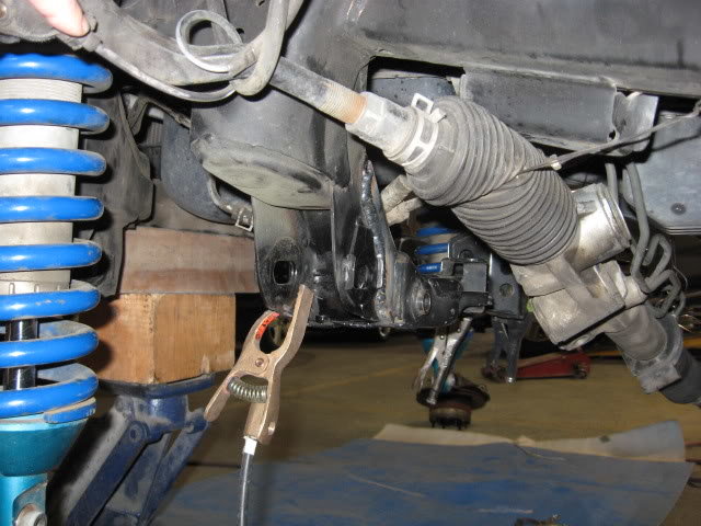

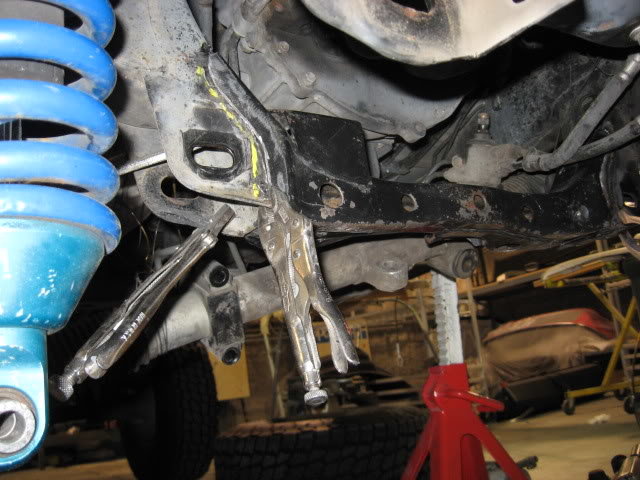

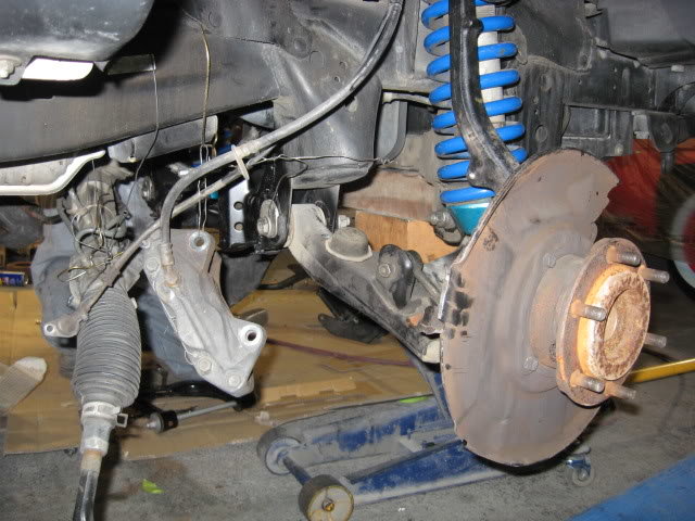

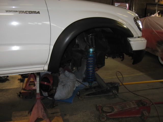

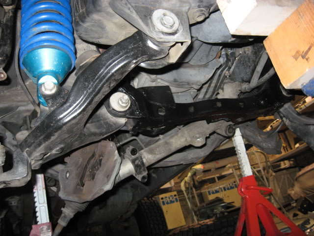

    As some of you may know, Im getting rid of the POS TM 6" drop bracket lift on my gen 1 (03 Pre Runner 2wd) 9 out of 10 people have told me "It cant be done" Well, it can. Work started yesterday:
    Parts:

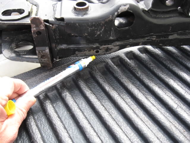

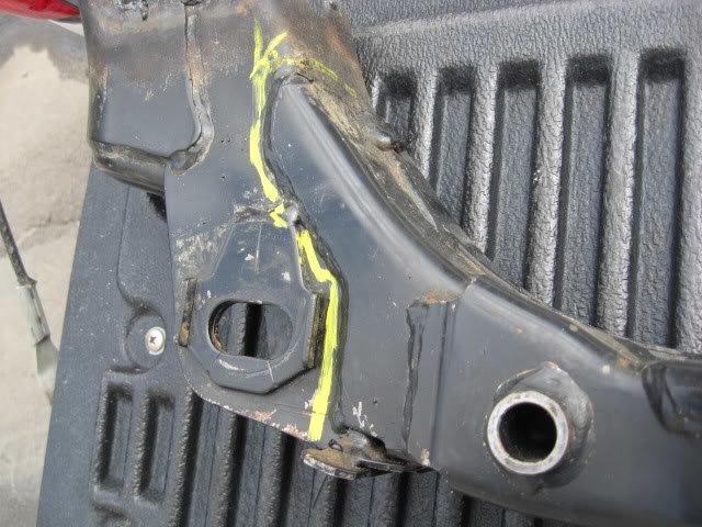

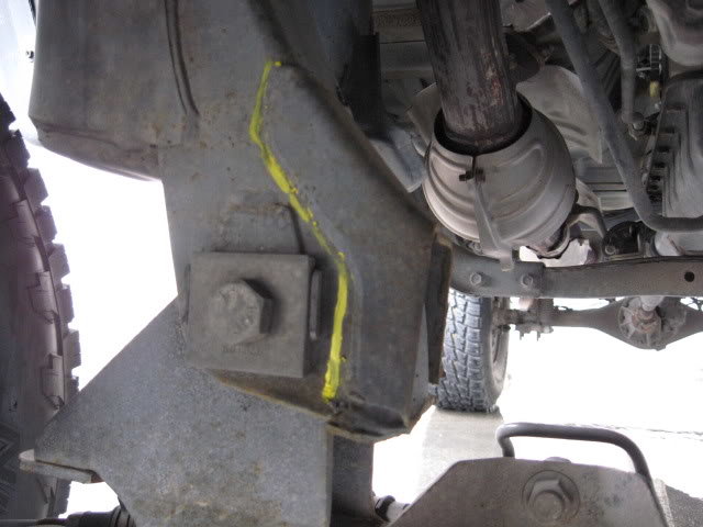

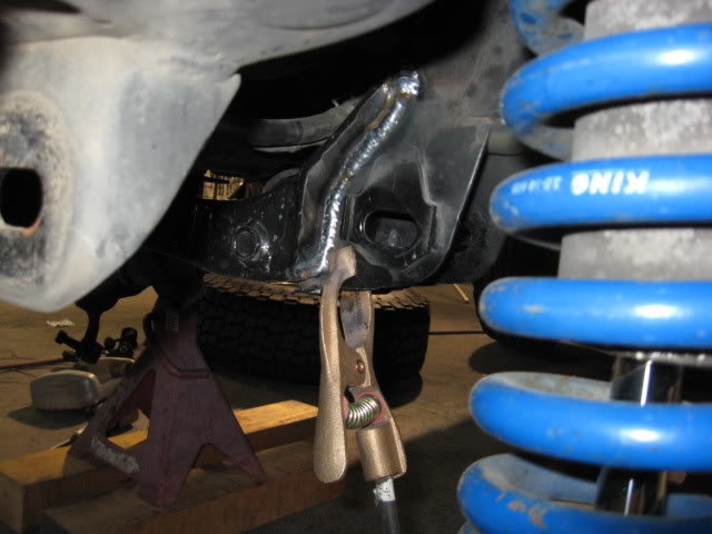

    The crossmember will be cut/trimmed here @ factory seam:
    The truck will be trimmed/prepped same spot:
    These are were measurements are taken w/tram gauge.
    More to come

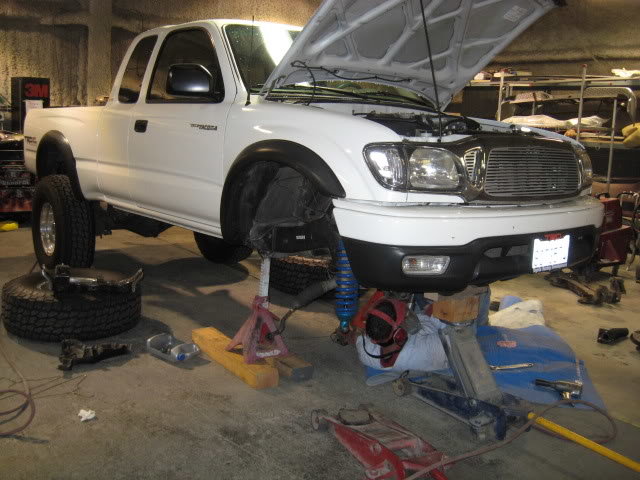

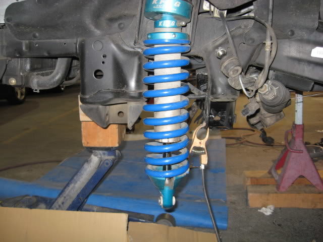

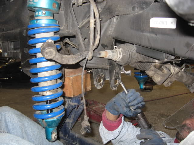

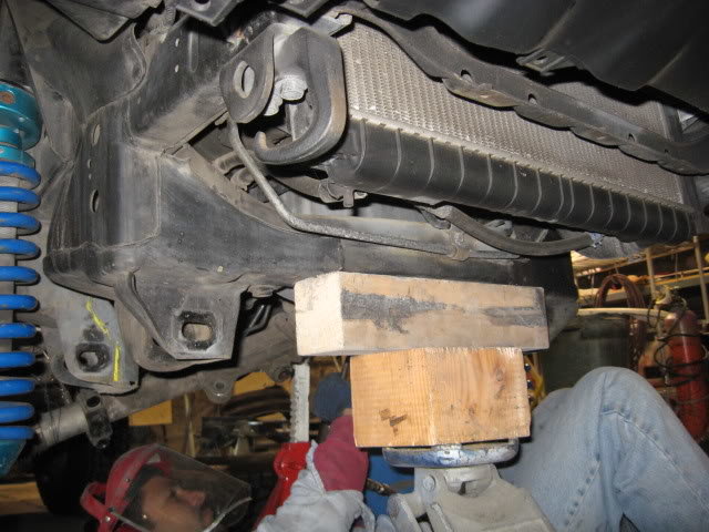

    Thursday 4/21/2010:
    The "fun" has begun:
    Prep/clean frame

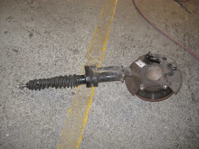

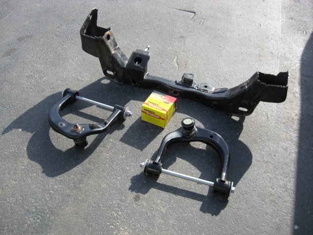

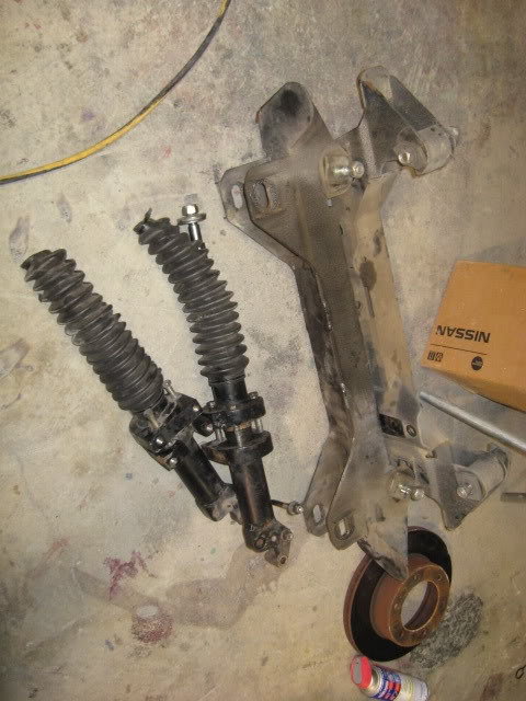

    Kit is gone

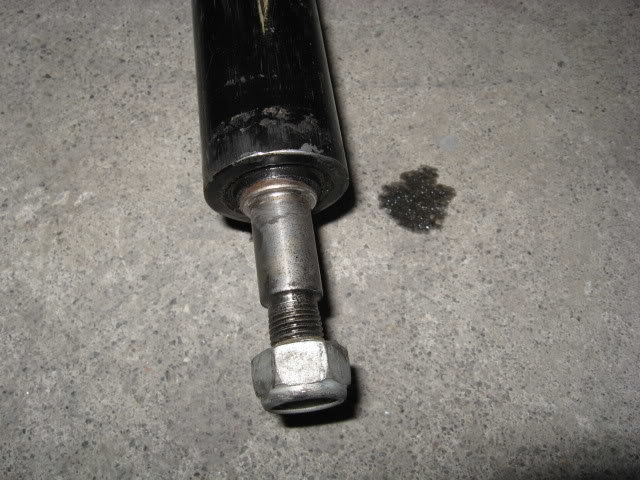

    POS TM struts BLOWN/leaking:
    as it was, and never will be again :)
    Its going quite well....
    http://img.photobucket.com/albums/v25/Guyster/crash2_10_2010027
    .jpg
    $hit Kit:
    Man, I "hope" its straight! lol :D :welder:

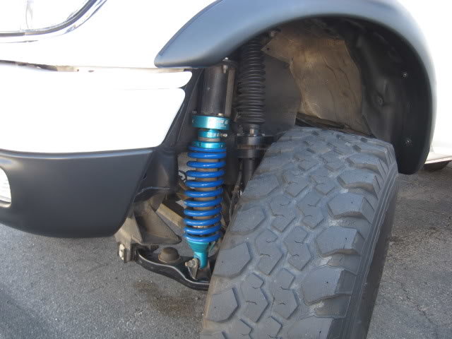

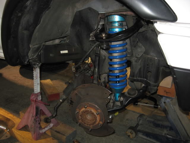

    3:00pm same day. Going back together....

    Thanks man. Im stoked to say the least. With good preparation, having all parts ready, we buttoned up the frt end in appx 3.5hrs!
    Im getting the 315's swapped for 285's today and finishing up rear susp (removing blocks/keeping AAL's). I'll post more pics soon
