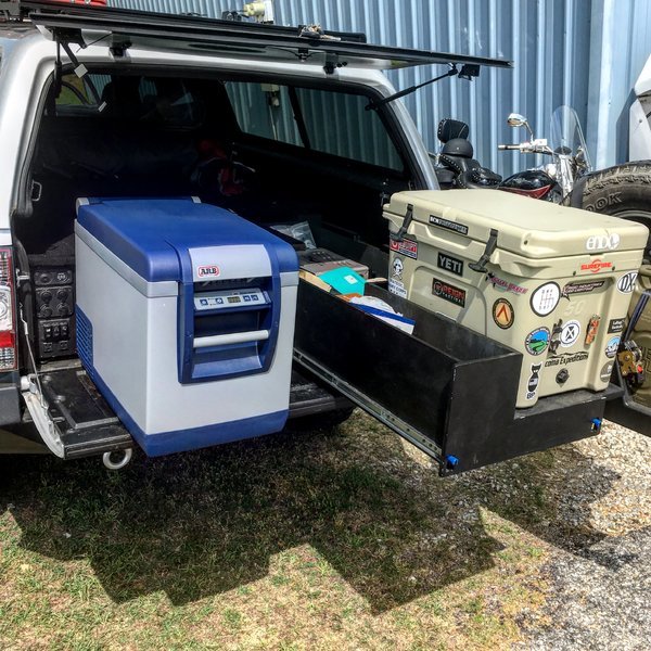

    Next I realized I needed to build some type of drawer system for the bed of my truck. I had been sleeping on my sofa cushions in the back and all of my stuff piled around me. Im an organization freak so that wouldnt do. I worked on a design and I ordered all of the material needed. I bought a queen size 4" memory foam mattress and cut it to fit.

    I wanted it to become a functional part of my truck so I decided to run power through it also.

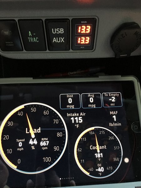

    Ive done quite a bit since my last update. I have added an UltraGauge that I use with my ipad. I will be fiberglassing the ipad into my dash in the near future.

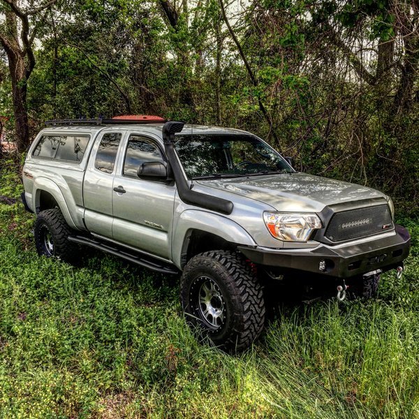

    I also got my Demello front bumper in and sprayed it. I installed Baja Designs Squadron Sport fogs and a Warn VR-10000-S winch.

    The next step was a bit difficult as I didnt really know what I needed to do. I have a 1" body lift so there was space between the top of the bumper and the bottom of the grill. I eventually decided to take my factory bumper and cut 2" off the top of it to use as a spacer.
    I also Plasti-Dipped my grill surround black while I was at it.
    My next step is the one I was most excited about but also most dreading. The snorkel. I searched high and low looking for one that I liked. I wanted the arb but I didnt like how big they are. I finally decided to go with a snorkel made for the hilux by a company in which I cant pronounce their name. It came with no instructions and the pattern was for the wrong snorkel. I made my own out of cardboard.

    I have also added an UltraGauge that I run on my ipad
    Today I also received my new ARB 50qt fridge/freezer. It will be replacing my Yeti 50. I am going to need to modify the drawer and box to make it fit but Im ok with that.

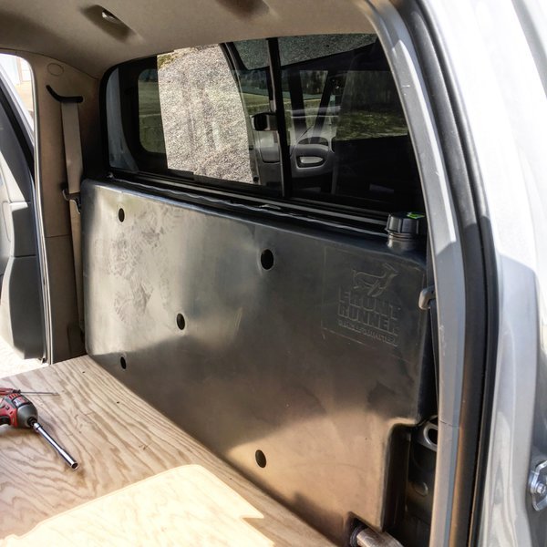

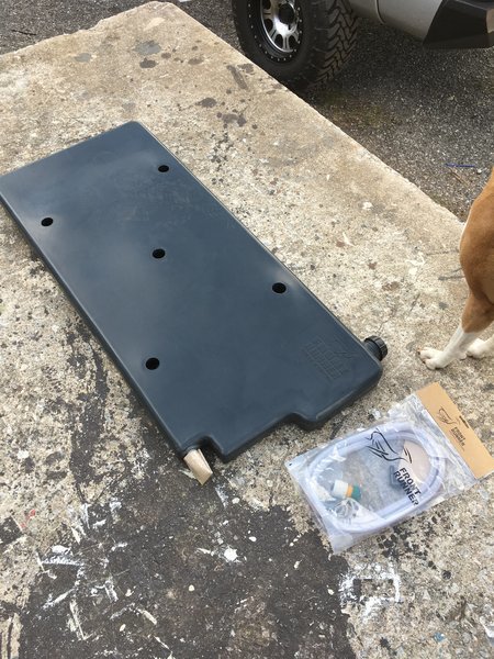

    Another project Im working on is adding the Front Runner 10gal Upright water container to my truck. I am building a box in the access cab portion of my truck and the water container will be built into it.
