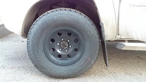

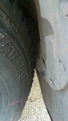

    You will have to loose front mudflaps, otherwise no issues. I have same size 265/75/16 all terrain tires and same specs 16x8, 4.5bs wheels. You may or may not have to bend the end piece of the fender flare inward.
    Before:
    No mud flaps:

    Thanks, thats good to know. I always wondered if I would be able to put mudflaps back on if I decide to go back to 265/70/16 next time around.
    So OP, with 16x8, 4.5bs 0 offset wheels & no lift:
    265/70/16 you are good!
    265/75/16 you will loose front flaps.
    I think sockmonkey has (or had) 265/70/16 tires with AR Mojave 16x8 wheels if you want even more pics.

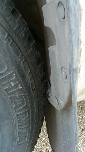

    More pics for you to see them at flex...while tucked in the wheel wells, the 75 series would rub the inner fender...where these do not..
