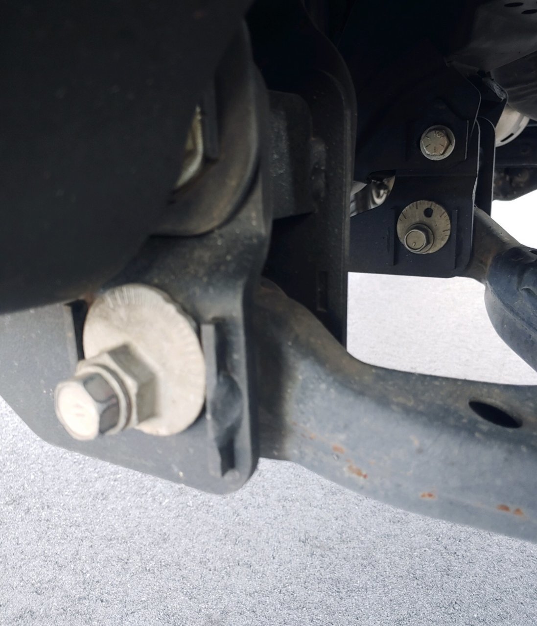

    Purchased a 2014 Tacoma for a great deal,2wd prerunner with a 6 inch lift. The truck has spindle lift with crossmember lowered. Crossmember has not been cut.
    I was wanting to do the rear first with all pro leafs or Dakar leafs. Truck currently has 4 inch block on it and rides like hell.
    Will the reAr be that much lower if I don’t do the front right away? I was thinking maybe 1-2 inches lower.
    my issue right now is finding stock spindles to lower front to 3in. New factory spindles are high. Was gonna do the boss coilovers in front once I find stock spindles or if worse comes to worse, I will just stick with the current spindles and upgrade suspension. Any advice would be great.

    why not just leave the spindles and drop in some quality shocks set at zero for the height on the coils? Spindles are 4" and keep the stock geometry and no preload necessary.

    It looks like you just have a regular rough country drop bracket lift, not a spindle lift.

    The spindles that are on there are definitely not stock. Much more beefier. I was hoping to just put a set of boss coilovers on there with the current setup. I like the 3 inch look much more than what’s on there.

    The kit does provide new spindles but I don't think they provide any lift at all. The roughcountry website doesn't mention it. I'm sure they would've mentioned it if it did. Looks like the lift is coming from the drop bracket as well as the coils.
    Some quick googling mentions that the existing crossbar has to be cut off. I wonder if that's only for 4x or also for 2x

    The crossmember has not been cut but with the spindles on there now I’m not sure I could remove the dropped crossmember on there and go to stock location. 2wd is weird because I’ve had nothing but 4wd in the past.

    You are also going to have to pull out the crossmember that lowers the LCAs before you can use a 3” lift coilover, unless you put a spacer on top of it (which would be silly).

    Drop bracket lifts come with new spindles but those are different from lift spindles.

    Post a pic of a knuckle near the lower ball joint.

    Get some maxtrac 4" spindles for the front and a new leafpack or aal for the rear.
