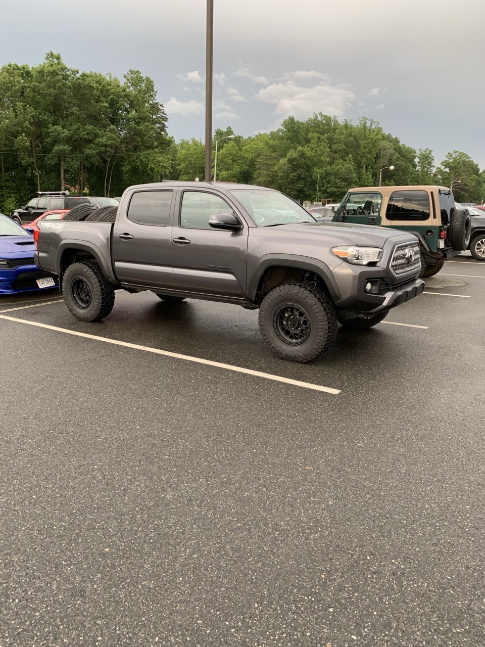

    Whats up everyone,
    I am currently running maxed out 5100 up front with a 2.5 inch block and 5100 in the rear. The ride quality is ok on road but I have noticed pretty rough offroad. I am experiencing some wander and bump steer at speeds over about 50 so I think I'm gonna get putting on the JBA UCA. While doing that I figured I should put on aftermarket OME springs and I've also considered either and AAL or leaf pack in the rear. I want to do some more offroading and the current set up makes me a little nervous. Do yall know what coils I can switch the front with and what leaf set up for the rear to achieve the same height I'm currently running?
    Pic of truck currently

    From everything I've been reading, get the OME 887 or 888 and let the coils give you the lift, and bring the 5100's back down to the lowest setting. For leafs in the back, anything from the Deaver 1.5"-2" AAL would work fine or go for a new Dakar leaf pack if you got the money.
    I'm going to get the 888's, 5100's, and the Deaver AAL, @HeadStrong Off-Road has all the goodies.
