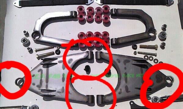

    :confused: The upper arm?
    Could you throw a red circle around where you're taking about the wrap around? Sorry I'm a welding noob. I think I see what you're talking about but I'm not 100% sure.

    Not on my phone, sorry, I'm at work. So where the bushings are on the LCAS and UCAs. The red pieces. Those tubes that the bushings themselves go into....the LCA top metal piece and bottom metal piece should extend up and around the bushing tube for more strength. The cheapo garage fab kits never do that and many people have had welds crack at that point or even completely fail

    Where the bushing sleeve is welded to the lca

    Where the empty circles / rubes are, right? You're saying the fab work should encompass that*

    There should be a plate wrapping the sleeve...look at camburgs

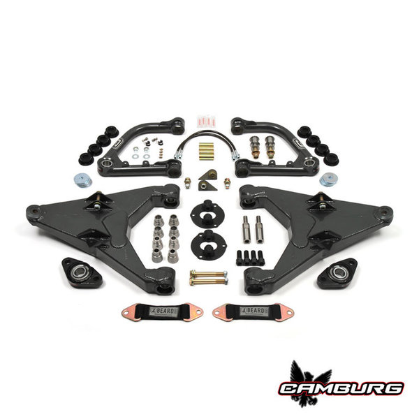

    Here's the kit I'll be putting on my truck someday soon (sitting in my garage), notice how the bushing sleeves have gussets welded connecting the sleeves and the LCA together and the UCA uniball cups have gusseting.

    Thanks, that's what I thought but I just wanted to be sure.

    :facepalm:gusseting is the extra tabs of metal over the joints, right? The only welding I've ever done has been under a microscope.

    Looks like it. I used to hang out at his house while waiting for work to get done, his welding is crap, watching him make his kits makes my brain hurt. His internal gusseting consists of grabbing random pieces of metal and welding them at whatever angle they will fit.

    Yes, gusseting is basically welding extra metal onto joints to strengthen
