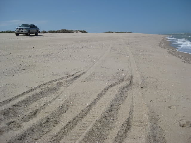

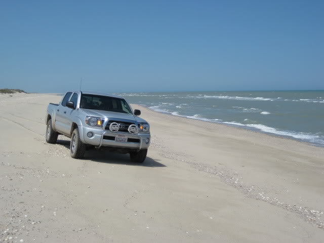

    All sand is not the same... You can try driving fully inflated until (if) you bog down... THEN you can deflate your tires... Have a good (dial) tire air gauge that reads low pressure, and a air pump to refill when you come off the sand. 15 PSI will turn your truck into a dune buggy in most sand. Yes, H4 (4WD High range) and leave the TRAC on (normal driving)... Do not touch the VSC OFF button... unless you want to see if turning off the LSD will get you stuck (holding in the button while stopped until the VSC OFF light comes on).
    The stock tires will do better in the sand than off road or mud tires... Less tread is best in sand. You want to 'float' on sand not dig into it! See my posts on beach driving in Baja. I show a photo of the difference between what the tires at 32 PSI and 15 PSI looks like in the sand...
    Before and after deflating... I was heavily loaded for camping (2 ice chests, water, etc.) and the truck was somewhat sideways on the steep beach... As soon as I dropped the pressure to 15 PSI it floated and stayed in line... I circled back to take these photos.
