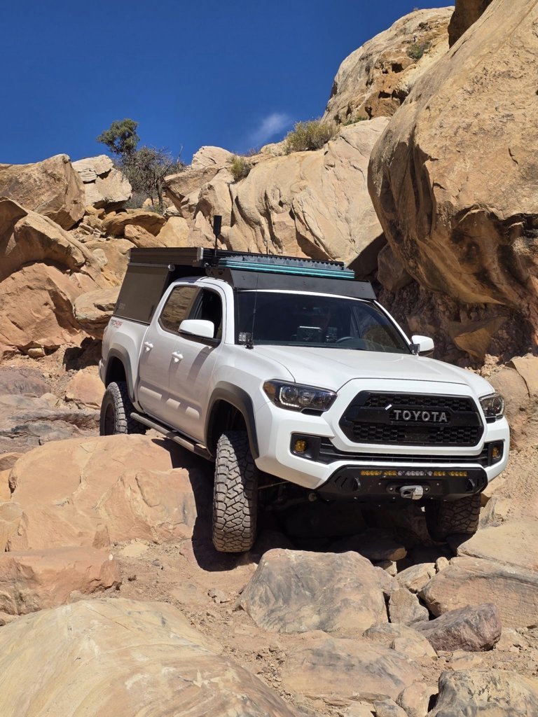

    I have a camper(~500lbs with buildout) plus skids. I have a eibach lift kit and 2” deavers leafs. It’s been fine, will most likely upgrade front brakes at some point.

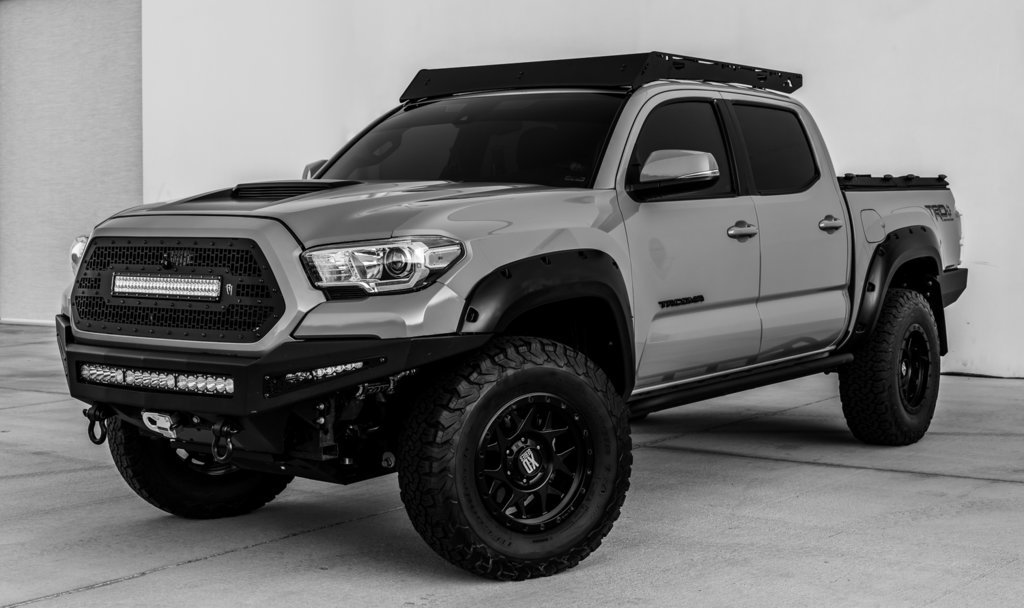

    You can go with a big brake kit up front, spindle gussets, lower control arm tab gussets, coil tower gussets, wider rims, E rated tires, aftermarket bump stops, and, of course, hammer hangers.
    The Dobinson stage 1 leafs (remove one leaf) should be fine. Especially, if you have airbags (with cradles). 4:88-5:29 gears will help put the power in the sweet spot and physically lower the gear ratio, but airbags will make the most difference to keep the load from bouncing off the axle.
    Reduce your speed, break early, and expect your vehicle to handle a lot different because of the load. :thumbsup:

    Sweet truck! I definitely will end up a little lighter than you after all is said and done and I am on 5.29 gears. I think I may lose the t-case skid to save 30lbs and not do a exhauast reroute. It was more "whoopsie" protection. I am not crawling rocks.
    That is a lot of gussets! I have the spindles done. Getting the hangers with crossbar. Got the 5.29. Probably going to try and shed a little weight first before welding more gussets on.
