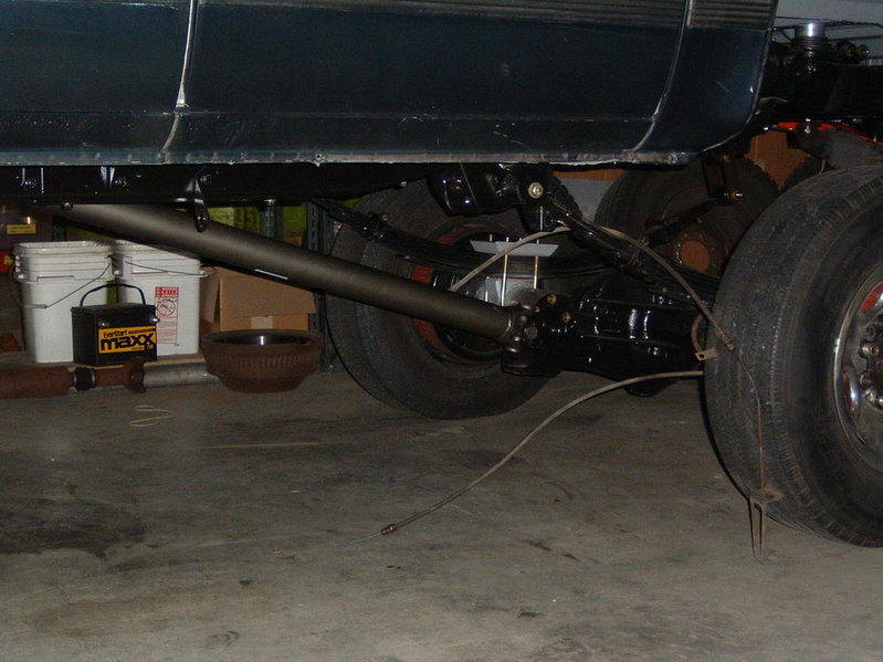

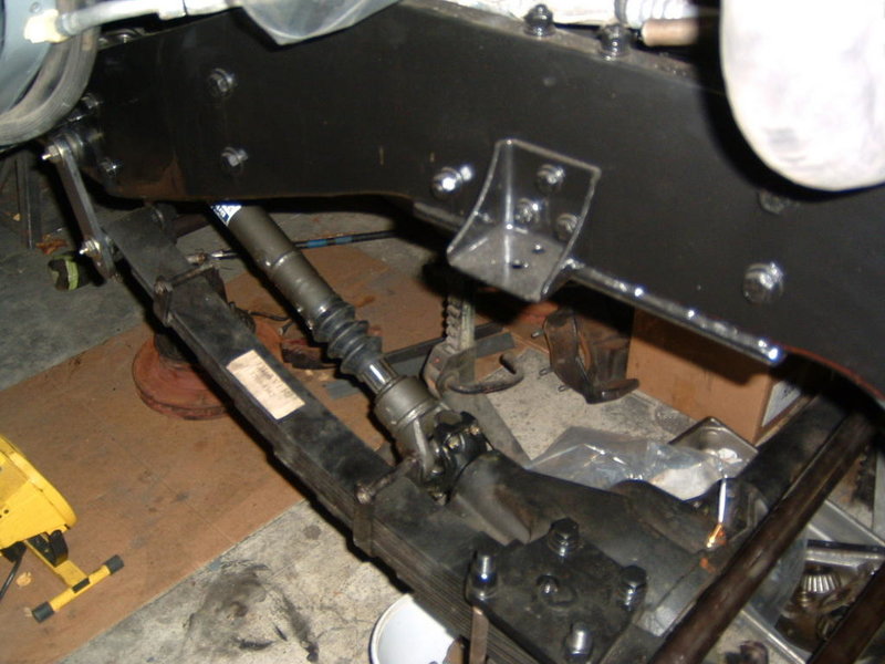

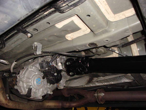

    I have one word to say guys....boooyahhhh!!! Smooth as glass now, from the first drive away from the shop all the way to my house I can actually fully enjoy my Tacoma now.
    I had a Double Cardan drive shaft installed that has one zerk fitting in the middle (needs lubricating maybe twice a year). I forgot to ask if any axel shims were used, but I'll check tomorrow.
    All of you who are looking to completely rid your truck of driveline vibes/shuddering this is the ticket. You can expect to spend between $400-$500 for the new shaft; I believe its worth every penny.
    For any of you in the Portland Metro area, go to Six States off of Columbia Blvd. Ask for Ken, he's the best and probably one of the nicest guys I've ever met.
