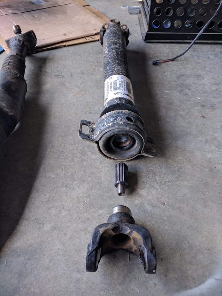

    OK. I have finally gotten around to GoPro-ing my new single piece drive line. So here we go:
    Side view of the new one piece shaft and a display of where the old carrier bearing used to be

    After driving my Taco for a few weeks with the new one piece drive line I can say that I am very happy with the results. Power is smoothly transferred from the TC down the line back to the differential. The hopping and slapping of the old carrier bearing is a thing of the past. Why Toyota went two-piece is kinda beyond me. It seems that it would be less expensive from a manufacturers perspective to eliminate a center bearing.
    But anyway, I am totally happy with the 450USD that I shelled out for this custom shaft. My Taco is now drivable again.
