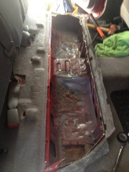

    So it worked! took me about 8 hours but its almost done. Just have to wire in the amp tomorrow and do some final touches.
    I ended up cutting the small wall on the rear of the storage area out and pounding the floor down about an inch and put dynomat everywhere. Took it by the install bay and the guy said it will do just fine. I am going to keep it sealed though.

    Ahhhhhh, see? I knew it! That's really the only way to do it. You need the front wall because the seats bolt to it. I'd thought about doing the rear wall that way but decided I was fine with 8's.

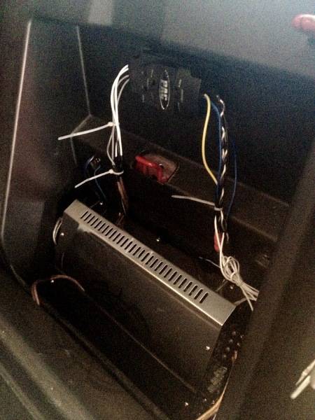

    I still have to touch up around the edge, I am going to cut that piece of dynomat/carpet back and use a black plastic L piece as a border.
    Final outcome was great, sounds very clean and hits really hard.
    Here are some pictures, (sorry quite a few got deleted)
    Please excuse my non existent attempt at hiding wires, i never look behind the seat anyways so I didn't stress about it.
    Thanks!

    Nothing but red x's

    Oops, tried to copy paste off email.

    The rear of the bin doesn't really even look that modified. It looks basically the same. I'd have liked to see a before/after pic of it just for reference (it's been a long time since I've seen a stock one).
    I'm guessing you barely clear the bottoms of the seats? I'd counter sinked mine and it was still a little close with the 6.5's
