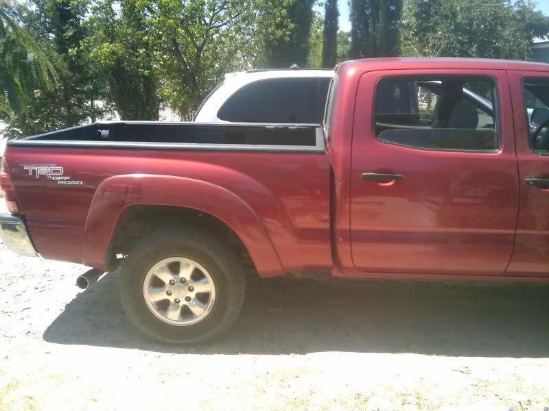

    Ok more or less have an idea of what i wanna get. Bilsteins all around, and rear AAL. The only thing is, is my truck broken???? i looked at the leafs today and it looks like one is missing, and the bed looks like its sagging from the back thus making it look like the bottom of the rear fender is pointed up. What gives???? Any insight is greatly appreciated.
    From the back of the truck
    Front of it
    Side pic. Look how the bed looks like its pointing up
    What do you guys think?

    It comes stock with a 3 leaf pack, there is a TSB for the rear suspension but i don't know much more than that, search for "tsb story" and that should help you find more information.

    Yea after further reading i found out its stock with 3 leafsprings. anyone know if its possible at all to get the 4th by itsself?

    if you had the warranty and under the mileage you could get the TSB done and that would replace your factory leafs with a new 4 leaf pack. Or you can just AAL, that would give you the 4th one..
    And every truck I have ever seen sits higher in the back than the front. well stock trucks. Thats to accommodate for weight in the bed.

    I'm pretty sure you are out of warranty and I don't tihnk you can just get the extra leaf from Toyota. You can get an aftermarket AAL or an aftermarket full leaf pack (Deaver, Dakar, etc) that will help you with the lift and fixing the tilt you see/feel.
