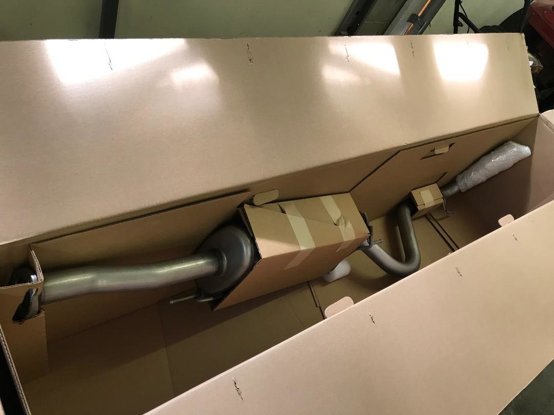

    They do a nice job of boxing/packing the unit, I wasn't expecting that. When I owned my auto parts stores, exhaust parts came loose/un-packaged. I guess for what they charge they can afford the box.

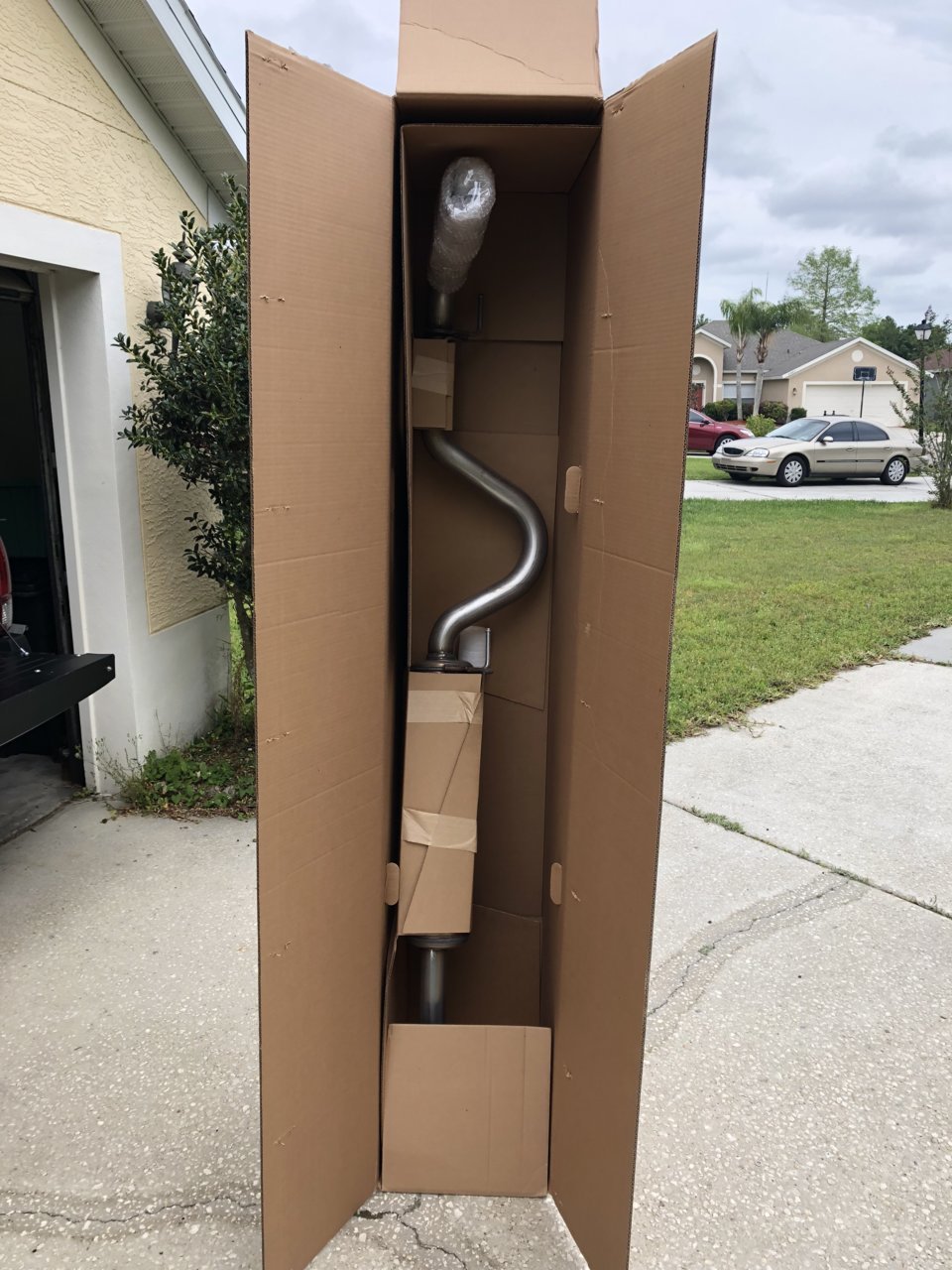

    Fun fact! You can stand them up too!
    I didn’t remove my spare, it’s doable.
