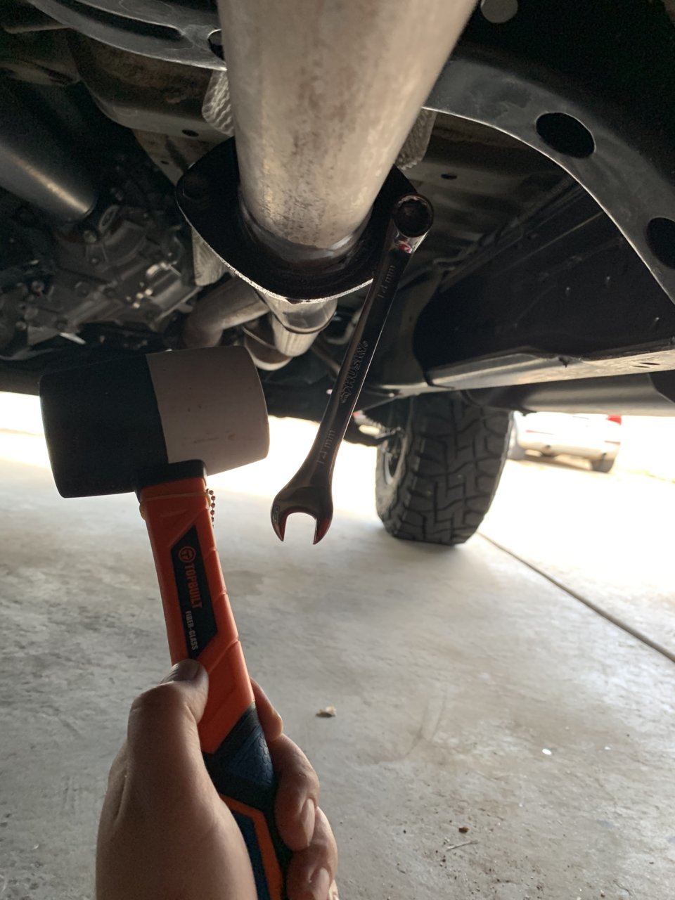

    Just finished it up and it was kind of a bi*** with one person but definitely doable. I used a combo of needle nose pliers, regular pliers, and a ton of wd40 to get the mounted points off the hangers which was the hardest part of removing the old exhaust. I noticed my old exhaust had a giant crack in the side, it really looks like a piece of crap compared to the pro one. It was also way bulkier.

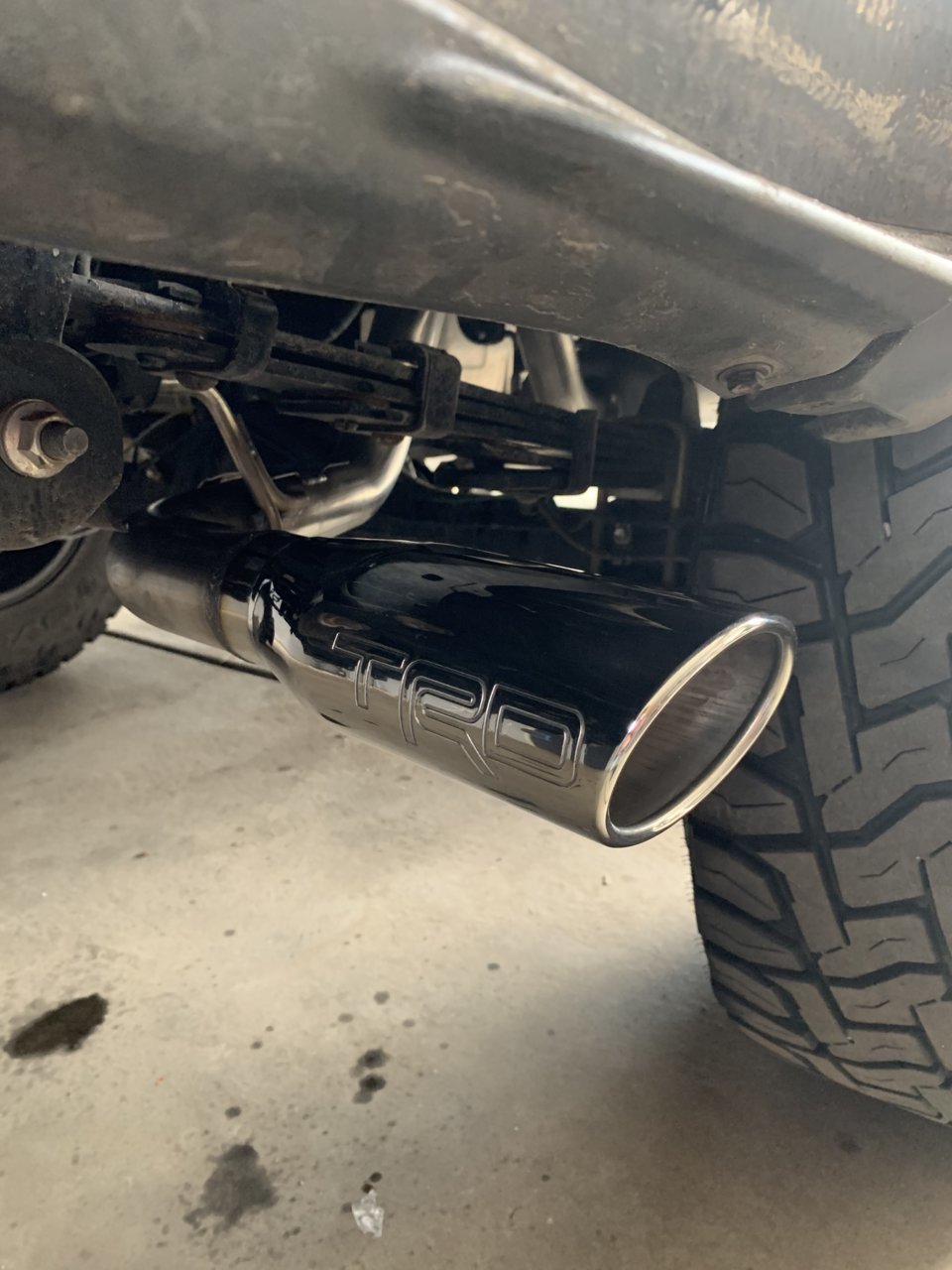

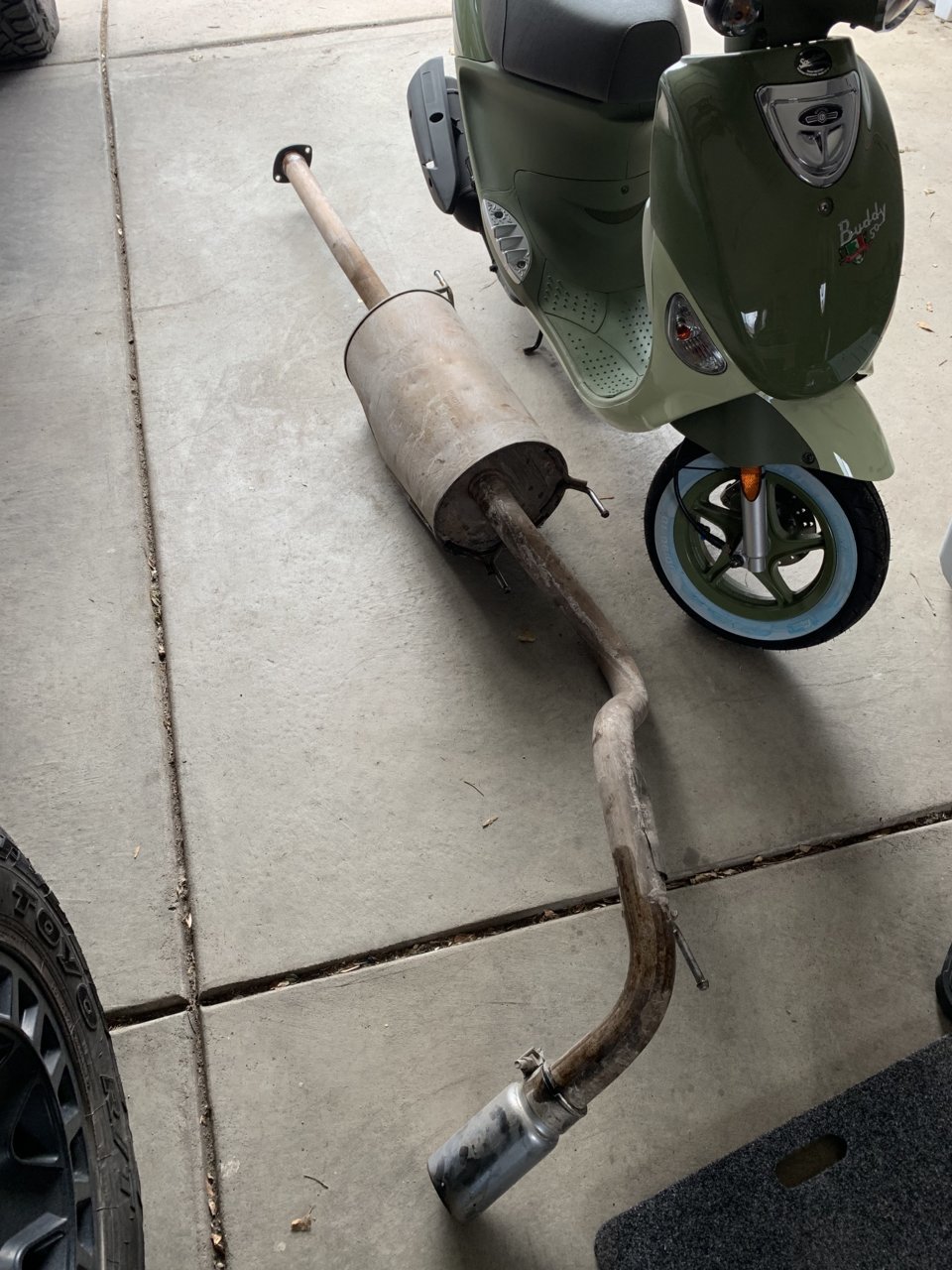

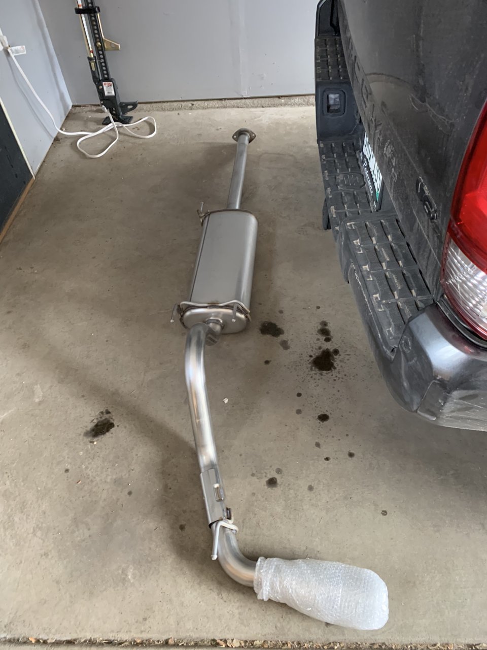

    I installed my TRD CatBack exhaust and am quite pleased with it. Looks good and has a nice deep tone without being too loud.
    Took me right at an hour doing the job alone. I could probably do it in 30-40 minutes if doing another.
    Kind of surprised me in that removing the flange bolts and removing old and installing the new system over the axle was quite easy. Most difficult task was dealing with the rubber hangers even using WD40 then dishwashing liquid.
    Note: the new TRD system is quite a bit heavier than standard OEM system.
    Some Tricks for Easier Installation:
    • Wrap existing exhaust tip to insure it doesn’t damage body when removing.
    • Leave the bubble wrap on new exhaust tip until install is complete.
    • Drape a towel or bubble wrap over the axle to protect your brake lines vinyl line as you will be hitting pipes against them if you doing install alone.
    • I didn't need to jack truck up or drop spare tire down.
    • Use a jack stand for support after you remove from front flange.
    • When removing old system It’s MUCH easier to leave rubber hangers on old system and disconnect from body hanging points then transfer hangers to new system prior to install.
    The finished product:
