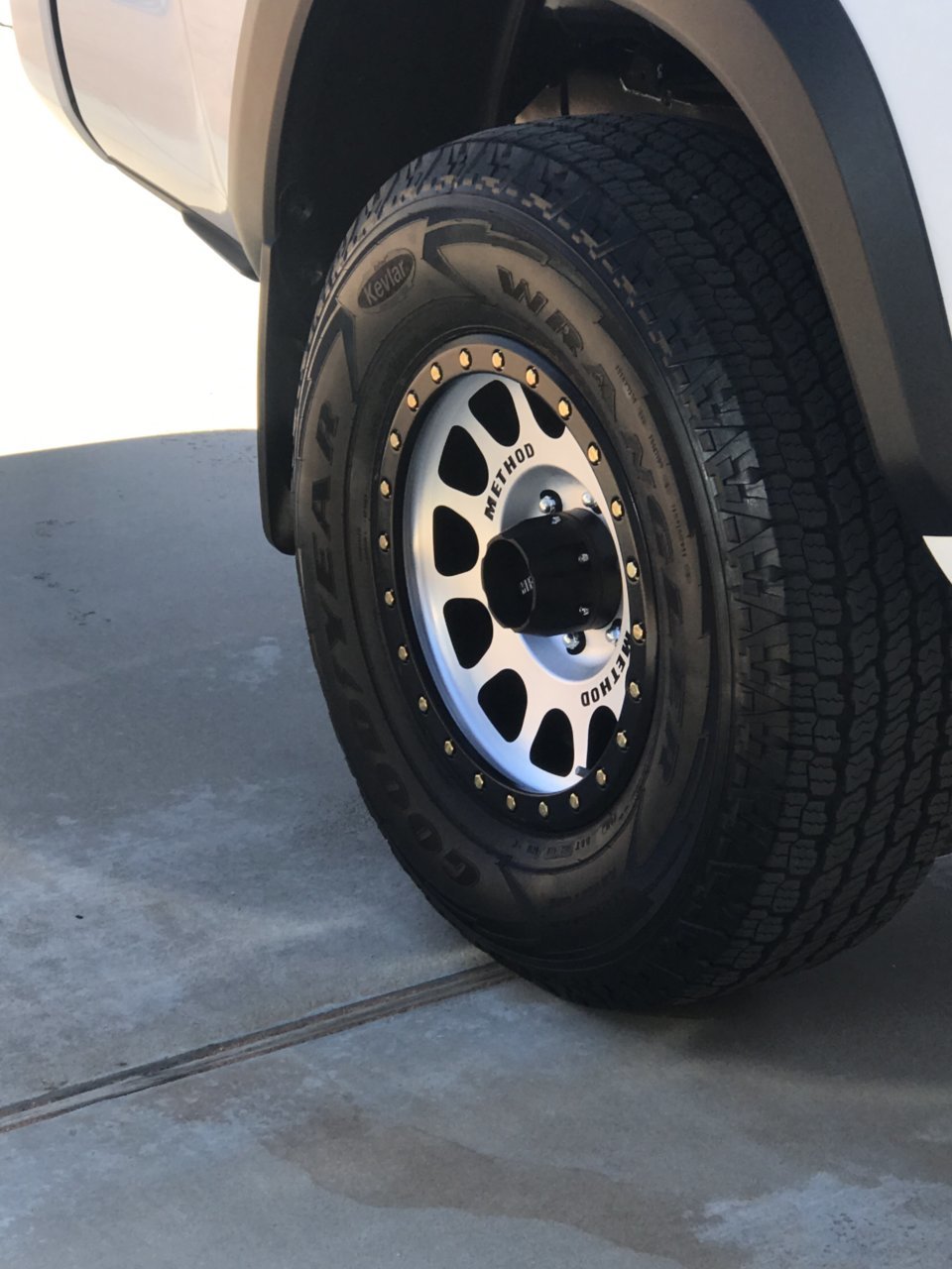

    yes, you need splined lug nuts. I had Discount Tire mount my Methods and they also had the lug nuts with the special driver included. No issue.IMG_7001.jpg
