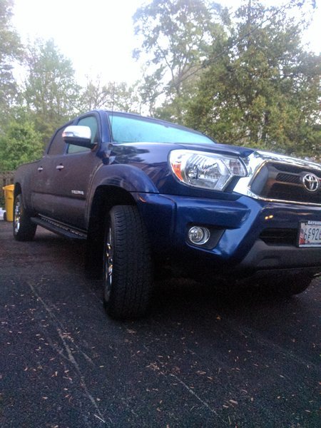

    I didn't go look at it. I didn't want to have to put it through Maryland inspection myself. I did that before and got burned. So I went with this 2015 instead.
