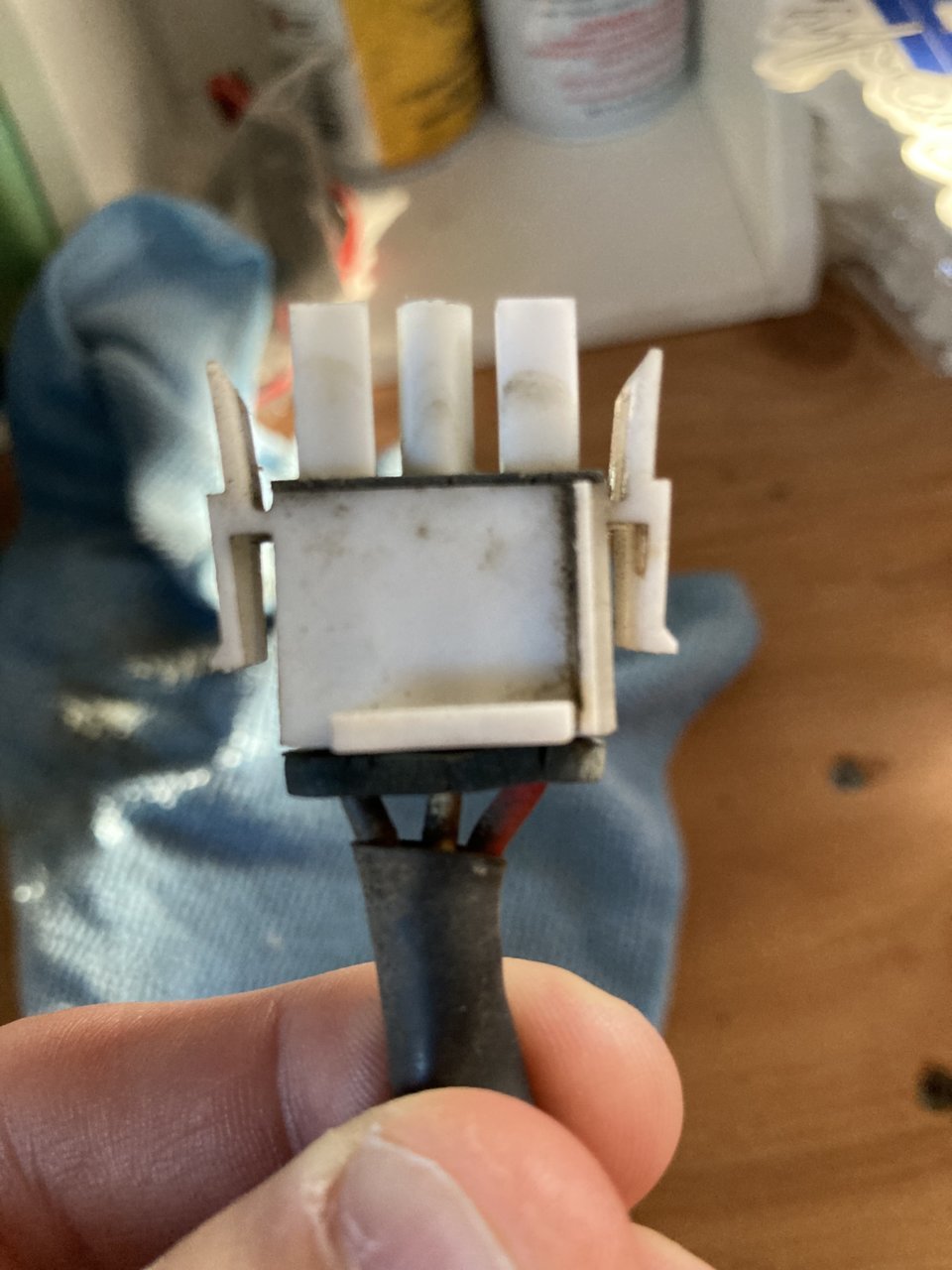

    So here is the original connector, wires go black/white/red into the connector.
    Here's just a top down view of the old connector showing the orientation of the openings. Same wire layout black/white/red.

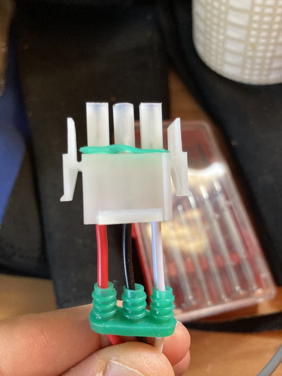

    Here is the new headlight connector. If I orient the connector in the same way as the original shown above, the wire layout is red/black/white (as opposed to black/white/red) as you can see from the picture below.
    The headlights don't work if I just plug them in as-is. My question is, can I just de-pin the new connector and swap the wires so they match what the original headlight configuration was (black/white/red)? I'm no good at electrical work so I apologize if this is an idiotic question.

    Yeah that might work.

    Sounds like that would fly, yup.
    My suggestion is use heat shrink tubing on any splicing if you happen to splice. That will keep water out.

    I bought a little de-pinning kit from Amazon that should arrive tonight so i'll try to see if this idea works.

    Sweet, perfect world that's the best way to go as you won't have to splice.

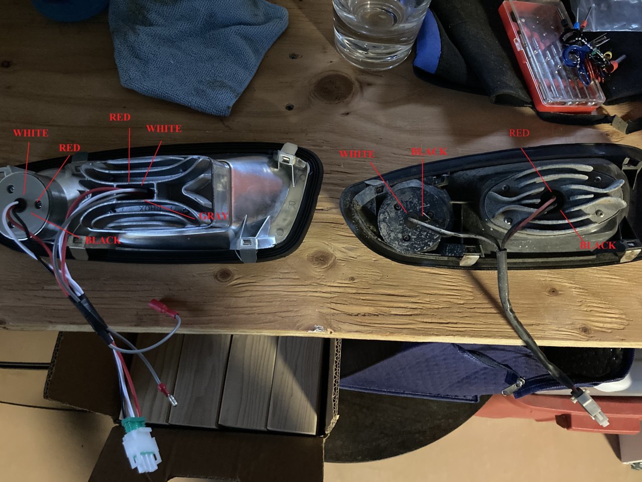

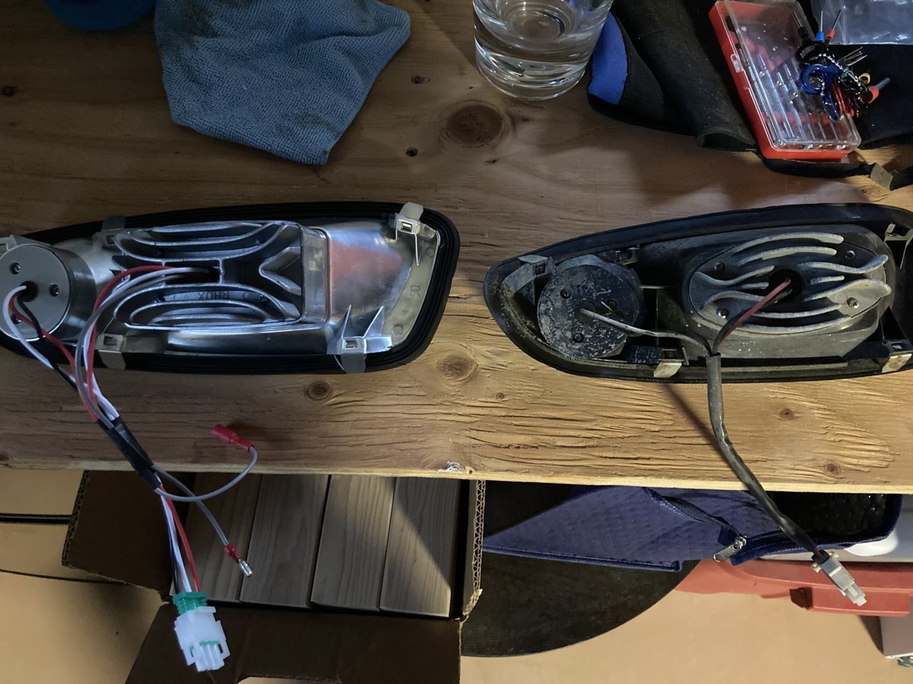

    Damn, that didn't work. Here is the back of the old/new headlights. The new headlights have two extra grey wires sticking out but I watched some YouTube video where the guy was like ya don't worry about those just leave them unplugged.
    Any ideas? I did notice that on the back of the old headlight the main headlight has a black and red wire coming out whereas the new headlight has a white and red wire coming out. And the little side lights (circular) have different wires coming out. I have a feeling the white and black wires on the new headlights aren't matching what the old headlights are doing. May need to unravel the tape and see all the connections.

    Did the new headlight assembly come with a wiring diagram? I'm curious about that female ended grey wire...almost looks like it's spliced in somewhere under the electrical tape. Is the grey taking the place of the black for the main headlight and spliced in with the black of the marker? Don't even know if that would work.
    I really have no clue though. Never owned a golf cart, let alone fooled with the wiring on one.

    No wiring diagram provided. You are correct about the gray wire. There is only one gray wire coming out of the main light panel but then its split into a male and female end under the tape somewhere. I did email the store I purchased them from. Of course I missed the *fine print* that says an additional wiring harness or harness adapter may be required with purchase of headlights. So i'm just asking them if I need the whole harness or just the adapter.
