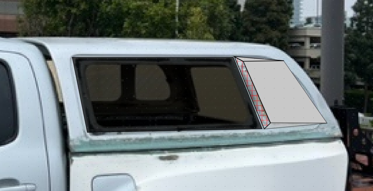

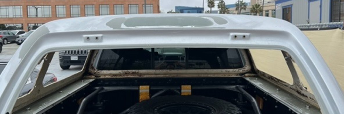

    Well...finally back to work on my on truck. I need to finish up the camper shell project I started last year, this is all just tacked together and roughed in so don't judge the body work yet...it will end up looking as good as the fenders on the 81' :thumbsup:
    Shaved the 3rd brake light because it always leaked and I have a Baja Designs RTL that will be on the back of the roof rack on the shell. ( all of the brown stuff on the inside of the shell is just the old carpet glue ) I removed the fold down front window of the shell because it weighs a ton and was pretty worn out, planning on cutting the front window opening to match the cab window and then run a compression boot :

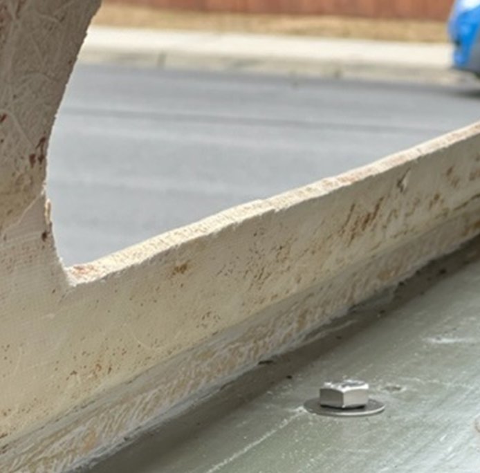

    I wanted to eliminate the crappy clamps that most shells use that hook into the OE accessory bed rails. I don't use those rails at all so I have removed them and the shell now through bolts with 1/2" stainless hardware :
    If you've been following along you may remember the gusseted bed rail supports that JD Fab made for me, the 1/2" stainless bolts go through the shell, bedsides and the gussets ( ignore the strut nut that's just temp )
    The new base of the shell has been rough trimmed to match the curve of the top of the +6 Fiberwerx bedsides. There will be 4-6 layers of cloth laid up on the inside and outside of the shell to bond it to the base plate it's just tacked on with some short strand filler right now. Fiberglass cloth does not like tight corners so a small radius of short strand will be on the outside and inside before the cloth is laid up. After that I will use short strand filler to carve out a nice shape to blend the new base into the shell :

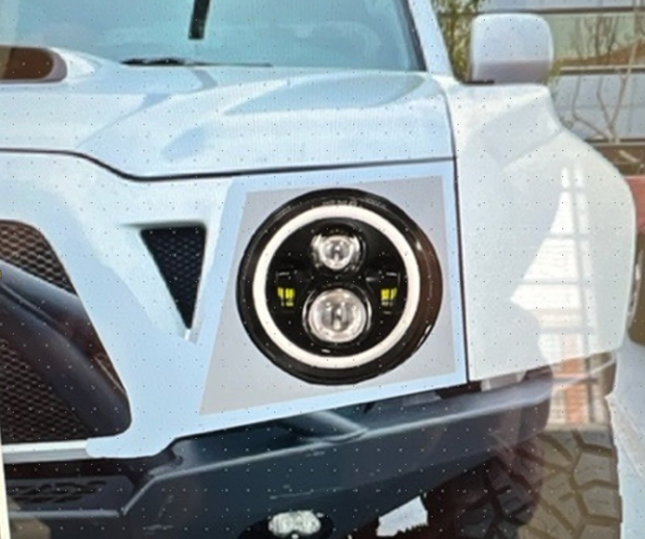

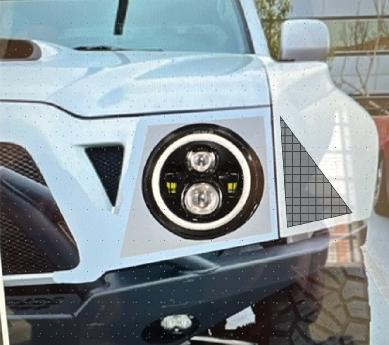

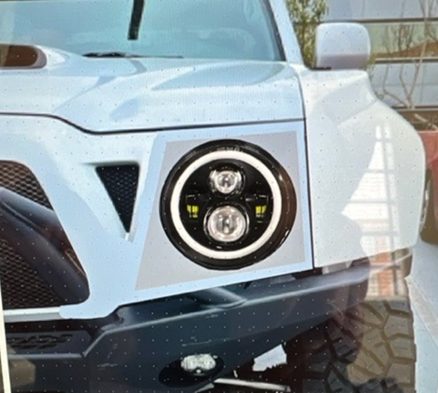

    and...I have always hated the headlights on this truck and how the glass fenders distort to accommodate the oe headlights, how weak they mount / easily break & the expense of retro fits for decent light output. So thoughts are :
    1. The weird fit is caused by the " bubble " shape and how the oe headlights wrap around the corner...how to get rid of that ?
    2. Weak = oe plastic mounting tabs... need something that mounts with metal
    3. Crappy light output...need something with more options
    So here is my idea :
    Use a 7" round headlight - tons of options, metal old school mounts easily adjustable & strong, much better light output. Pop a mold off the grill and headlight and make the grill all one piece & form a recessed pocket for the 7" light at the same depth as the other grill recesses. Last but not least reshape the front corner of the fender to match the new grill grill shape.

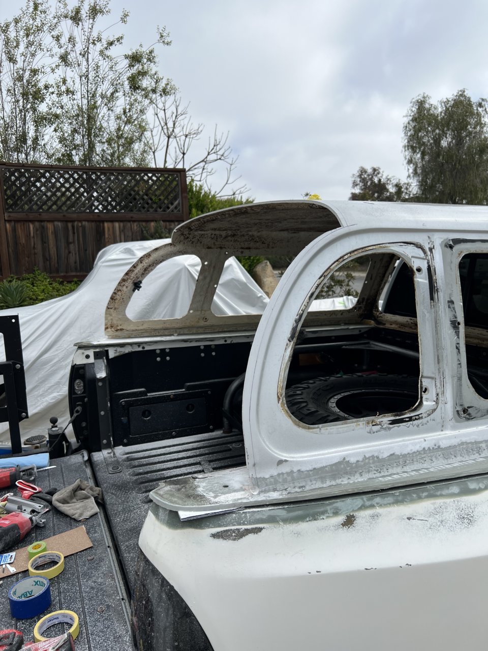

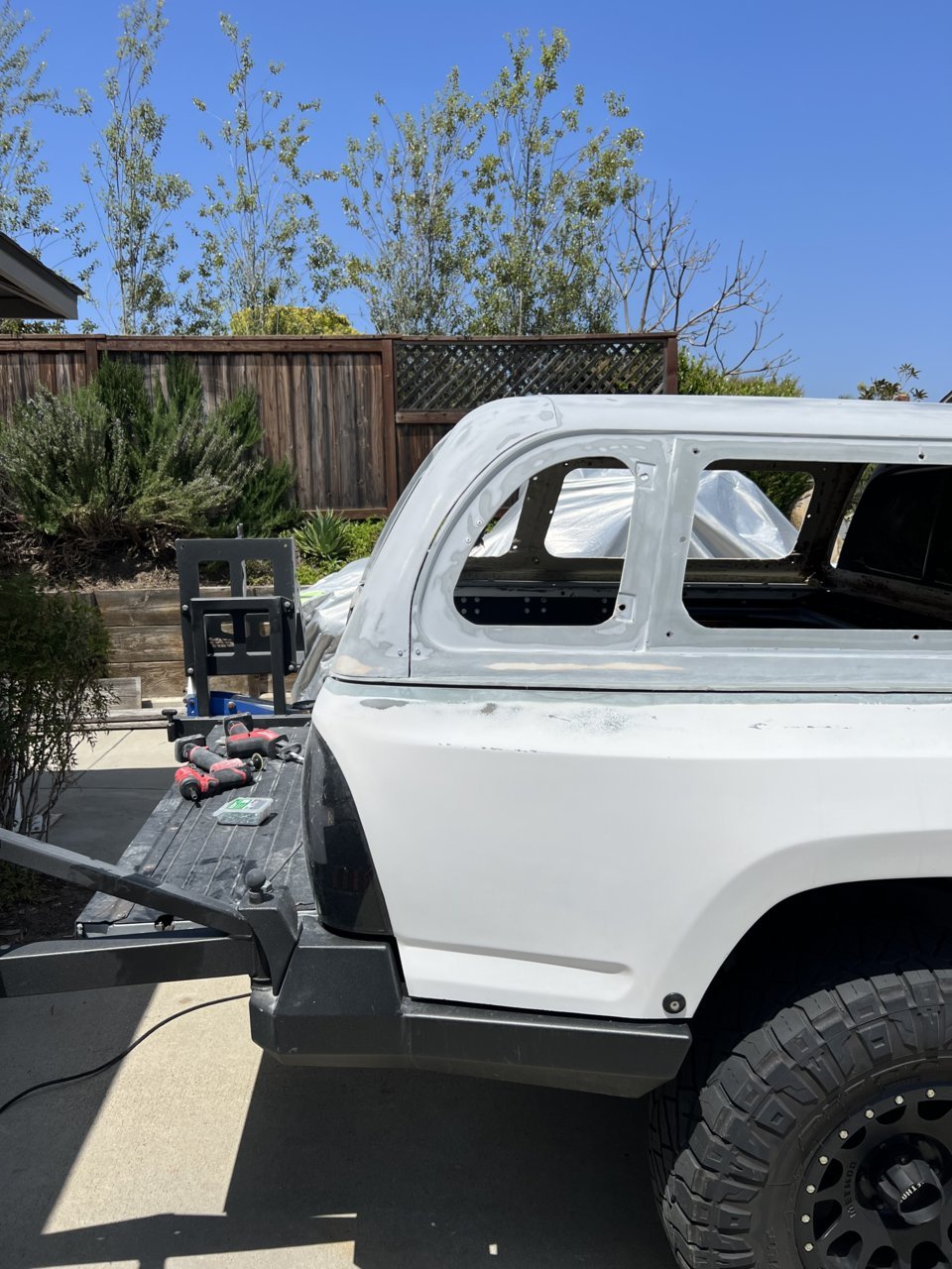

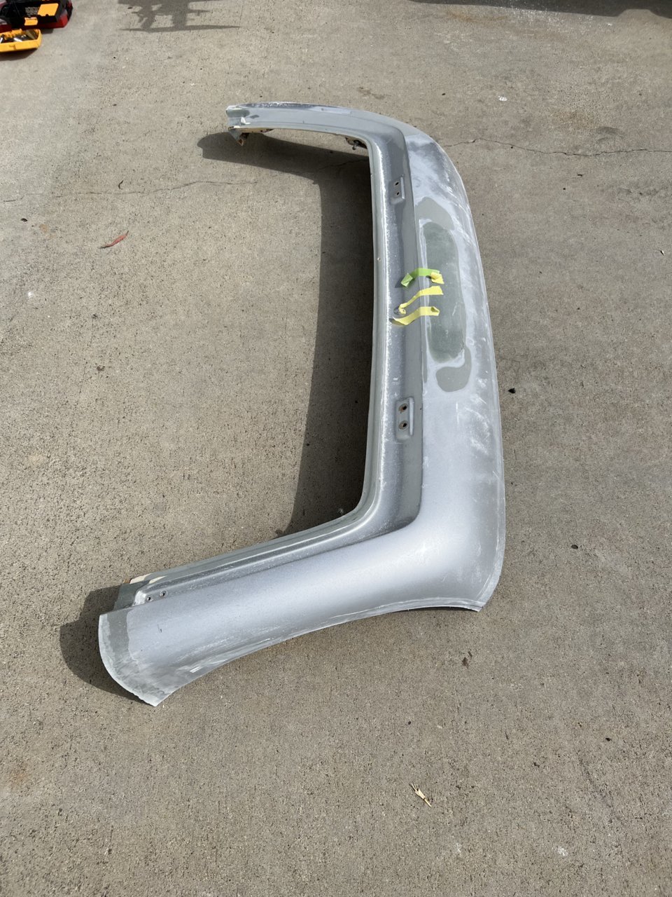

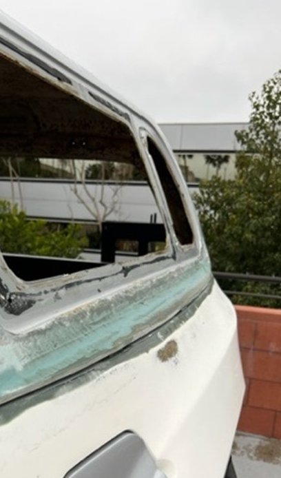

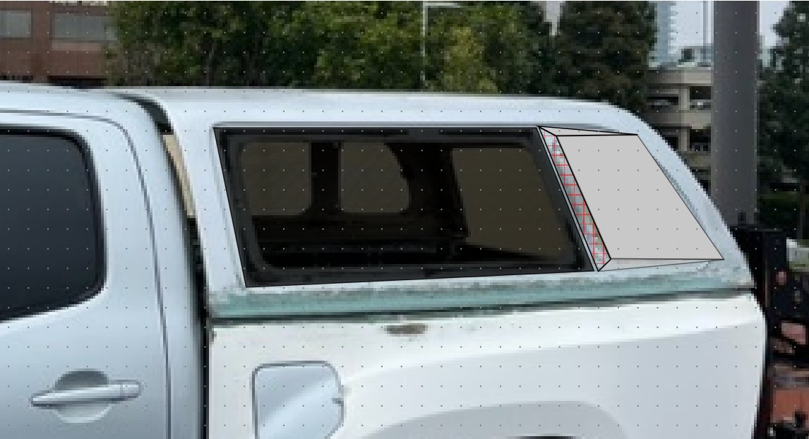

    Made some progress on the shell, today was all about fitment.
    The shell was about 1/4”” too long on one side and 1/2” too long on the other…yeah no sh*t the shell was not square. With the front corners lined up the back corners over hung by those amounts. Part of it was expected because the shell has those overlapping bottom edges to fit the oe bedsides so with those cut off I expected it to be too long but the uneven part was a shocker.
    I measured everything and found that the uneven portion was between the back of the rear side window and the back corner. So, this made sectioning the back of the shell to shorten a little tricky because it had to be trimmed 1/4” on one side and 1/2” on the other with a V across the top.
    Once it was cut I tacked it back together with some temp hardware because there is a lot more prep to do before glassing it. DA’d the whole shell and removed all of the old window urethane.
    Next i will have to grind all of the edges of the cuts on the exterior to make a long V bevel groove for the cloth to sit in and grind the inside along the cut to prep it for cloth as well. The inside will get multiple layers of 6oz cloth to ensure it is sturdy.

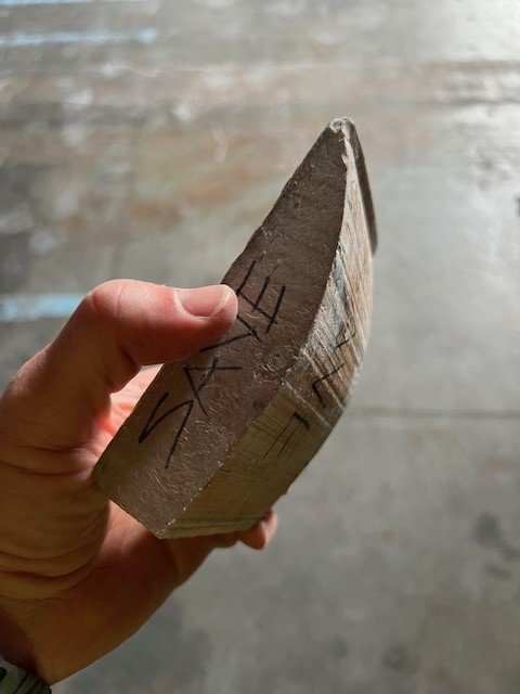

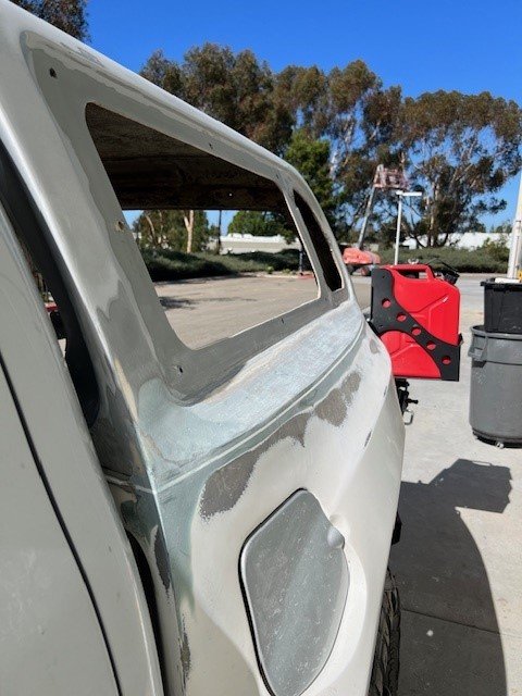

    Slow but steady progress on the shell.
    The outside edge of the shell is bonded to the 1/4" fiberglass board with small 1/2" radius of short strand filler and now 12 layers of heavy woven cloth, the idea was to build it as thick as the wall of the shell. The inside will have the same, seems like overkill but I fully intend to put a roof rack back on the shell and use a new hard shell RTT for our travels. Fiberglass cloth does not like sharp angles so using a small radius of short strand filler in the corners and then sanding it smooth allows the fiberglass cloth to fit the tight corners. That is why if you ever sand into a fiberglass bedside or fender you may find some small pockets of filler, they use that in trouble spots to eliminate potential air pockets.
    At the base of the shell I wanted to match the curve at the top of the Fiberwerx bedside which is more of a parabolic radius so I mocked up a few different curves with an old school drafting french curve and cut some sample templates out of template board. When I settled on the curve I cut a custom sanding block out of a chunk of a 2x4 on a band saw...so that is all hand blocked solid fiberglass & short strand fiberglass filler. That was the only way I could think of to get that radius consistent ?
    The white line between the top of the bedside and the bottom of the shell is a thick plastic like the template material a lot of fab shops use. It is the same thickness as the compressed thickness of the bulb seal that the shell will have. Having that solid substrate there allows me to sand the bedside and shell as one piece so the body lines / curves will match up.
    Here is that custom sanding block I made, the edge/ridge at the top rides along the edge under the shell window as I sand...also the only way I could think to keep it consistent :
