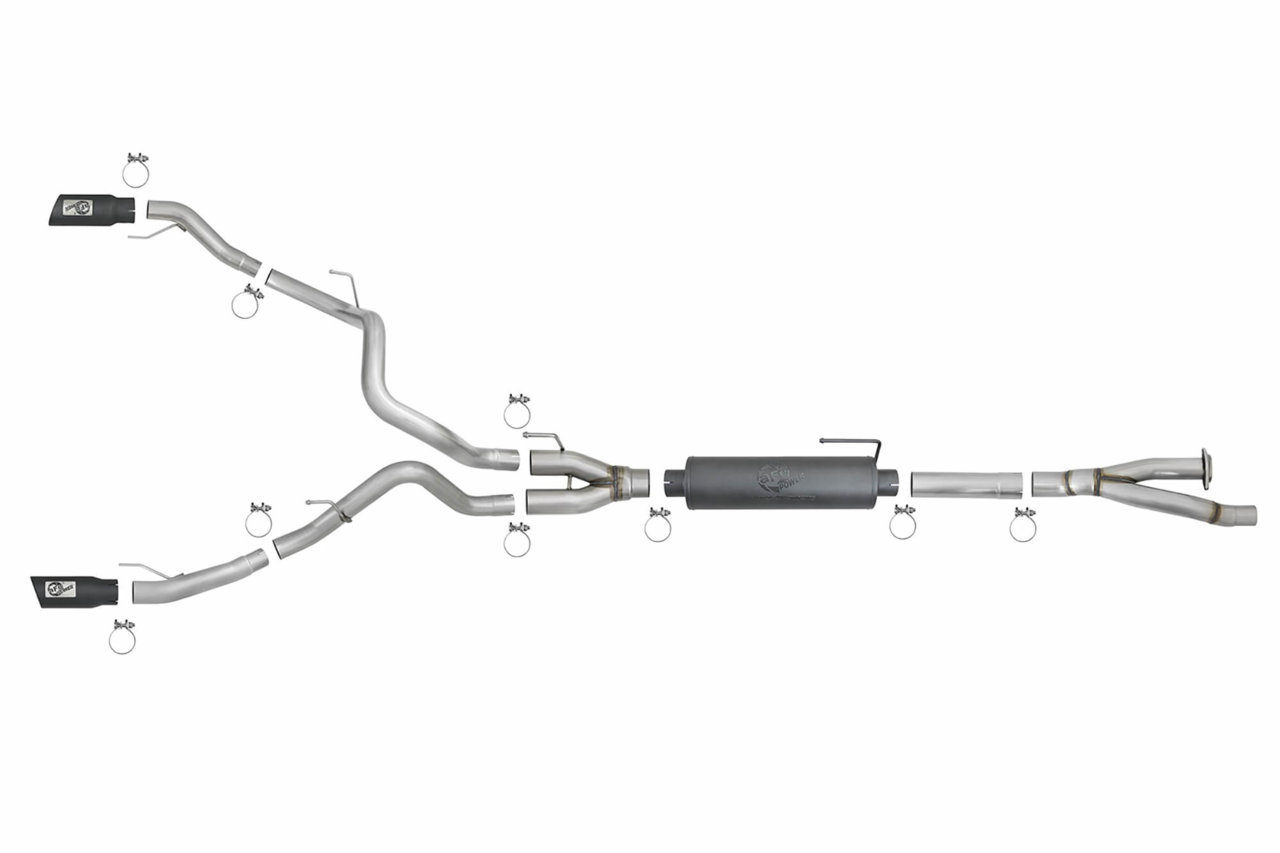

    Since you seem to know more than I do regarding mufflers, Would you do a dual exhaust with two mufflers and keep each side separate (2 x Singles) or would you do a dual exhaust with one muffler and basically have it look like an X or H (Single in, Dual out)? Which one would be better? Is sound the only difference? I would assume performance would be something different as well. I’d think the side-by-side single mufflers would allow for a less restrictive air path, which in turn would help reduce any backpressure for a possible slight increase in low- to mid-range torque, along with maybe a slight improvement in horsepower. Only drawback would be a deep, throaty tone. However, I was listening to the YouTube video on OEM vs Side-by-Side and it doesn’t seem like it is that much different as far as the deep throaty tone. However, I’m curious if anyone is aware of other differences between the two and why one would be better than the other.
    EB0FC47A-74B8-4ECA-9757-20993F89592C.jpg 8EAF0E62-82D8-4626-8CD1-144B4CD9FEED.jpg
    I’m keaning towards wanting this TRD Performance Dual Exhaust thoughts?

    The master cylinder swap is 100% necessary when you do the rear disc conversion. The exhaust wrap will provide zero help with rusting, it is only a fire blanket for your exhaust. I would steer away from the dual exhaust because if you start off roading at all you are going to crush your exhaust tips and end up chopping your exhaust right after the axle like 75% of the guys on this forum. If you get into off-roading you are going to want less stuff hangin down...

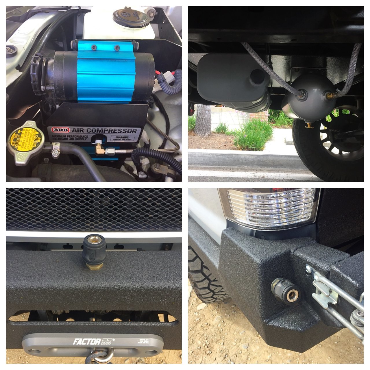

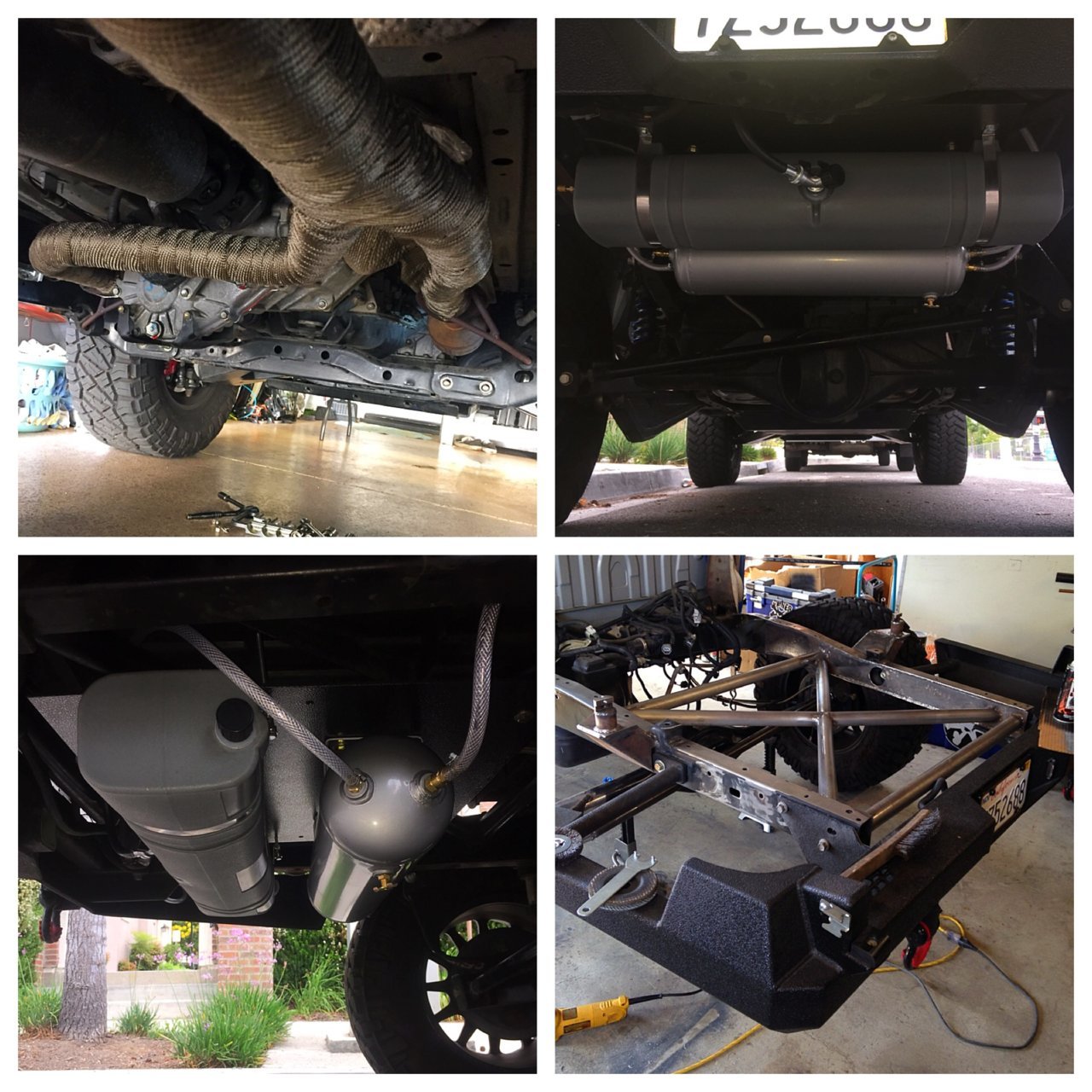

    Here is the on board air layout that was requested :

    Yes
    Well it looks like my next mod is going to be forced due to toasted cats causing me not to be able to pass inspection. Due to CA’s fucktarded CARB certification scam for aftermarket manufacturers there has been a severe lack of aftermarket CARB certified cats until recently. For a long time the only CARB certified replacement cat was the entire OE manifold which are ridiculously expensive so I have been doing a ton of research and luckily a visit to Magnaflow led me to Trevor at RPM fab in Oceanside. Going to use it as an excuse to throw on some headers...fab a set JBA titanium coated short tubes to walker cats and wrap it all up in the same DEI titanium wrap that I have on the Y pipe.
    The full skids really trap a lot of the exhaust heat under the truck so I have become a big fan of the DEI exhaust wrap, the titanium wrap goes on dry with no itchy side effects which is well worth the added cost.

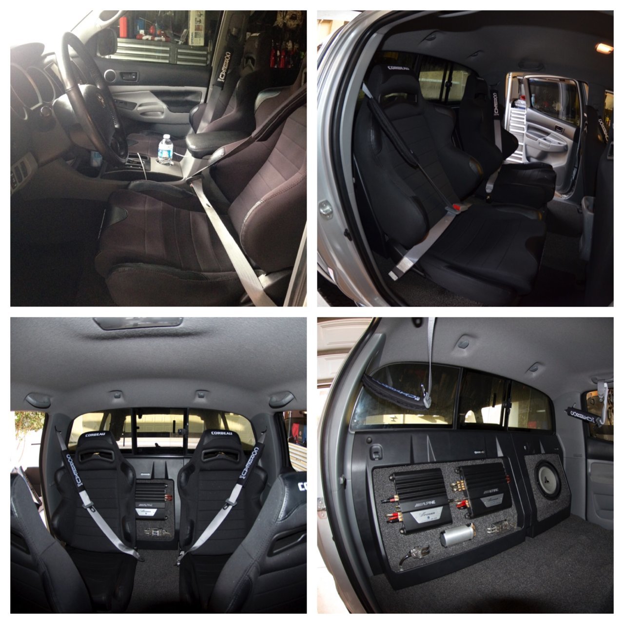

    Could you link me to where you got the front and rear seats or are they the same set..

    Front and rear seats and brackets are all the same. I got them directly from Corbeau - https://corbeau.com/reclining-seats/lg1.html
    Make sure you read my post about modifying the seat brackets for the rear seats, the rear seats are not “ bolt in “.
