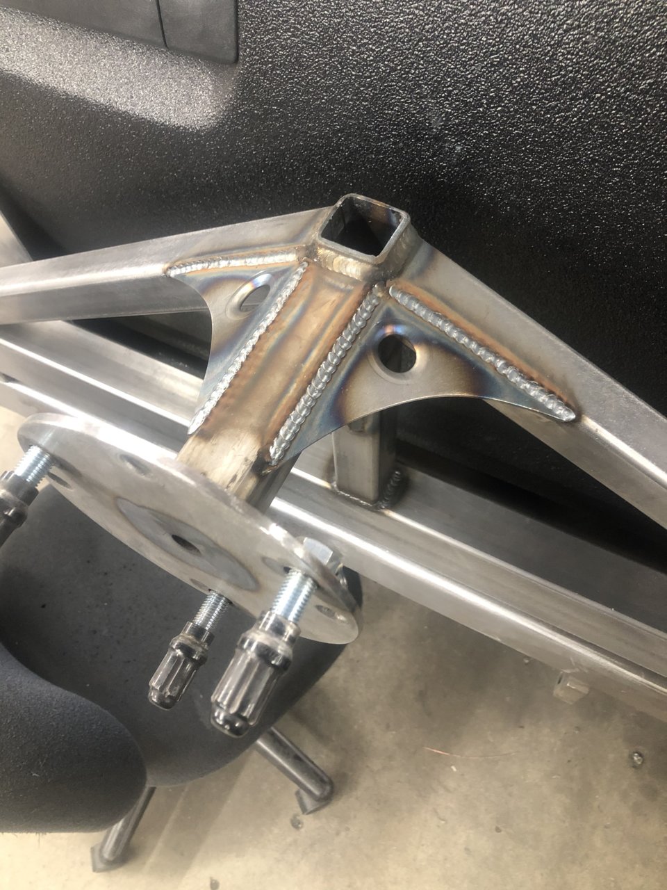

    Front bumper mounting points have been reinforced and tied into the new frame plates, there is also a new square tube cross member that will have additional bumper mounting points on it. The goal here is to never have to worry about the winch tweaking the front end.

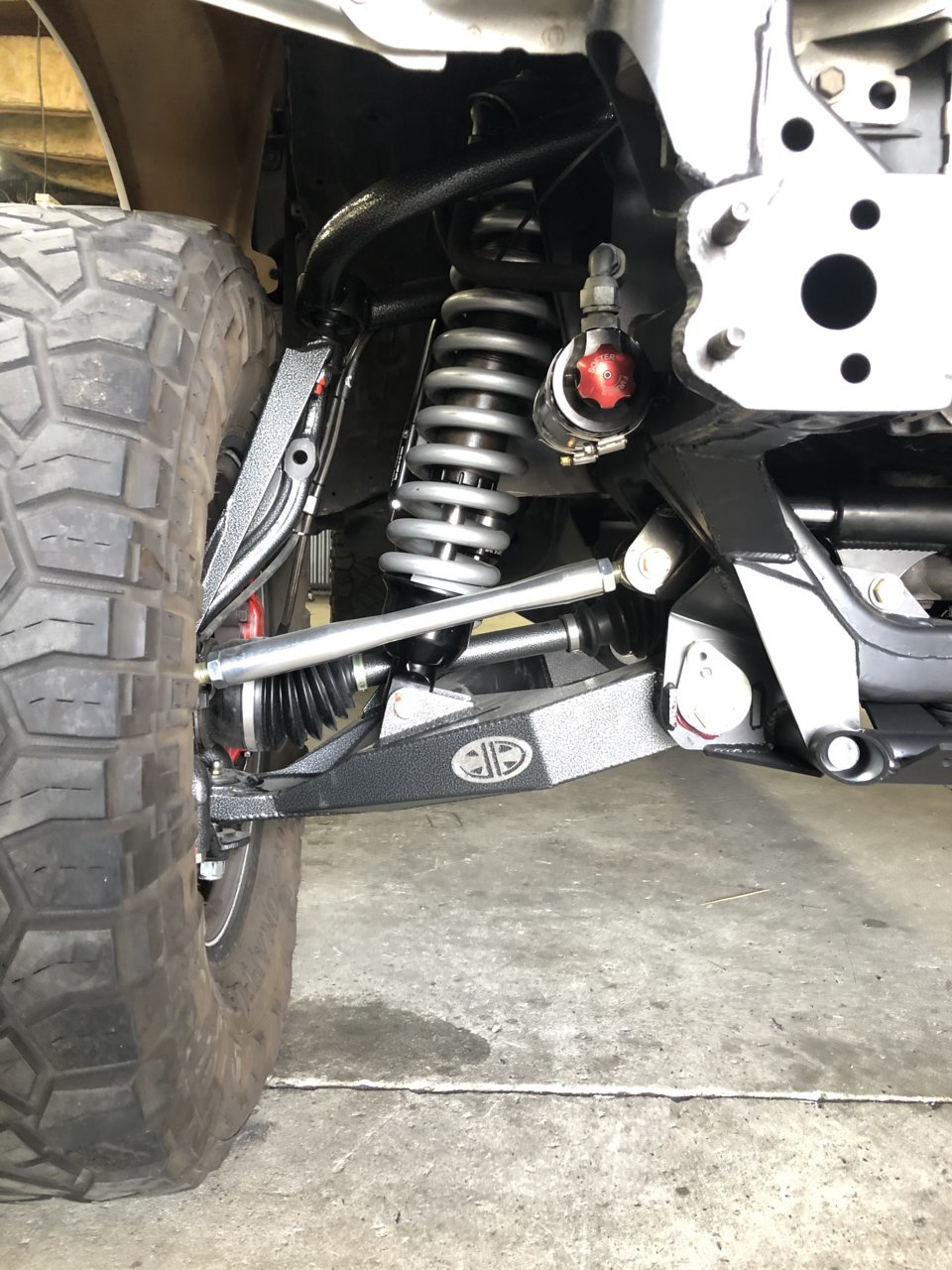

    Suspension progress :

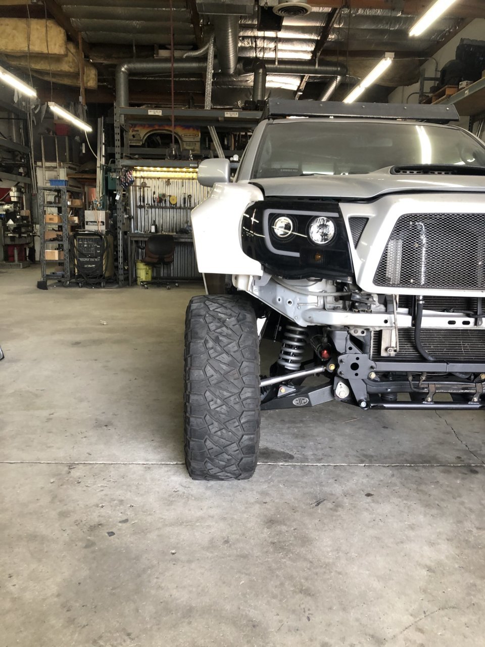

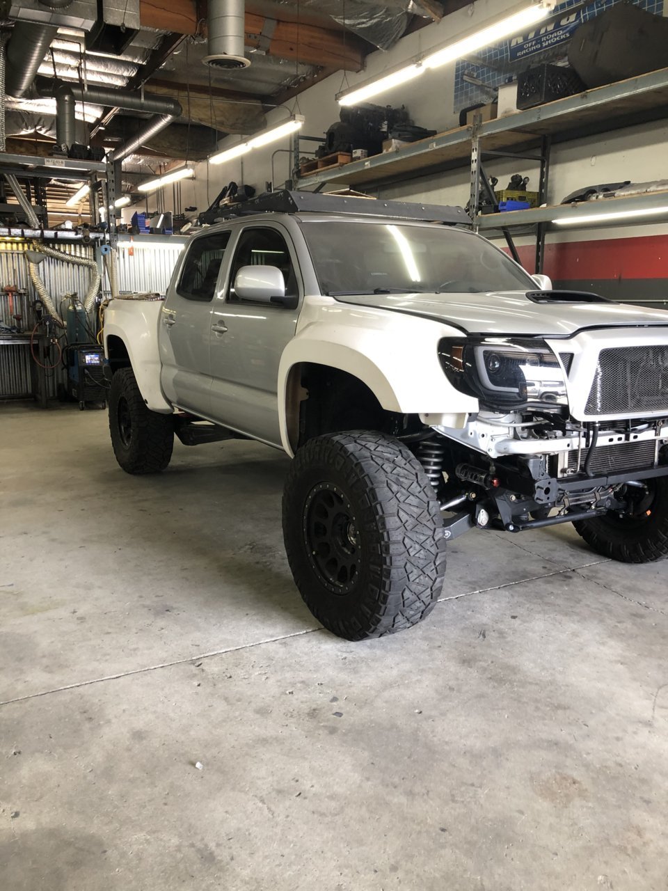

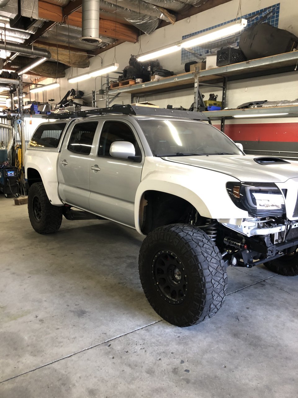

    She's back on her own feet, looks like the +4 kit with a 35" tire on a 4.75 backspace fits the +6 glass pretty good.

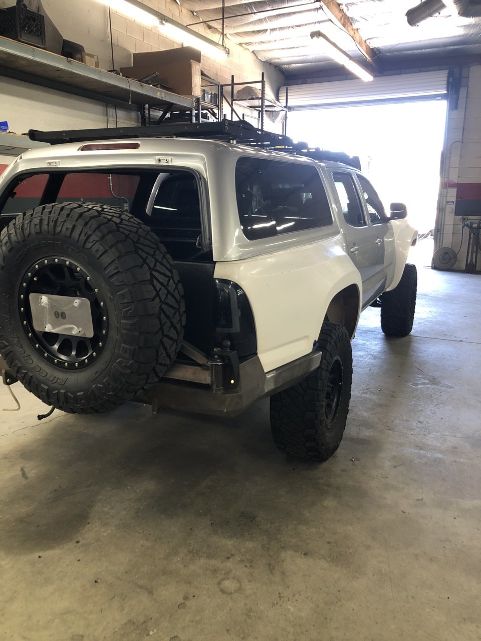

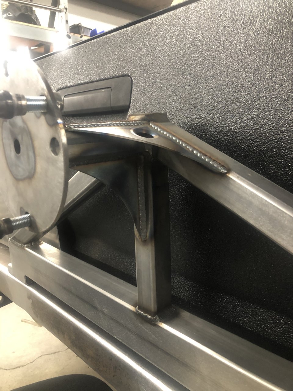

    Rear bumper is almost done, widened to match the +6 bedsides, new 60/40 swing gates that lowered the spare and the jerry cans down a bit. Since the spare is covering the license plate location partially they built a license plate relocation bracket to move the license plate up to the spare tire. If the spare needs to be removed there is a simple cotter pin to pull like this example below and I have an LED license plate frame for it :
