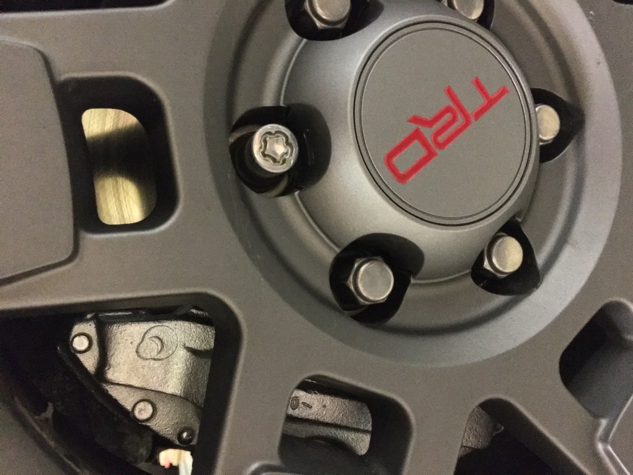

  10. Dec 31, 2021 at 9:07 AM
    #30
    se7enine
    se7enine MCMLXXIX
    Apr 18, 2013
    #102322
    23,442
    Reno, NV
    Take a wheel off and measure
  11. Dec 31, 2021 at 10:41 AM
    #31
    Area51Runner
    Area51Runner Well-Known Member
    Jun 26, 2014
    #132748
    12,006
    Northern California, Bay Area
    02 3.4 DC TRD PreRunner 4WD SWAP

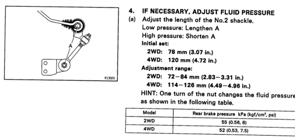

  18. Jan 2, 2022 at 11:46 AM
    #38
    O'Silver_Taco
    O'Silver_Taco Well-Known Member
    Aug 26, 2021
    #375390
    4,291
    MD
    98 Dlx Sr5 ext AT Rwd
    3rz to 2Rz bebuilt block and new heads
    Another vote for Akebono
    think there is other problems......most likely the front/back proportioner....what ever its called
    Long shot is your parking brake adjusters in rear hub may be off, or sticky or shot......how good does your parking brake hold especially when put in drive?
    Whoever did mine brake last bent that little bar that turns the star adjuster....it would stab in middle of star instead of at side....causing it to lock until popped loose with screw driver......this got old real quick.....
