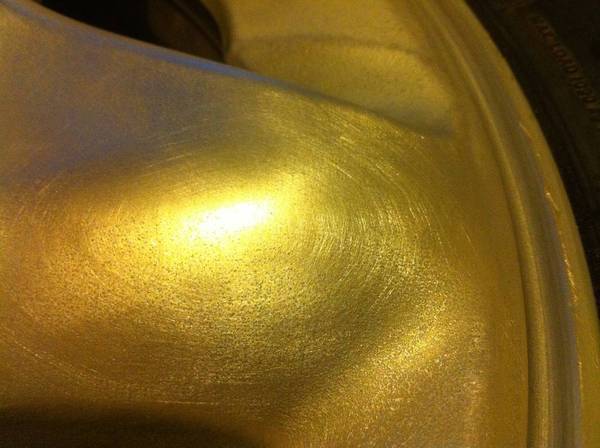

    Different rims, but same concept. I would definitely suggest sanding your rims. Pain in the ass, but better results. I took a picture of the rim after I was done sanding. Knocked down that clear coat on top and you can see the roughed up surface. I also included a picture afterward it was all dry. I used self-etching primer and a flat black Rust-oleum wheel paint I got at Autozone.
    Not sure what kind of weights they used to balance your rims, but be sure to mark where your weights are with tape if they are on the outside of your rim.
    After Sanding:
    Totally Complete:
