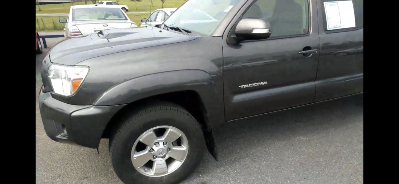

    Well, this is this the first time I've posted a build thread for all the upgrades I've done on a vehicle but figured it is an easy place to list and archive what I've done.
    My ride is a 2013 Magnetic Grey Double Cab Long Bed.
    Purchased Aug 2018:
    Look on 6/12/2019:
    Look on 6/18/2019

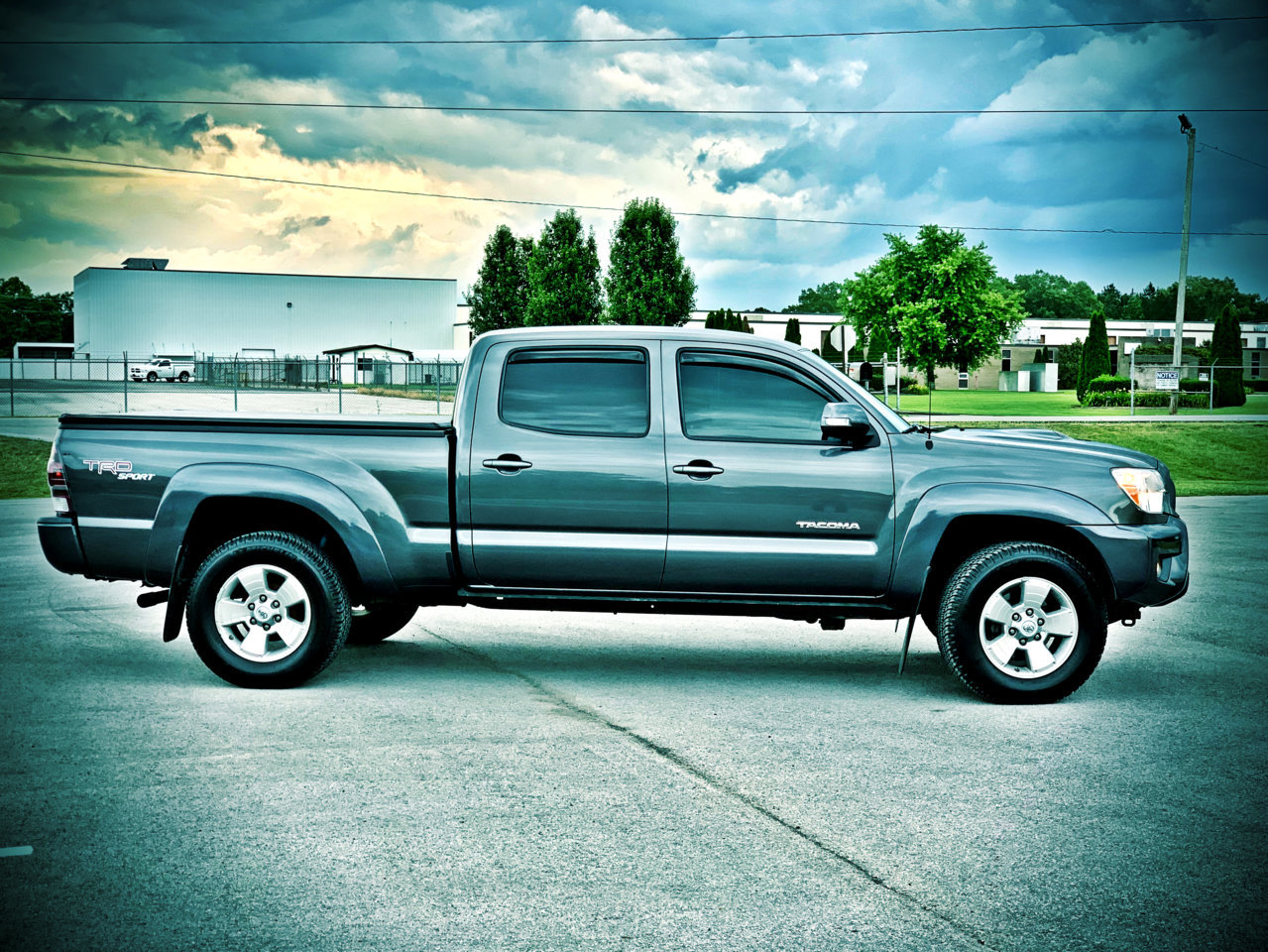

    Current Look on 6/27/2019 after upgrading tires to 275/70/17

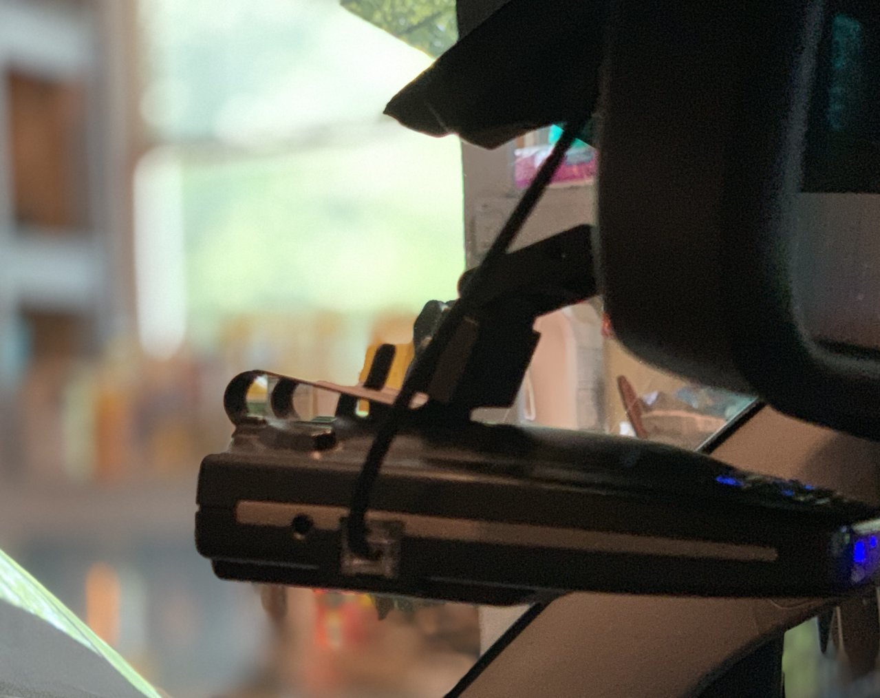

    Escort Passport 9500IX Radar Detector
    Blendmount Radar Detector Mount w/Mirror Tap

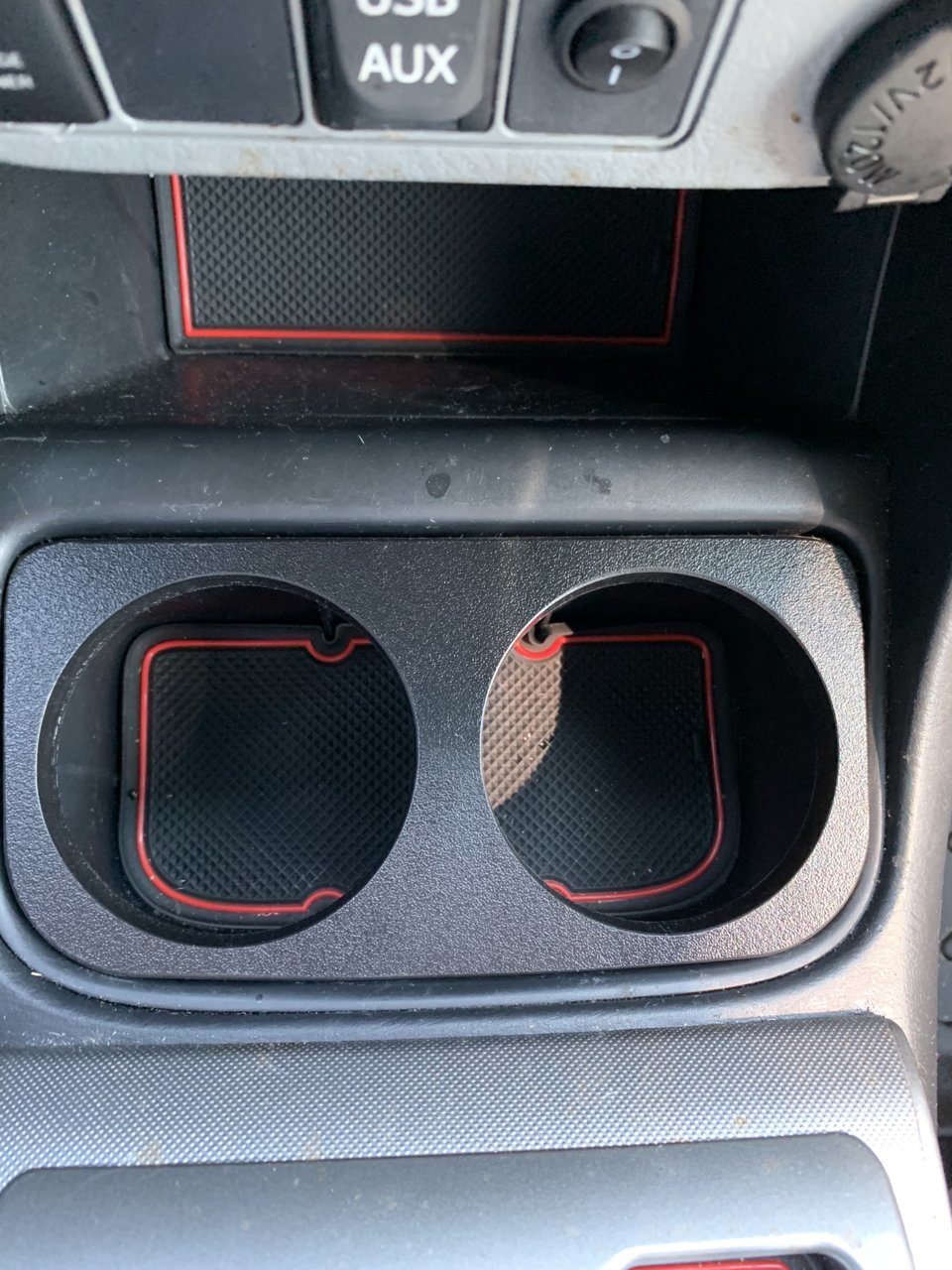

    VCiiC Custom Fit Interior Cup Holder and Accessories Liner

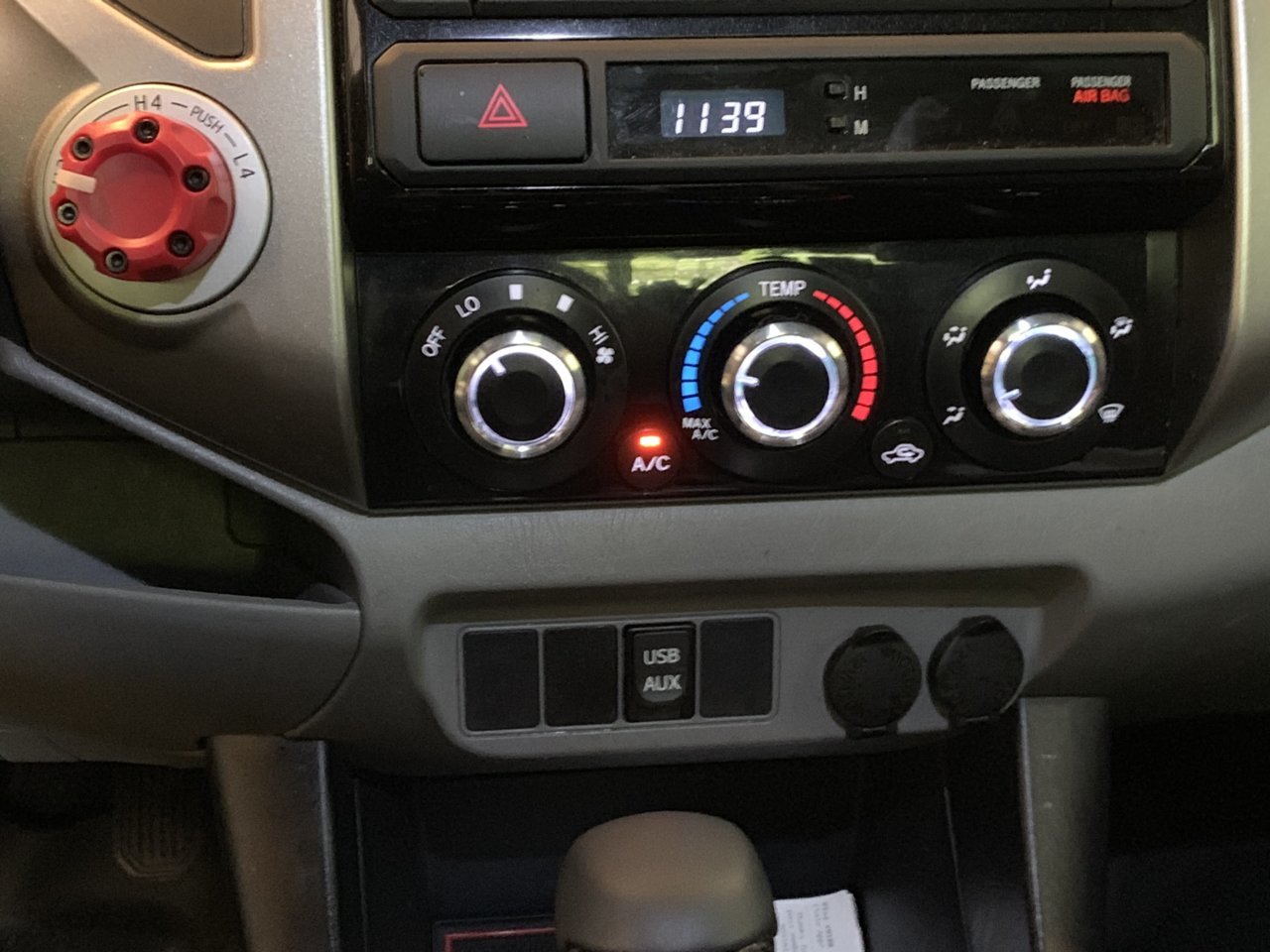

    AC Control Knob Replacements & AJT Designs 4x4 Switch Knob

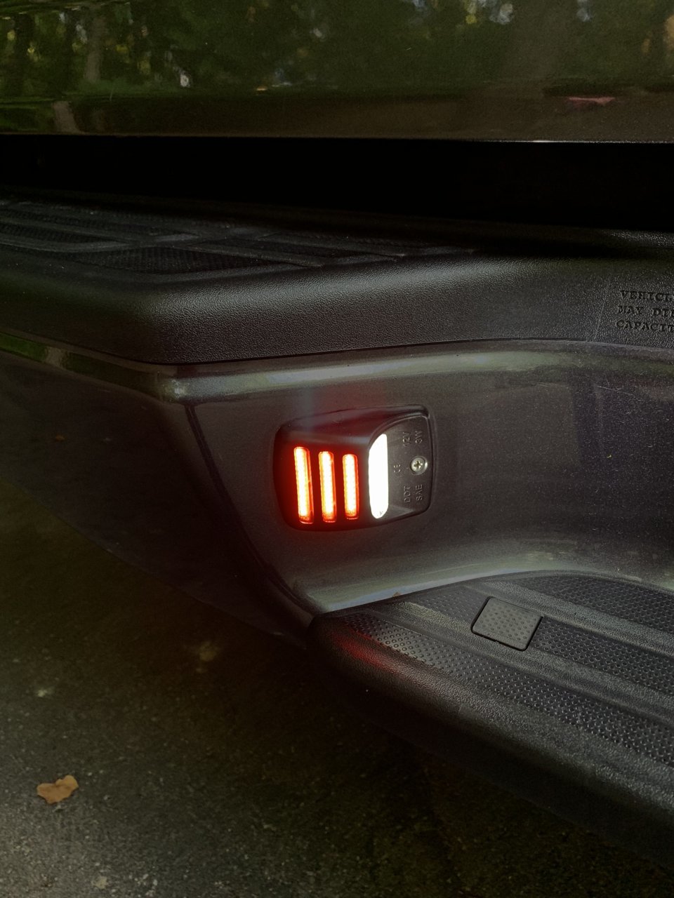

    50W LED Reverse Lights

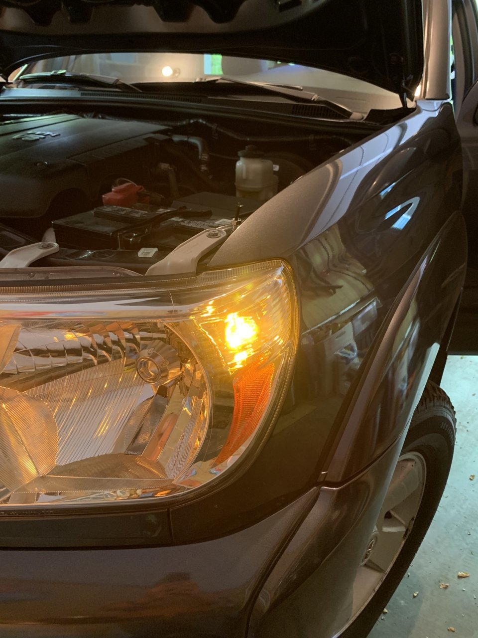

    deAUTOLED Front DRL/Turn LED Bulbs
    Smoked Tail lights
    License Plate Tag Lamp

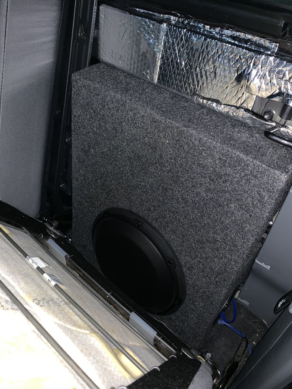

    Swapped the JL Audio 10W1 3-4 out for a JL 10TW3 today

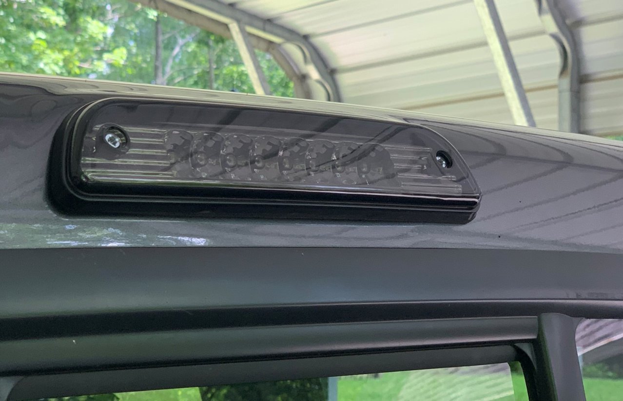

    Swapped out the third brake light for a smoked led version

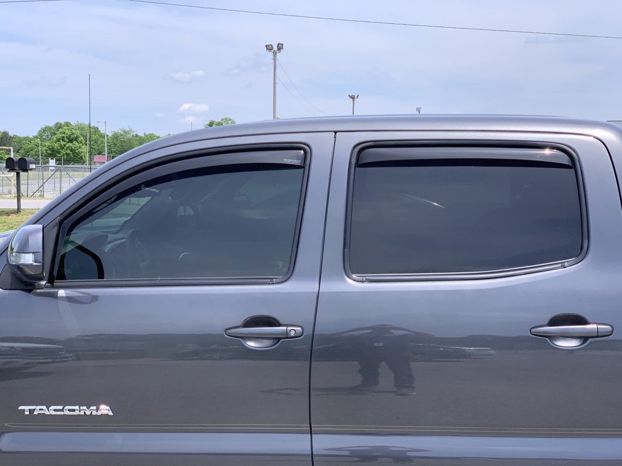

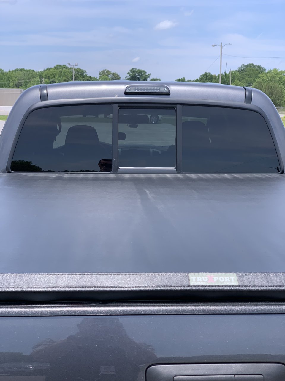

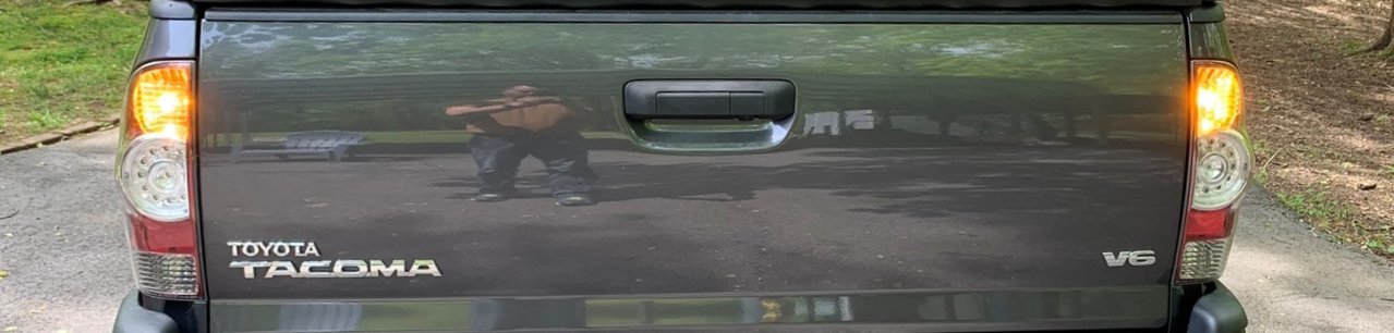

    To help with heat reduction, decided to tint the rear windows and back glass with 35% tint. Could have gone darker but wanted a decent blend with the 20% already on the front.

  8. May 23, 2019 at 1:00 PM
    theolee
    theolee www.nickleecreations.com
    Jul 15, 2014
    #134025
    7,027
    Theo
    SAN DIEGO
    Black 09 Tacoma SR5 Pre-Runner AC 4.0

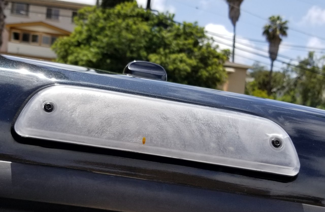

    Looks great, How's the quality and where did you get it? If you don't mind me asking.

    Right on, thats the one I was looking at. I saw it came with extra screws, washers, etc as well. Happy to hear it's good quality. I'll definitely be grabbing one of those. The last one I bought cracked, suddenly clouded out and the customer service is from hell. Really frustrating :facepalm:

    Yeah, that sucks. It came with extra stuff and two types of screws. I ended up using the screws that looked like regular wood screws. The machined screw wouldn't work with the factory plastic hole thingy.

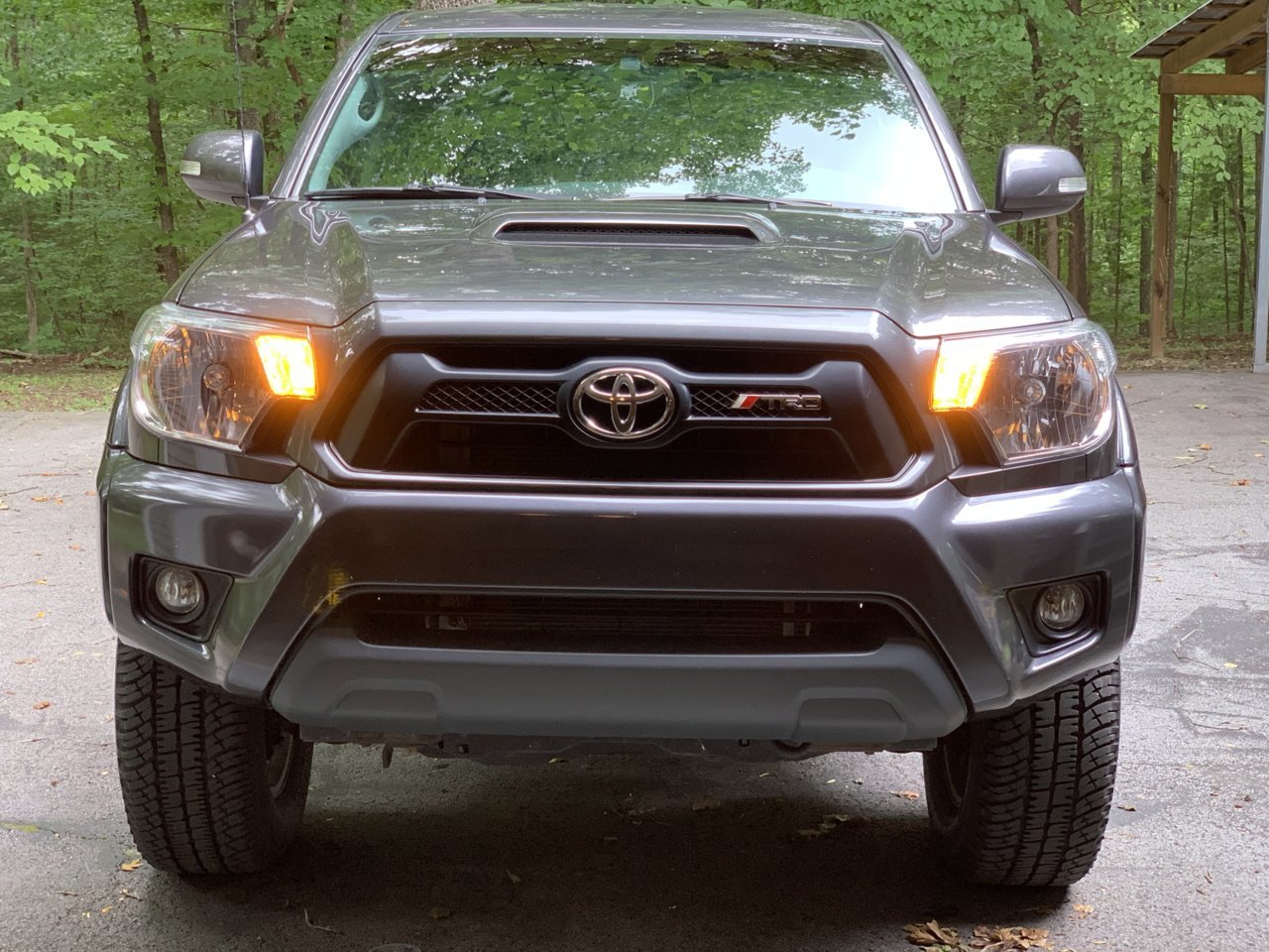

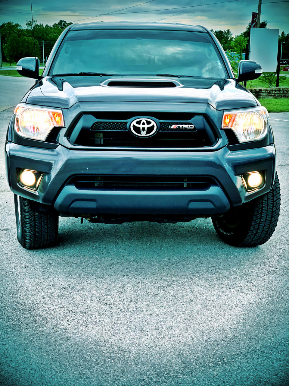

    Took some pictures this morning to show the current look. Planning to get a 2.5" lift next week.

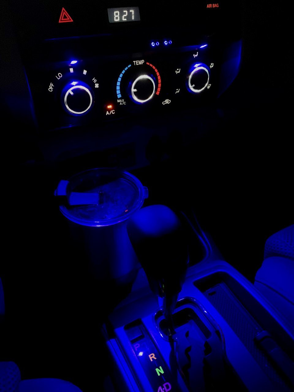

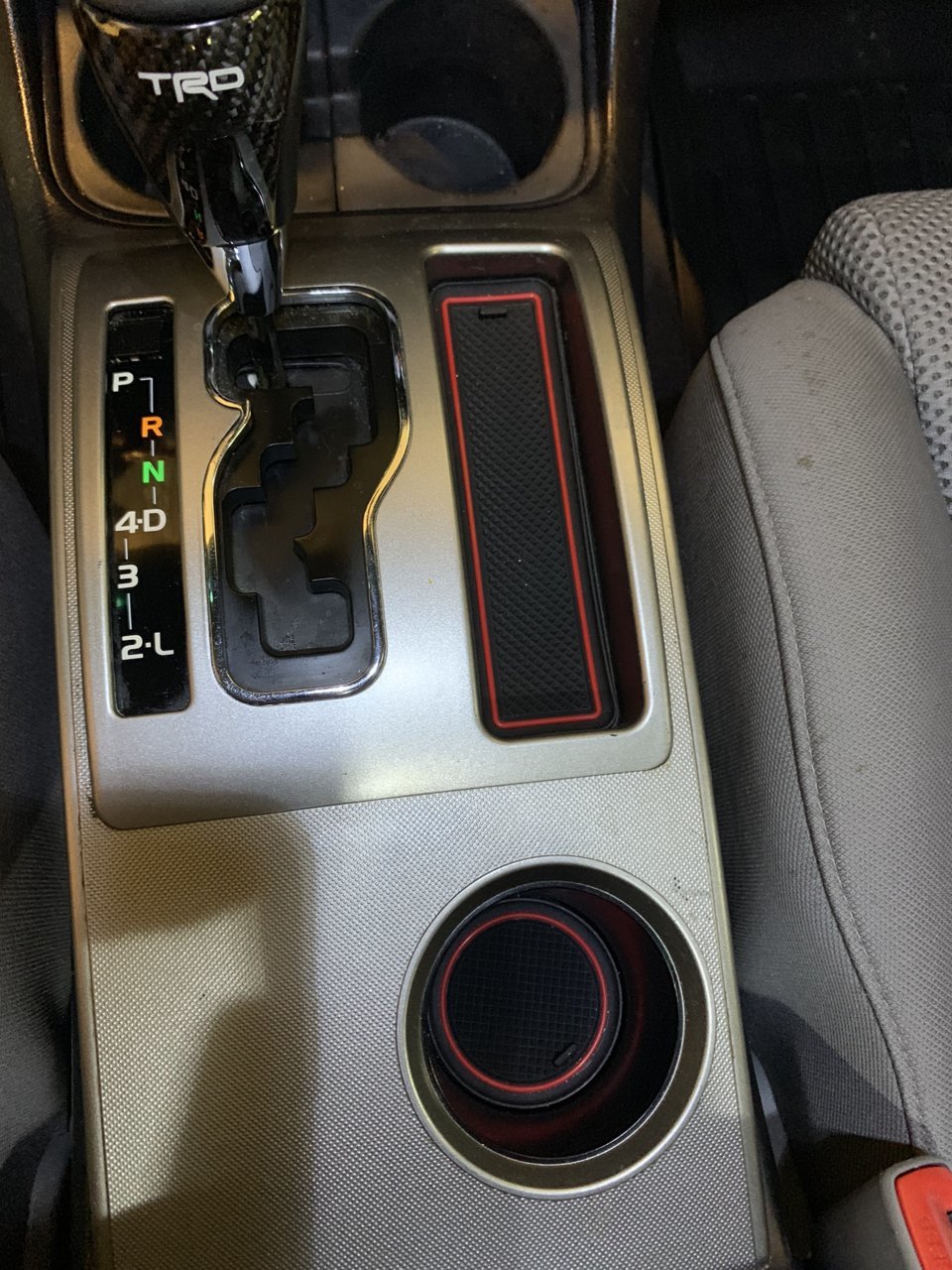

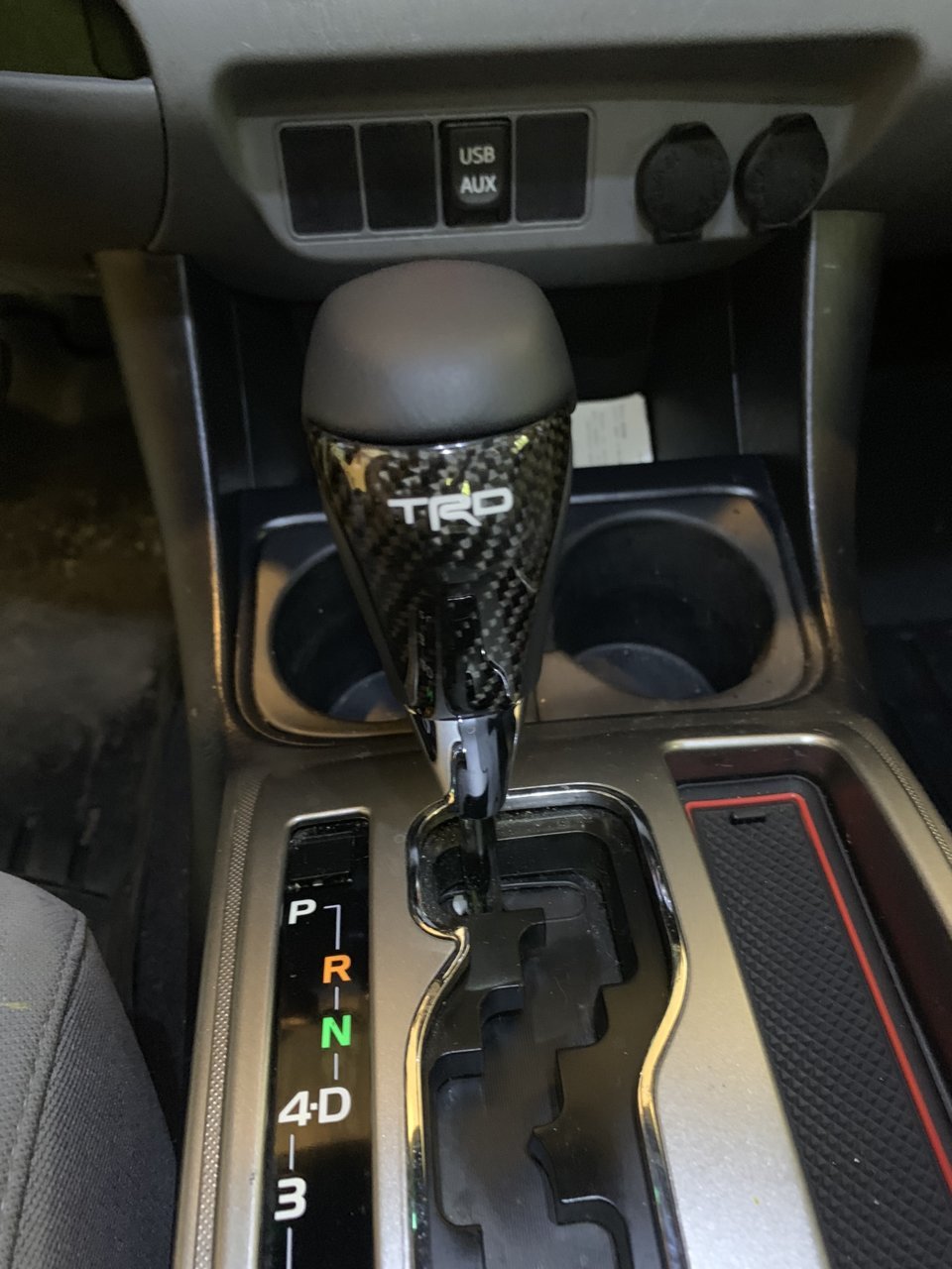

    Install my TUFSKINZ accents and while I was at it, I changed my shifter indicator light to a Blue LED version. Lift tomorrow :)!

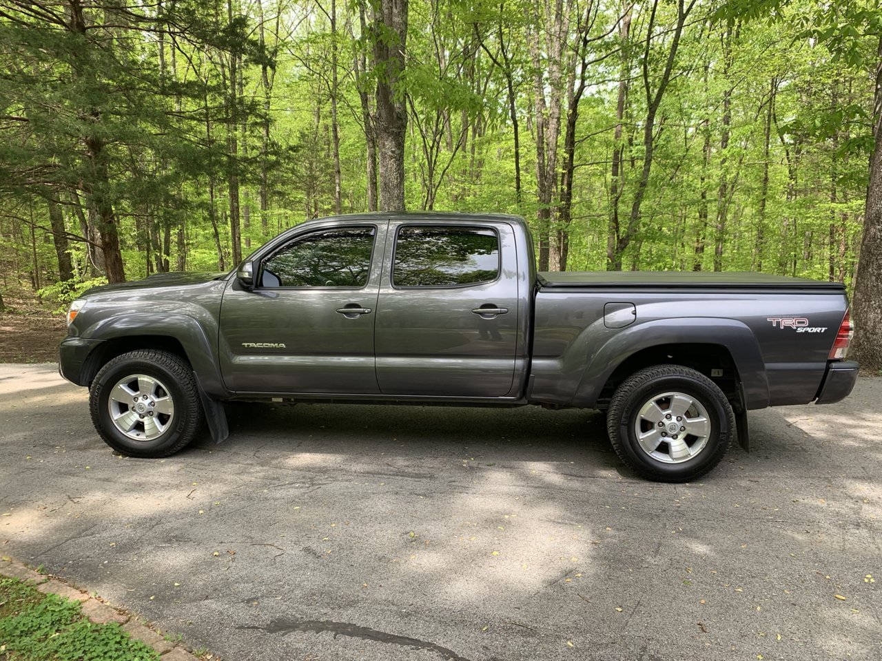

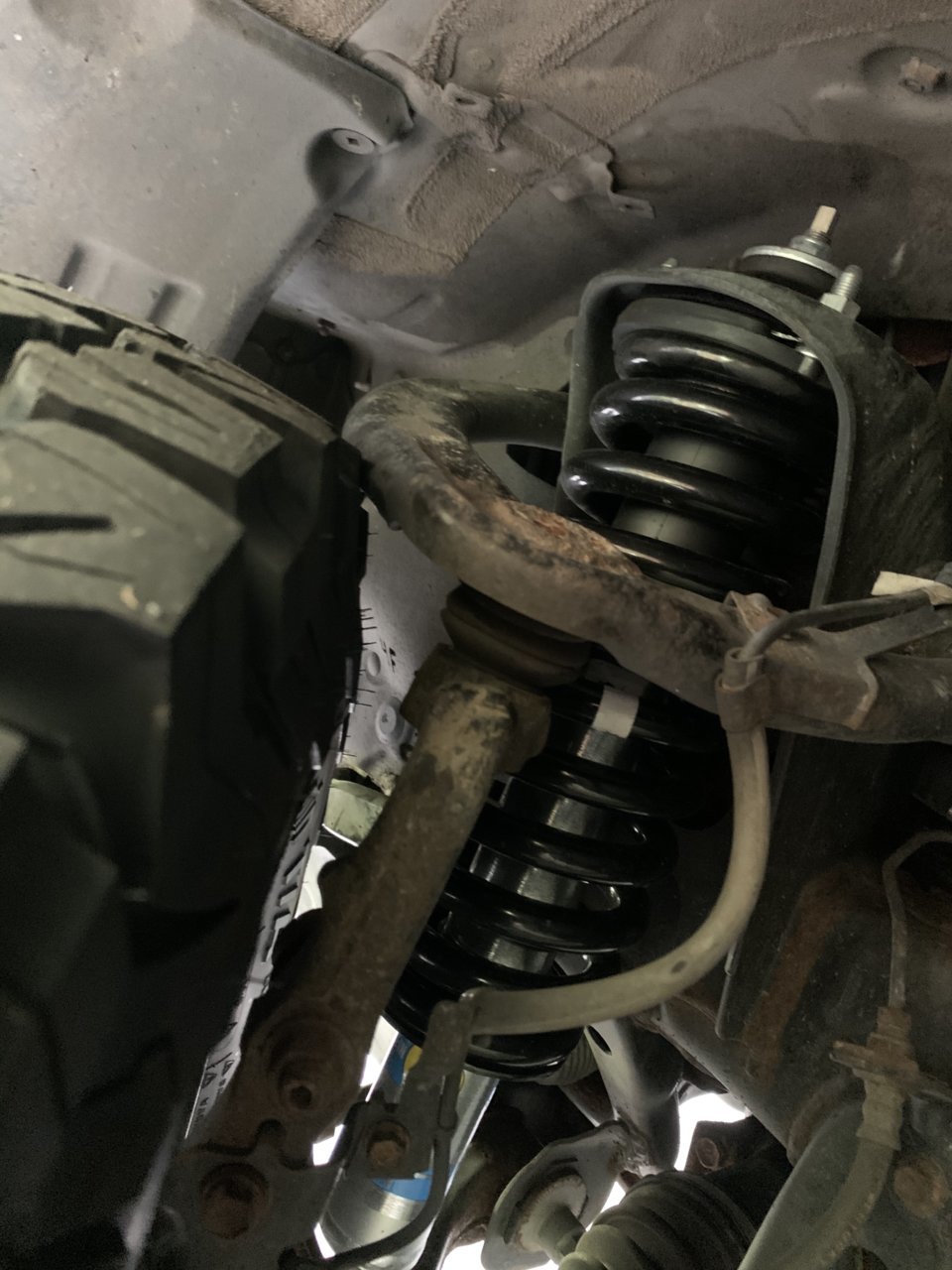

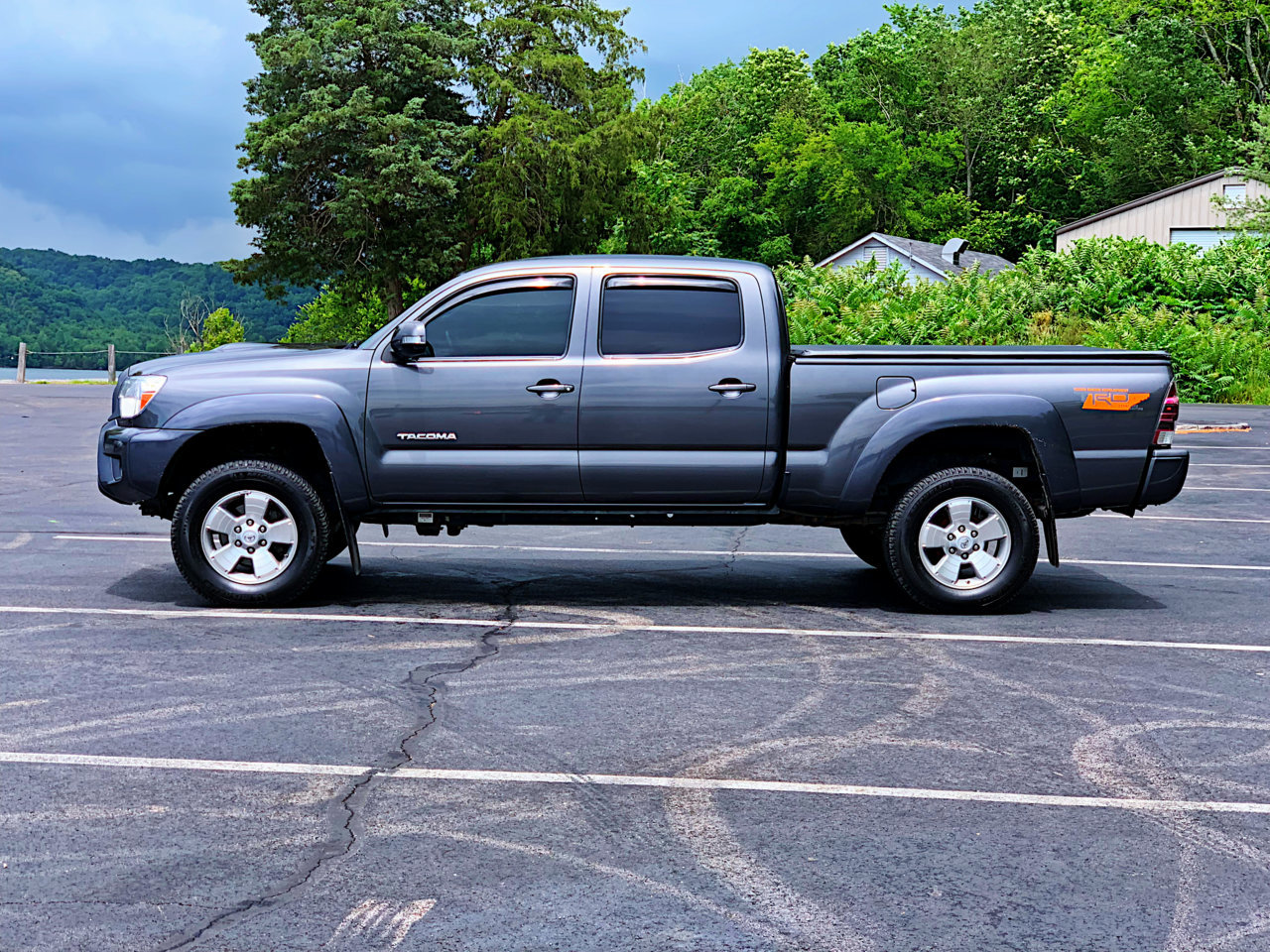

    Got my lift done today. Front 5100 setting at 0, Rear 5100, OME 885, Rear MaxTrac 1.5" Cast Lift Block
    Before/After

    Upgraded tires to KO2 275/70/17 today

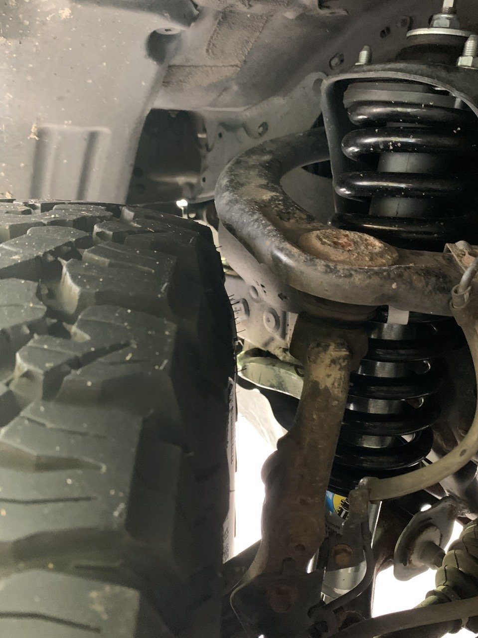

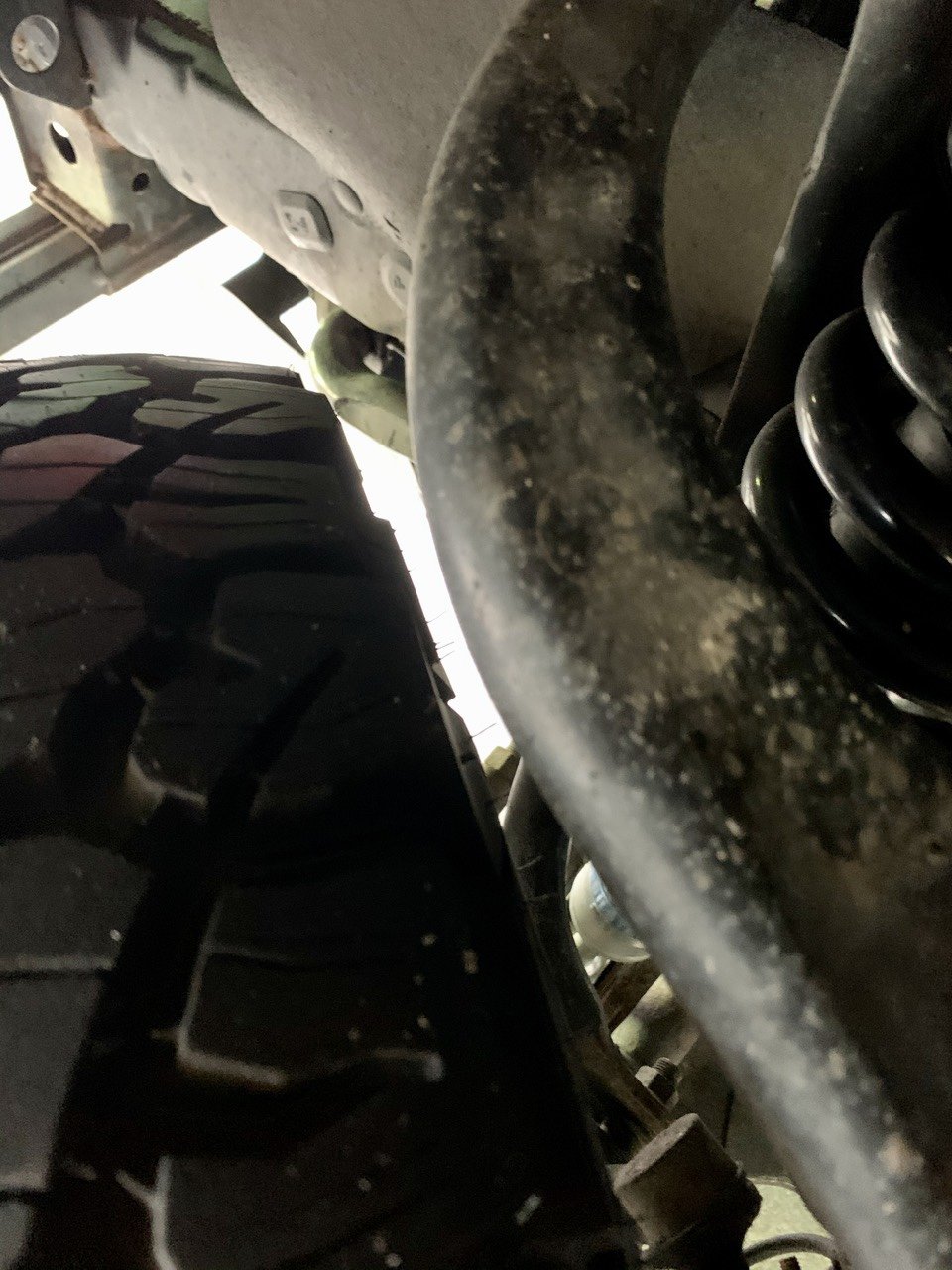

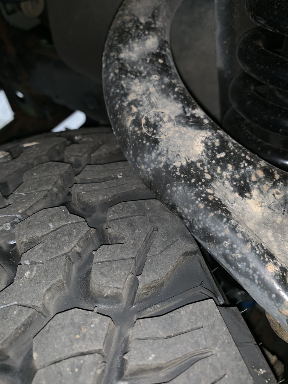

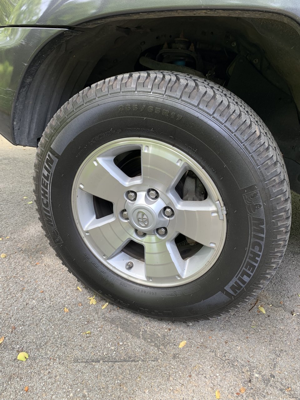

    Any rub or issues with this setup? I have a similar lift and just ordered this same tire today.
  17. Jul 7, 2019 at 4:03 AM
    #17
    Gonzo1982
    Gonzo1982 [OP] Well-Known Member
    Apr 1, 2019
    #288763
    312
    Tullahoma, TN
    2013 MG DCLB TRD Sport
    5100, OME 885, 1.5” Icon AAL, KO2 275/75/17
    Yes, at almost full lock you’ll rub the UCA on the opposite side from where you’re turning. Mud flaps are fine except small ones in front of the tires.

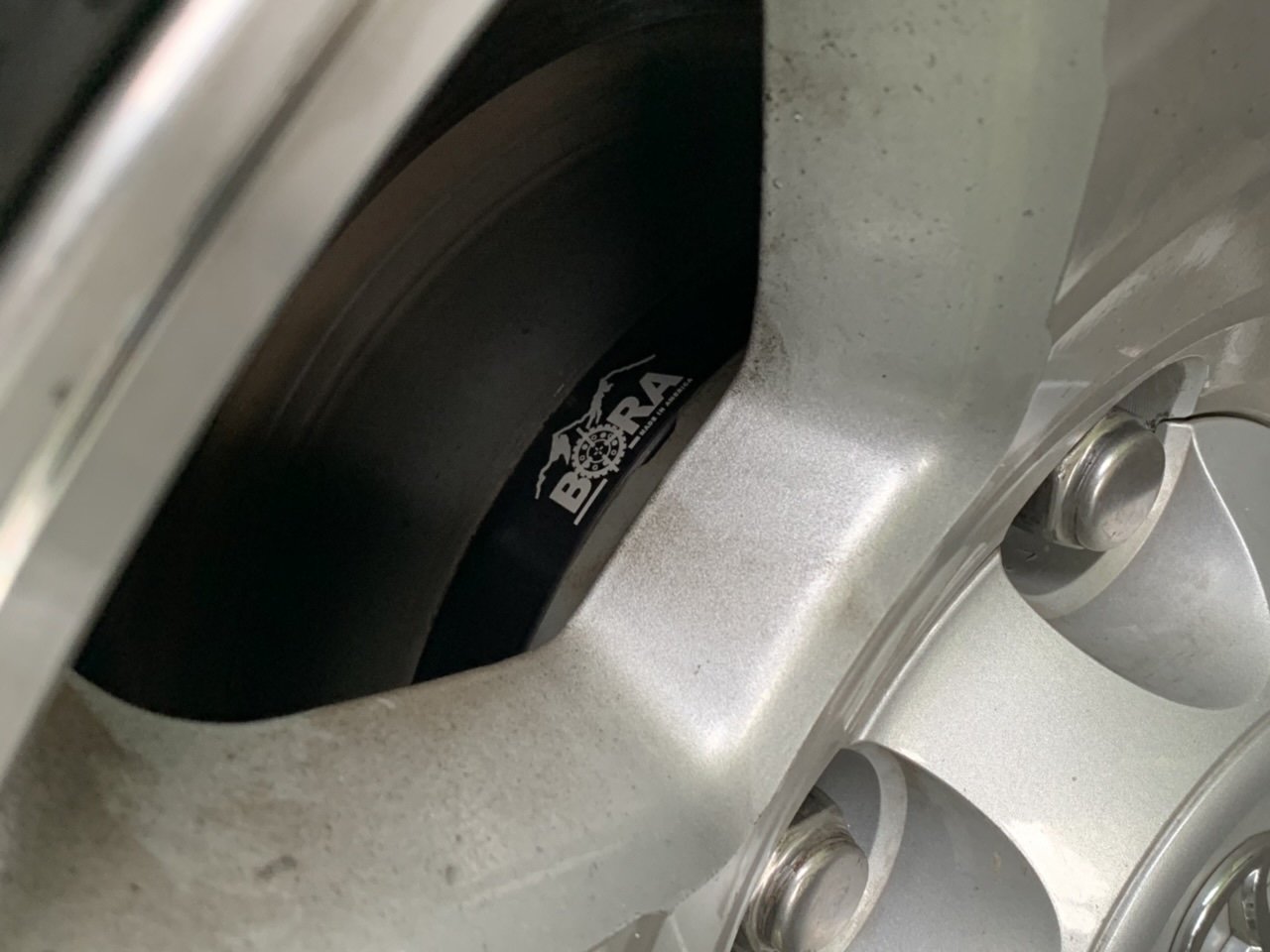

    Installed a set of 4 bora .75 spacers, it fixed the rubbing issue.
