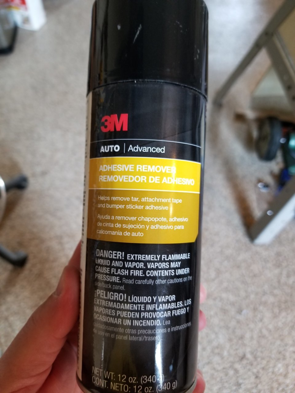

    I've used this 3M automotive adhesive remover on multiple cars, including one with black paint and never had an issue. Suggest masking the area and not using more than you need. May need to keep off plastics. ...And be gentle so as to not scratch, use a microfiber cloth. Also as someone else said, I've had good luck with fishing line too.
