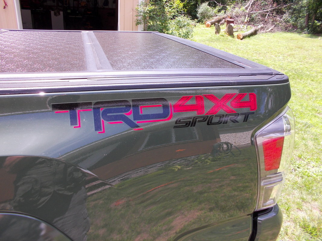

    I have never liked the stickers manufacturers put on the sides of the beds on 4x4 trucks, I think they look gaudy. When I used to order gm products (my Dad worked there) I would get them without stickers. Seeing as we can't order Tacomas I had no choice in the matter. But with a little research, I can take the damn things off!

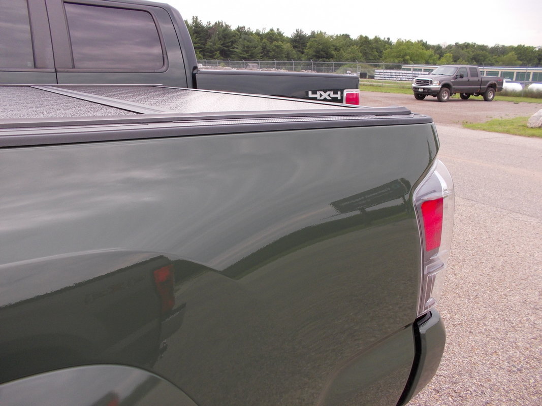

    Pictures finally, I've been too busy lately. I parked in the hot sun and the decals peeled off in one piece pretty easily. 3 M adhesive remover and a microfiber towel took care of the leftover residue very quickly. The hardest part was making sure I got all the edges of the adhesive off as the straight lines tried to stay on the paint. After a light shined from several directions showed that I got every speck of it off I cleaned the area with Dawn & water spray, then a couple coats of wax.
    Like they were never even there! I'm happy! Also I want to add I like the Tacoma badges, I have just never liked the stickers they put on the sides of truck boxes. Any of them.
