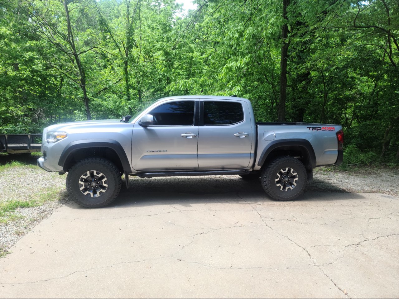

    Kings 2.5” front and rears from Accutune / ICON RXT LEAF PACK black badges doors and tailgate / method 315 / 255/85/16 Yokohama G003 / magnaflow exhaust , axle dump / meso int delete kit / meso led map lights / dome lights / wheelers front super bumps / accutune Flip kit with spacer and new bumps / Cali raised fog light pods / Cali raised ditch lights / RCI FULL SKIDS / SLIDERS / RCI rear bumper / rigid backup lights / tuned on 4.88’s
    OP 1.5” front lift 1.5 “ rear lift Aal 5100’s no complaints ride is stiffer but in a good way. Great budget lift. Camping light trails etc. won’t disappoint. Lots of good advice on here. Good luck just my 2cents. Pic for reference 8784EC0B-A450-49D7-BAA3-B2DC7BBFA2B6.jpg
    MAVEN4, TacoZmtn, Taco Guy11 and 4 others like this.

    Sharp truck! The 5100's aren't off the table but my experiences have been so-so with them. We aren't hard core rock crawlers, but do find ourselves tackling more than light forest service roads occasionally.
    71tattooguy[QUOTED] likes this.
    Thank you bro. 5100’s are nice not the best but Work great for my needs. Light trails and camping. No nose dive body roll on turns you know. 6112’s are sick also. Eibach great kit as well.
    Vlady and jcm[QUOTED][OP] like this.
