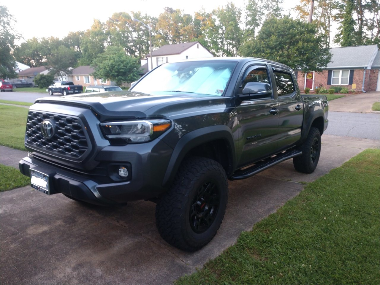

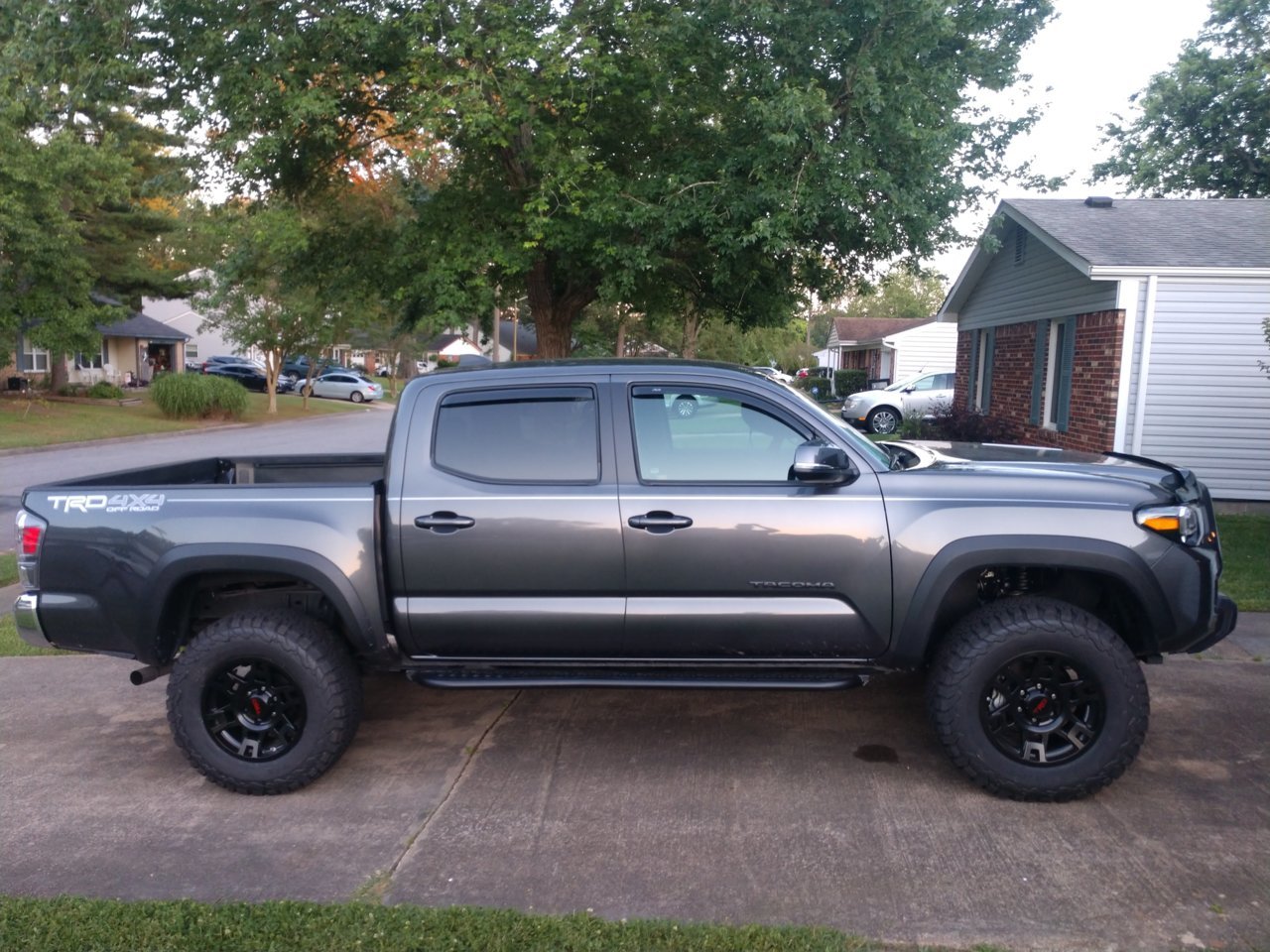

    Looks nice @12020rixtactoy thank you again for your business!!! :cheers:

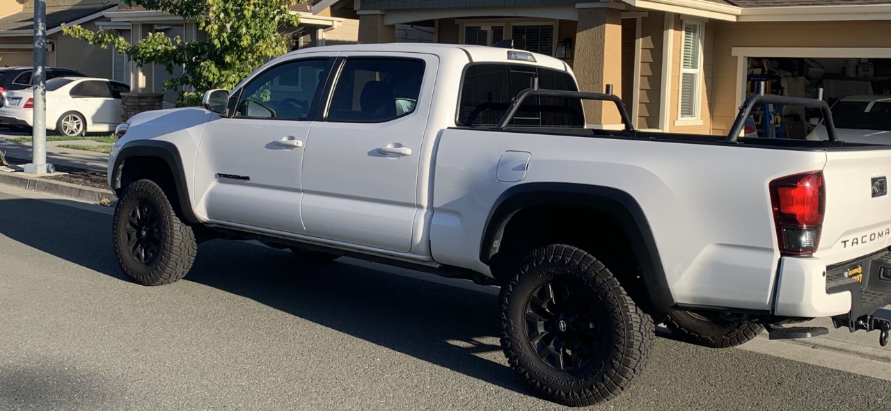

    5100’s over here still have all my teeth
