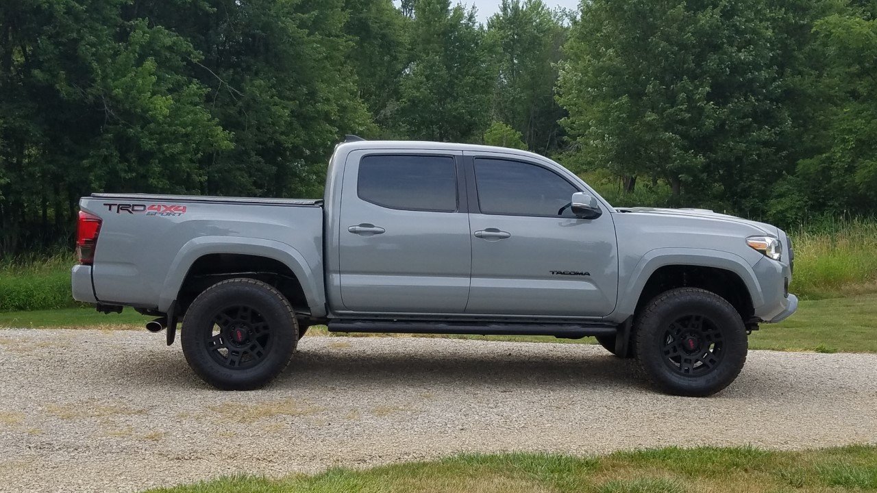

    #134
    skidooboy
    skidooboy titanium plate tester
    Dec 7, 2019
    #312767
    1,325
    central lower mich
    2019 Tacoma Sport KDMax Tuned, Cement
    dd light bars, trd cat back exhaust, KDMax tuned, trd skid plate, 2" lift, sema wheels toyo open country at3 tires.
    went the spacer/block combo. bought supreme suspensions 2" front, 1" rear leveling kit (clean freak, will never go offroad, did it for aesthetics) . with the trd sema wheel, and 265/70/17 toyo at3's, it sets 37.5" from ground to top of the wheel well. no rubs, no vibrations, did it myself, in the garage today. rides like stock. Ski
    rileytaco99 and SELAroadrunner like this.
