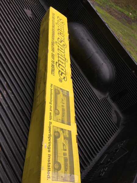

    Someone gifted me some good leaf springs still in the box, so I'll be putting those on.

    leaf box pictured

    I do not believe that free leaf pack you got pictured will provide your desired lift in the rear. I'd recommend looking on this forum for a more appropriate leaf pack to achieve that 2-3" (e.g. alcans, deavers, dakars)

    Yeah I think you're right. It's just a single leaf for each side to add bed weight capacity, which I do need. I live off grid on a ranch and need to carry a 100 gallon fuel tank through forestry roads every other week. The leaf doesn't look like it will be providing much lift, if any.
