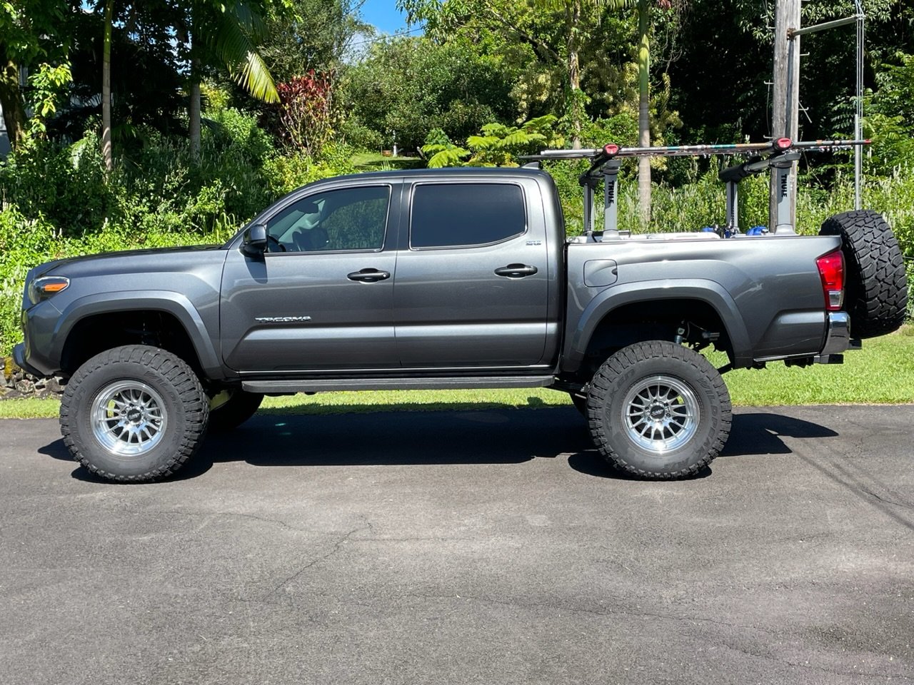

    I asked Alcan to make a 6” spring 650lb capacity. They recommended a 5” but I wanted a 1” rake when loaded for camping, helping to keep my steering wheels planted and not floating down the highway.
    The above picture has two 150qt coolers fully loaded with block ice, about 30 gallons of water in containers, spare 35 and carrier weigh roughly ~180 lbs —- and I still have a slight rake.
    drives like a freaking dream when I go camping. Rides like shit empty bed but I don’t daily the truck so that’s why I made the decisions as that

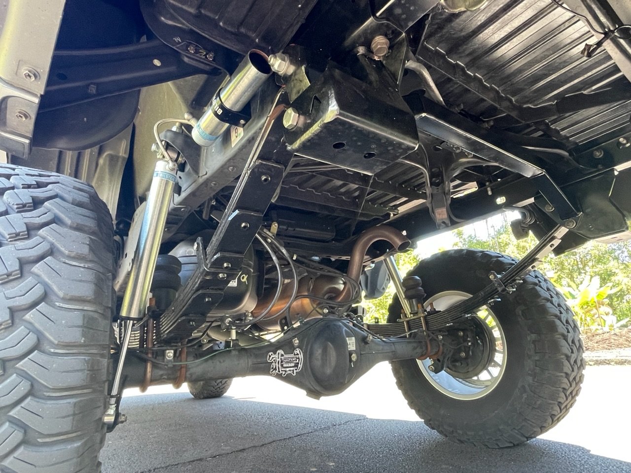

    To do a 6” lift properly, it’s gonna cost more than what is advertised in a basic kit. Get rid of the barrel spacers for the front, get rid of the block and AAL, and upgrade all the shocks that don’t come with the main kit.
    Bilstein offers a full length strut for the front to ditch the barrels, and it’s a shit ton cheaper than a full coilover. It’ll do the job up until a certain point.
    I use them with an OME 888 coil. They ride decent, but definitely heat up and fatigue after crawling on lava rock for 30-45 minutes (technically that’s a lot of cycling, but whatever, I air down to help alleviate that).

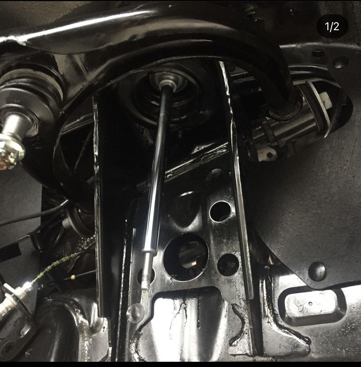

    ouch!... I've got an OME 2 inch heavy coil front lift. no spacers front or rear. I did a little more digging and now i'm wondering if my lower strut bolt on the LCA has slop. my previous coils were Bilstein 5112 and they made no weird noises.

    could always go over the shock bolts and check their torque. could also be the shock not having enough down travel like you said. Orrrrr….could’ve separate the shaft like how I did my Bilstein. I had them on the truck for 500 miles, 3 months, and it broke.
    Of all the trucks I’ve had, and all of my friends, that was the only one to ever have done that. I take it more of a defect than an issue of the brand. Cause I’ve been using Bilstein full length struts for the past 7 years for the 6” and it’s been great
    I don’t have experience with OME struts, I ran bilsteins with my OME 888 coil.

    You'll know you're hitting the downtravel stops if it feels like the front of the truck is being yanked downward (usually with a thump) as you crest over a mound or hump, or drop off into into a low spot. DBs certainly will help with that.
    WTF? Did that unthread itself from the piston? o_O

    I figured it would be more violent that makes sense. Must be a loose bolt or something i'll have to look.

    What you are experiencing is probably your front shocks topping out (running out of downtravel) Is it like a “thud” that you are feeling?
    Which 2” lift are you running?
