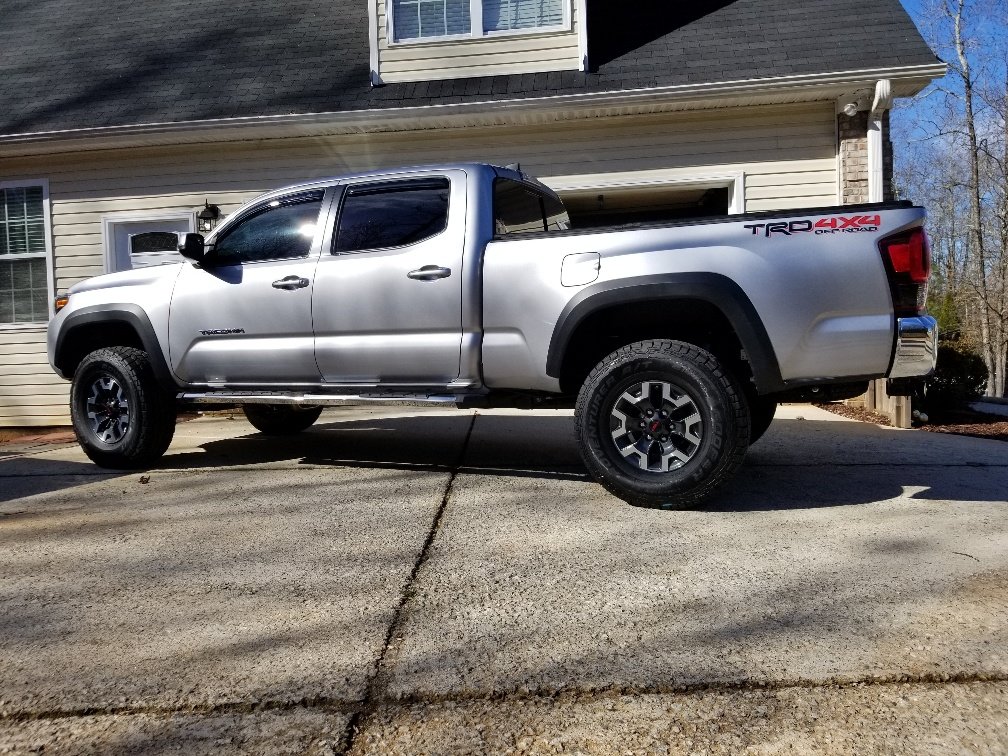

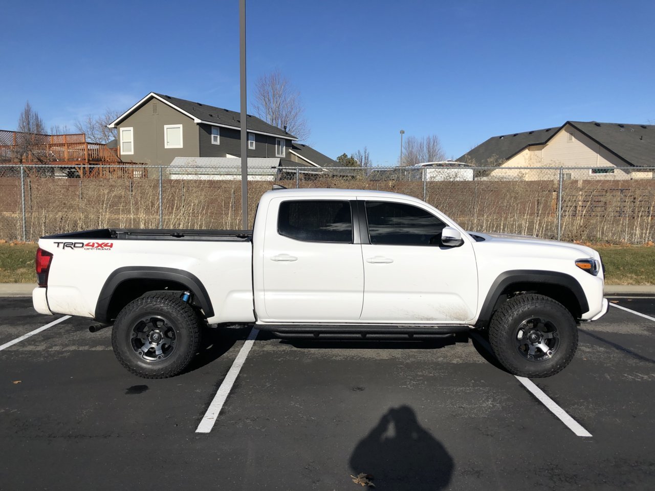

    IMG_20181009_181855269_HDR.jpg 5100s front and rear, set on the 2nd to the top notch, stock coils and a one inch block in the rear and mine rides better than the stock sport suspension. I have no complaints, and I don't see where people think it rides harsher than other springs. I'm on stock uca and the allignment is all within factory specs. Did the front diff drop and rear carrier bearing drop, no issues. Added some TRD pro Sema wheels and tires, 265/70/17 SL Toyo open country at2. Do a ecgs clamshell bushing and 1/4 shim for the lean.IMG_20190101_121203445_HDR.jpg
