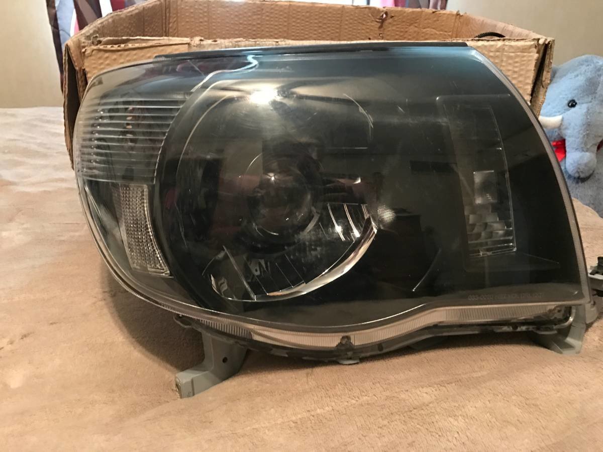

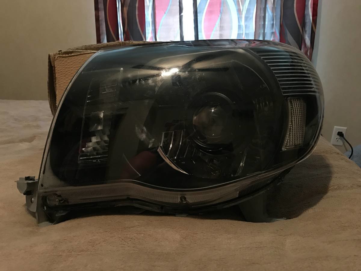

    Found on local craigslist ad a set of built retrofits for 350.00 obo. Guy said he would take 300 to meet me or 250 if I came to him (about an 1.5 hr drive)
    What you guys think on these?
    Ad states:
    Built headlights for 2005-2011 Toyota Tacoma. Has HID's in the projector. Have all the wiring. $350 OBO

    First picture almost looks like condensation on the left corner.

    dangit.....I did not notice that before!!! I have not bought or committed to buy, but if they fogged up on me I would be extremely ticked!

    The seller also said on the 2nd photo that is just a glare not a scratch, but I'm not convinced.

    That or a bad headlight restoration attempt.

    He also was not the original owner / builder of the retros , he said he did not know if they leaked/fogged because he only had them on a few days and did not like them on his truck....

    asked about the first pic having moisture buildup and got this new angle pic and this response....Here's the one you just asked about the moisture. I cleaned them that day and didn't get all of it off. Like I said, I only had them in for a few hours that day
