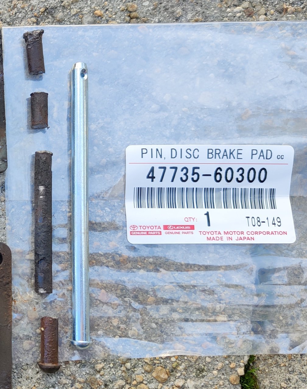

    I did the brakes on my 4Runner a few months ago. Replaced the pads and rotors. I used a large screwdriver as a pry bar to open up the caliper to fit the new pads in.
    Removing the old caliper pins was a massive PITA. I was able to hammer them all out with another sturdy screwdriver, but I had to chop one to pieces to remove it.

    Here's the part number for the caliper pins if you need new ones. They're about $8 each.

    2019 T4R ORP
    Yeah the metal seemed soft. Out of the 4 pins, 2 came out without too much effort. Those 2 happened to be the pins higher from the ground. The 3rd needed more effort, but came out, though slightly bent. The 4th almost seems to have swelled. Trying to hammer it out cause it to deform more. Cutting through it didn't take much effort with a saw blade by hand.
