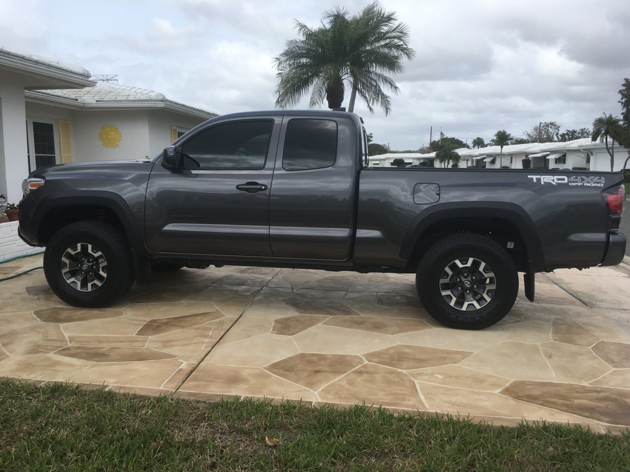

    Yeah it happens quite often haha.

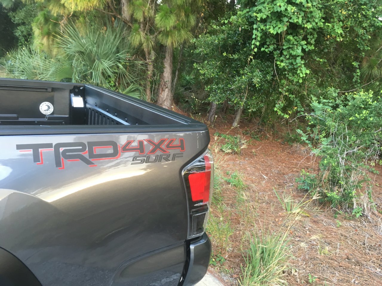

    Photos as requested, you too Enjoy and Have A Safe 4th Bud!!
    New Bed Side Decals:

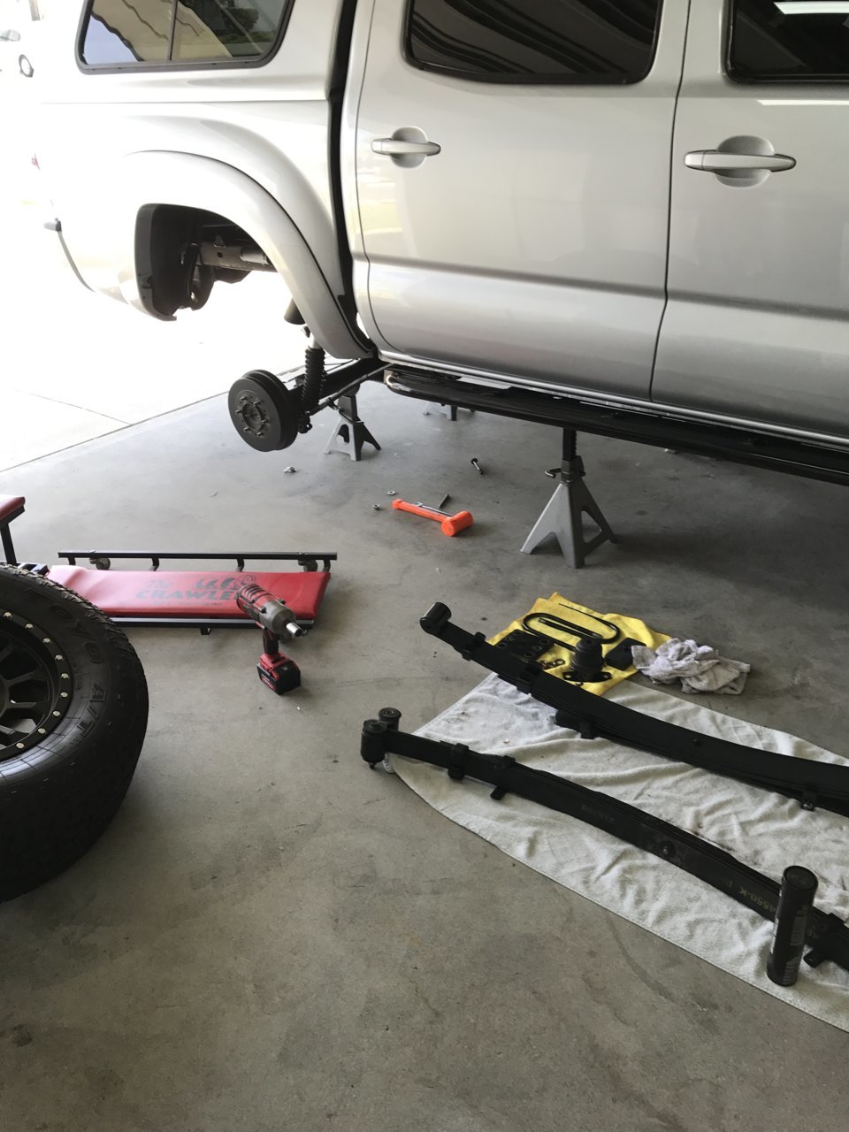

    Finally installed the Frankenstein leaf pack today. It consists of top2 leafs from a 3G, 2middle leafs from a chevy1500, & the overload from the 3G. I also put a 3/4 axle shim to the pack to help smooth it out. The ride height is within 1/8 of level at all 4 corners:thumbsup:. I've only driven it about 15 miles but is very comfortable so far. Time will tell.
    Soul Surfer, itaro and Airdog like this.

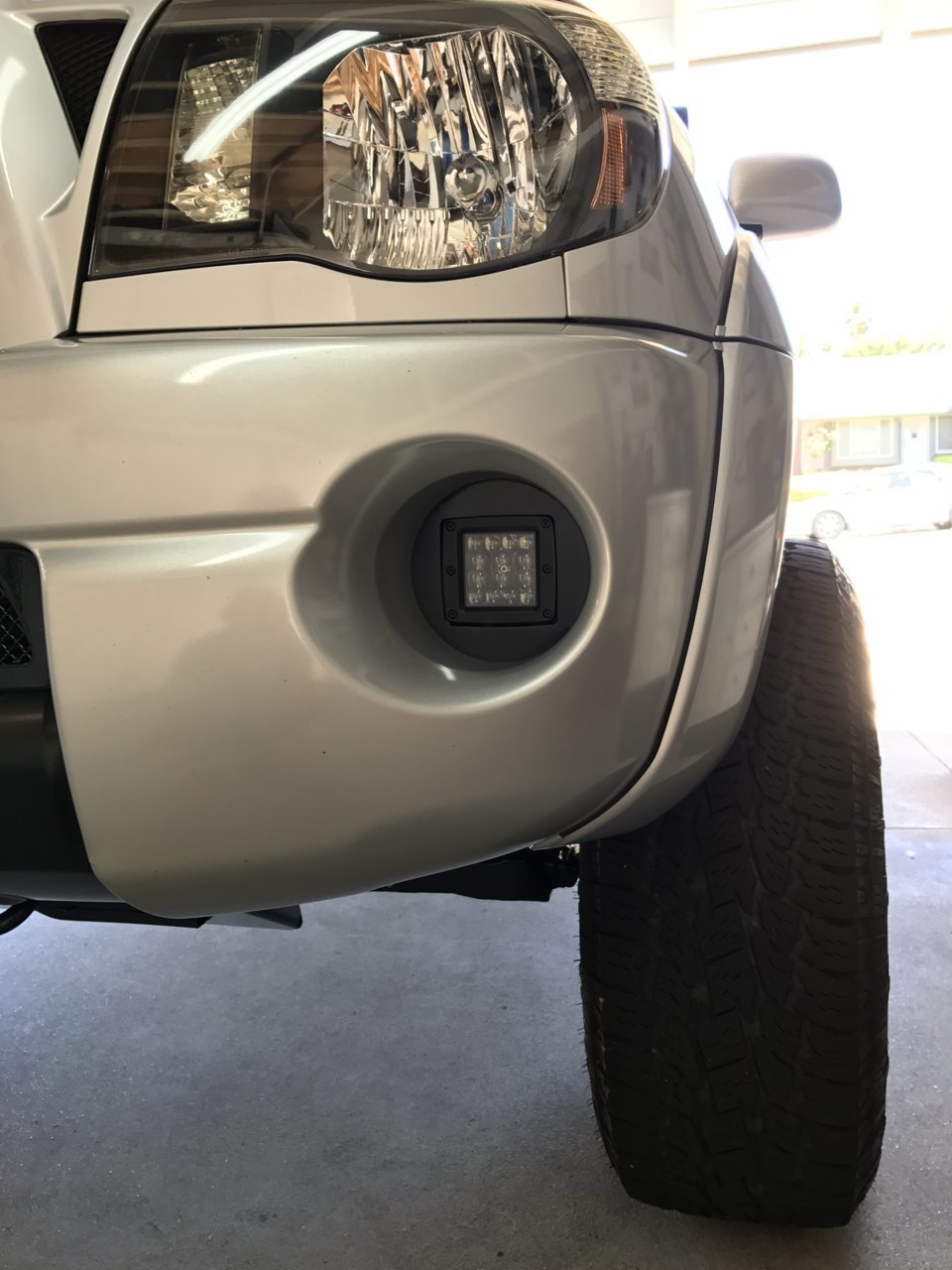

    So the leaf pack is working out great! Ride quality is great and it holds the weight without sagging.
    I got the MESO lights both dome & maps. The are awesome and retarded bright. No pix sorry you know what they look like. Haha.
    I replaced my fogs with a LED cube setup. Came out pretty sweet with the mounts.

    Where did you order the fog light cubes from?
  18. Jul 22, 2018 at 5:30 PM
    #598
    TommyG
    TommyG [OP] Around
    Jul 25, 2010
    #40725
    2,283
    Grouch
    MELTING POT
    21 MAX
    No mods
    The lights are OSRAM LED made by spawtow ind. they are flood/spot combo. Got on Amazon. The mounting bracket are the apex fab ones. Caliraised sells them. And the H10 wire adapters on Amazon also

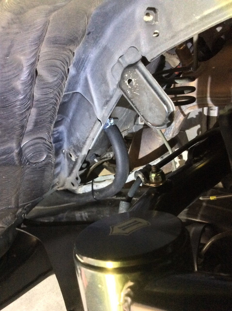

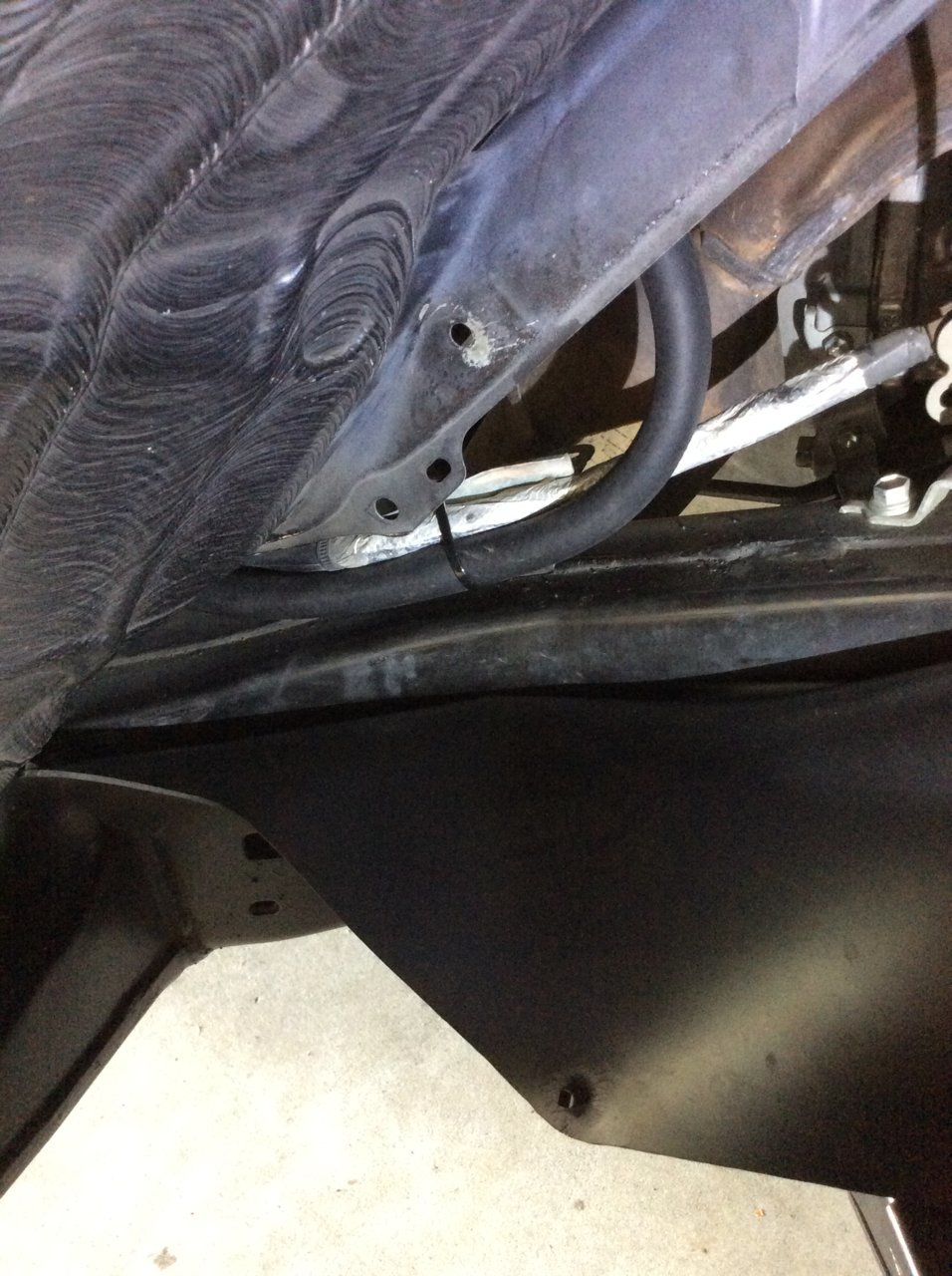

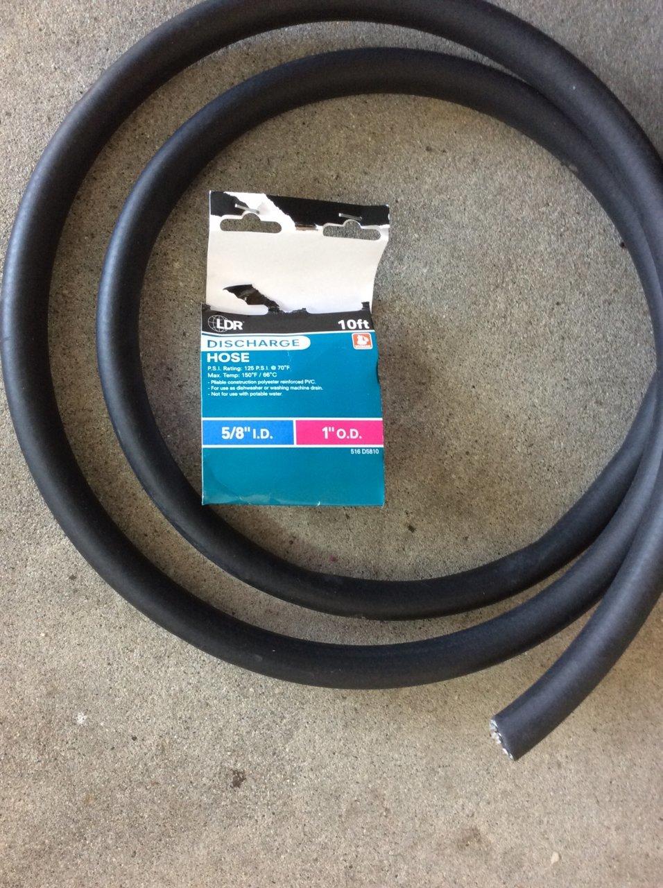

    Messed around with a few things yesterday. No pix but I mounted 2 tape measure clips to my scanguage. It was Velcro to the headliner but it's been so fucking hot that it's finally not sticking anymore. Speaking of it being one of the hottest, humid summers we've had here, my A/C has been running non stop. I decided to extend the run off hose since it just dumps out to the frame.

    If anyone local wants to do the run off extension, I got enough hose left to do 2 trucks
