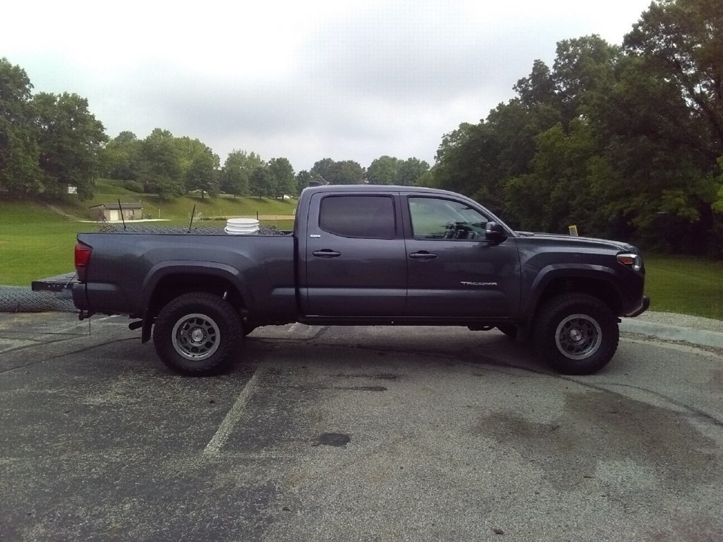

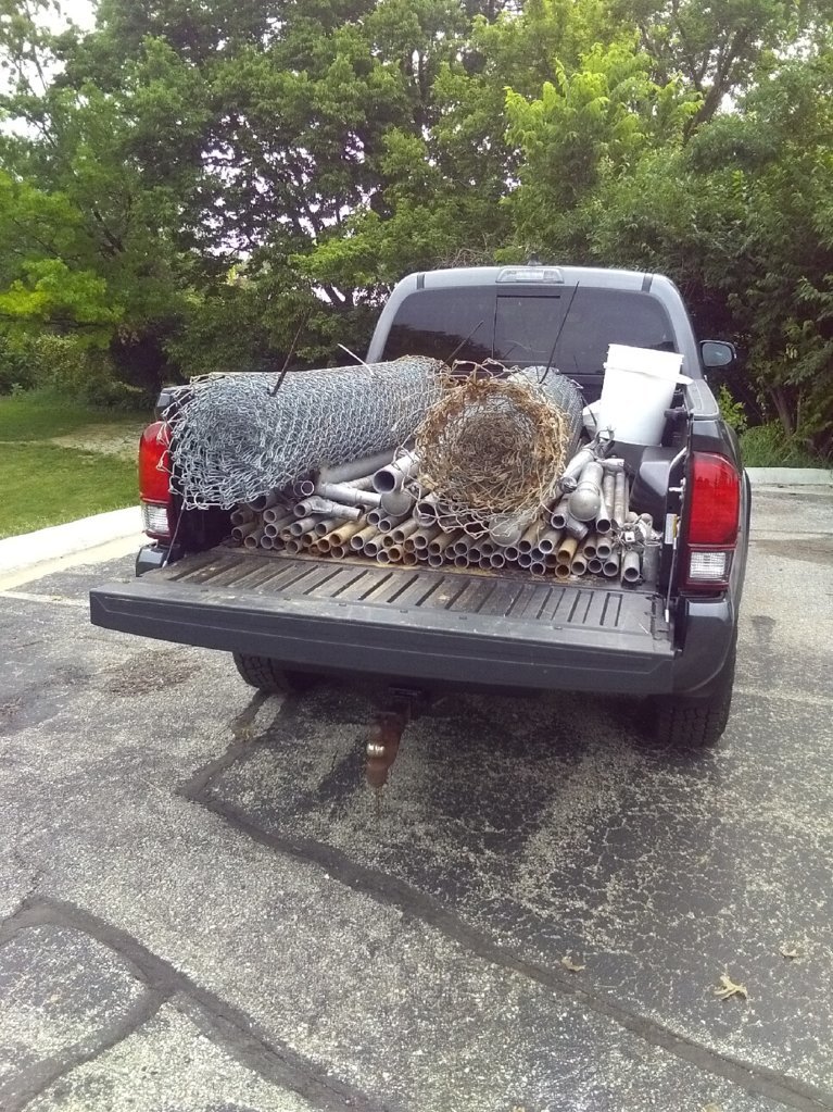

    While it's only been two weeks, I've been happy with my Archive Garage MD springs. They have a fitment chart on their website that shows the "expected" lift at given weights. The pic below is my truck with 1200# of scrap metal loaded in it.

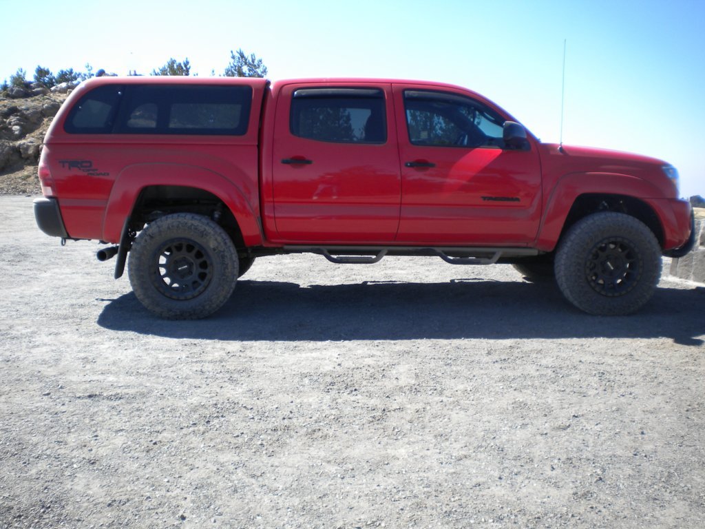

    this pic is with stock springs and a hellwig helper springs

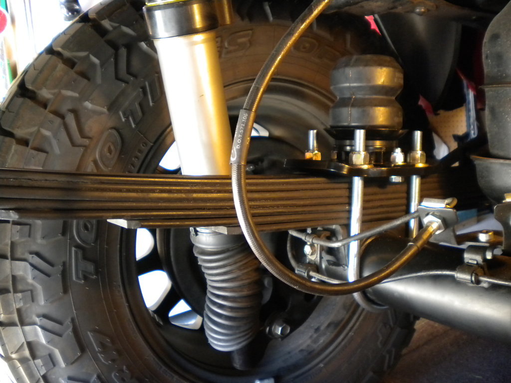

    Icon RXT with Timbren bump stops. This is option 2 with just the weight of a canopy (2" lift front/2.25" rear after settling.) Have carried 200lbs of sand bags in the bed and the leafs hardly budge.
