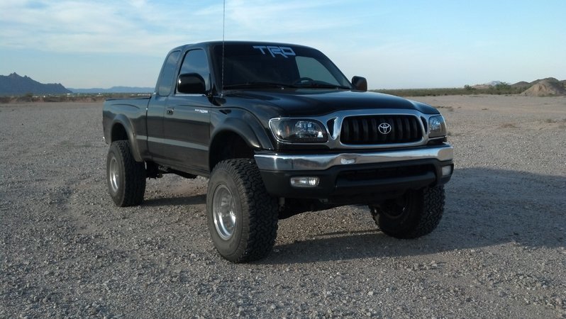

    You COULD just get 2-3" spacers and blocks. I had that for like 4 years. The cheapest option. And it's not THAT terrible. Its frowned upon here. But I was happy with it. It was already installed when I purchased the truck. But planned on upgrading down the road which I just did recently. If you're looking for a VERY basic lift (for looks over function and serious budget), it'll work. Cleared 32's ok. Little rub on pinch weld iirc. It'll hold you over until you can afford to get a "proper" lift with new coils, shocks, leafs, all those little extras that end up costing $1k up. My 5100/eibachs with dakars (and all the extras like brake line, greasables shackles, etc) costed me $1300. Plus off road ucas added on top of that if you opt for those.. Spacer lifts will cost ya about 1-2 hundred. I'd say go for a 2" spacer kit for now. Anything more than that (2.5" at most) and you'll have a terrible ride and most likely need ucas.. Then start saving for the real stuff. Or just run it! Again I rode with my spacers for a long time. And it rode ok. Certainly a lil rough. But was acceptable for the looks as well as bigger tires, and even more off road capable even if just slightly only due to a lil more clearance and the bigger tires. I'm not completely satisfied with my eibachs.. They're stiff as hell at 3". But that's my fault for not researching more into it(as well as "one" other person saying it rode nice) and picking a better option more suited for my truck and needs(eibachs are only meant for 4x4 with lots of additional weight up front, NOT a prerunner, heh). I would have to say the spacers rode better tho!! Ha. I'm sure if I had the right coils its be a ton better. But I'll live with it for the extra height I gained. Especially if it holds up better with the bumper and eventually a winch. I don't off road much(yet), just occasional stuff, and the may times I did hit the trails with last setup, I thoroughly enjoyed it. And certainly not crawling in my 2wd, heh, so the new setup should suffice. The rear definitely feels way better than the front. Still gotta take it out and see how she flexes. But pretty smooth out back with the dakar leafs and 5100s. An upgrade from blocks for sure. But for my needs, or yours, it may not be worth it. It will in the end when I do actually need them. But at least I've future proofed myself now and should be good to go for quite a few years, versus only a couple years (maybe more if she's a street queen) you get out of the extra stress/wear&tear the spacers and blocks do on your stock components. Eventually I'm going for an expo type setup for trail runs and camping and whatnot with extra recovery gear, winch, bed rack and rtt... So I should be set to go with my current setup. Just maybe some different coils is all. We shall see...
    Here's when I had spacers and 32's.

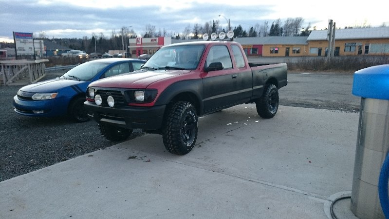

    you want as much backspacing as possible without rubbing frame or uca. so about 4.5-4" for 11.5s (some tires have side lugs that will hit uca on 4.5". my maxxis bighorns do)
    like i said earlier they fit fine stock with the BFH treatment and looked super beefy. Actually they rubbed worse AFTER the lift on the frame.
    heres an old pic.

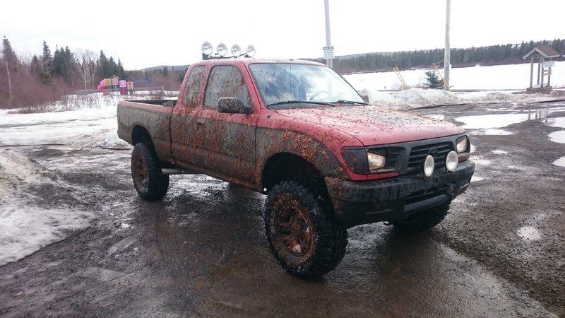

    heres 5100s at 2.5" and 2" aal
    heres with 5100/eibachs and 2.5" leafs

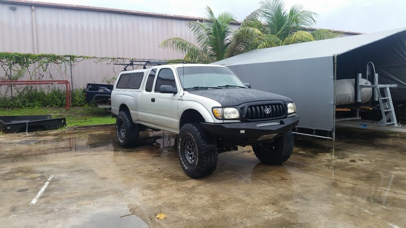

    Bes lif eva, puck spaca fo lyfe!20160802_130146.jpgSeriously though the only reason I have it is because it was free, as cheap as cheap gets. But if you really want a lift, cheapest is 5100's up front. Level it out and upgrade later! I believe Headstrong is the cheapest place to order from

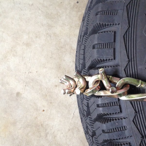

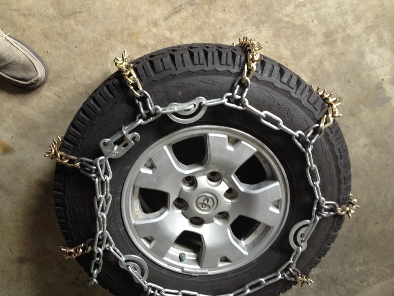

    Many thanks for your posts. I am looking at what is needed to provide adequate lift to easily fit tire chains on my 2002 Toyota Tacoma 4x4 Double Cab TRD. Chains are rarely needed but the National Park Service requires all vehicles to put on chains when snowy at Mt Rainier National Park and presently, there is lots of snow in the Cascades. My Yokohama Geolander A/T-S LT265/75R-16/D1 119R 8 ply tires are too big for easily installing tire chains.

    You and I must have the same kind of tire chains.
    OP you should have room for standard chains (especially non V-bar style) on the rear. You'r not required them for the front.
