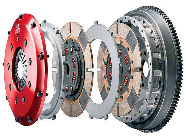

    does anyone suggest any good offroad purpose clutches?
    im looking to replace my 160000 mile clutch on my 91 pickup sr5 4x4 and would lie to buy a good clutch for it
    let me know thank you![​IMG]

    x2. Cheaper than OEM and much stronger.

    Unless it's a hardcore rock crawler with a foot or two of lift and an exoskeleton that you're just gonna thrash the shit out of, what's the advantage of a heavy duty clutch setup over a factory one? I feel like all of the qualities of the OE clutch would be ideal for offloading.

    check out LCE engineering, they have some clutch kits for your truck.

    A 33% increase in load rating.
    The factory pressure plate is only 900 ft lbs. Don't need an exoskeleton to take advantage of that. And it's cheaper than a factory clutch.

    can the marlin crawler be used on a daily driver that sees occasional offroading? or is it more of a pure off road clutch?

    you can use it daily, many do.

    I have a Marlin Crawler in my daily driver. Heavy duty clutch kit in a 2000 Tacoma V6 4x4 and I love it. Much better pedal feel and a very strong pulling clutch. My OEM began slipping at about 192000 miles. Would highly recommend this clutch.

    Centerforce dual friction. Has stood up to the LT4 for about ten years now with no problem. DD for about four years on 48's and strictly wheelin' duty now on 42 TSL's. Couldn't be happier with that investment.

    I've been happy with Centerforce clutches in the past. My Tacoma doesn't have one yet.
