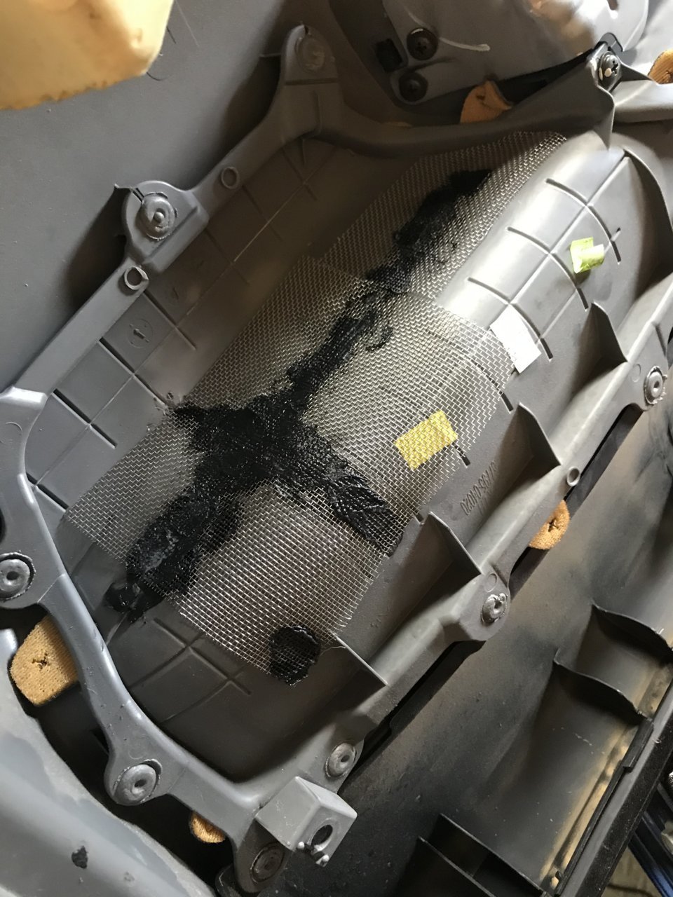

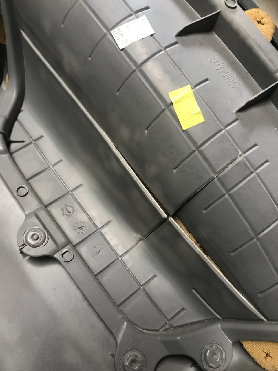

    Finally fixed my armrest prolly 5 years after breaking it, cheap harbor freight plastic welder worked great that was a mid fix repair pic looked better once done.

    My DS is the exact same way I really ought to fix it.

    Lol prolly worst part is going to harbor freight to get the plastic welder, or not burning yourself with said welder :rofl:

    I'm probably going to go the epoxy with a fiberglass mat to fix it. It's in a bunch of pieces the cloth is what's holding it together right now.

    Yea I saw somebody sells vinyl that’s precut and matches the other panels, but that was way more labor than I wanted. I’m just happy it doesn’t pop and I can lean my arm.

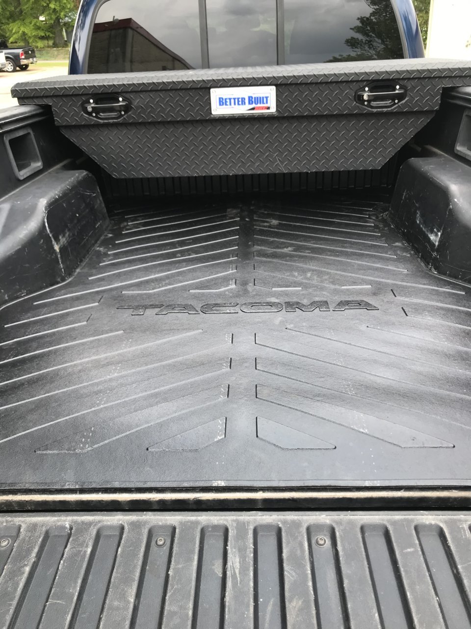

    Picked up a bed mat on a sale with free shipping today, dog will appreciate not sliding around.
