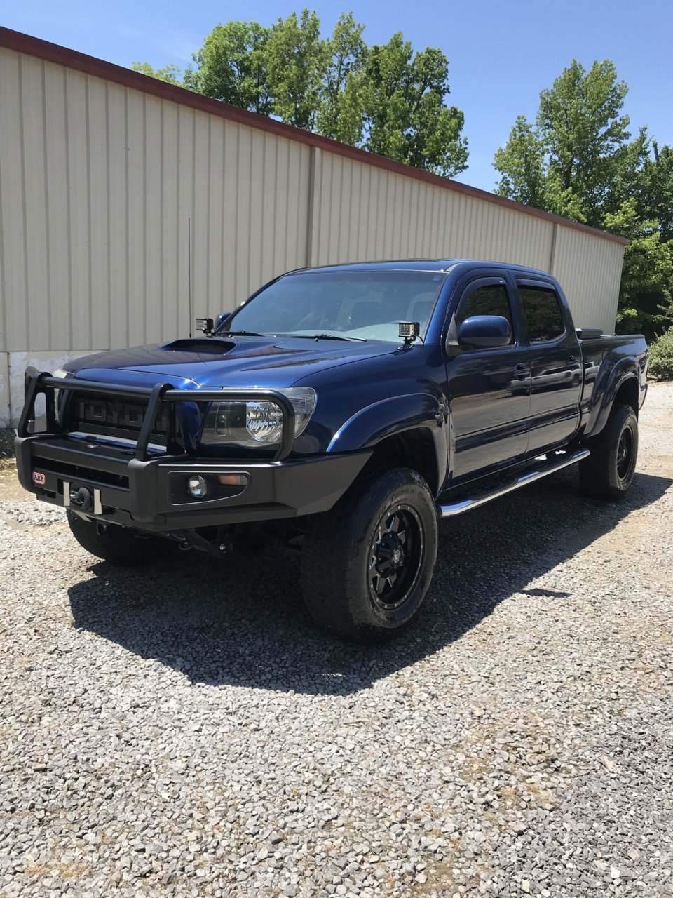

    Got a wash job from the mobile detailer that comes in to work and gets supplies #thattireshine.

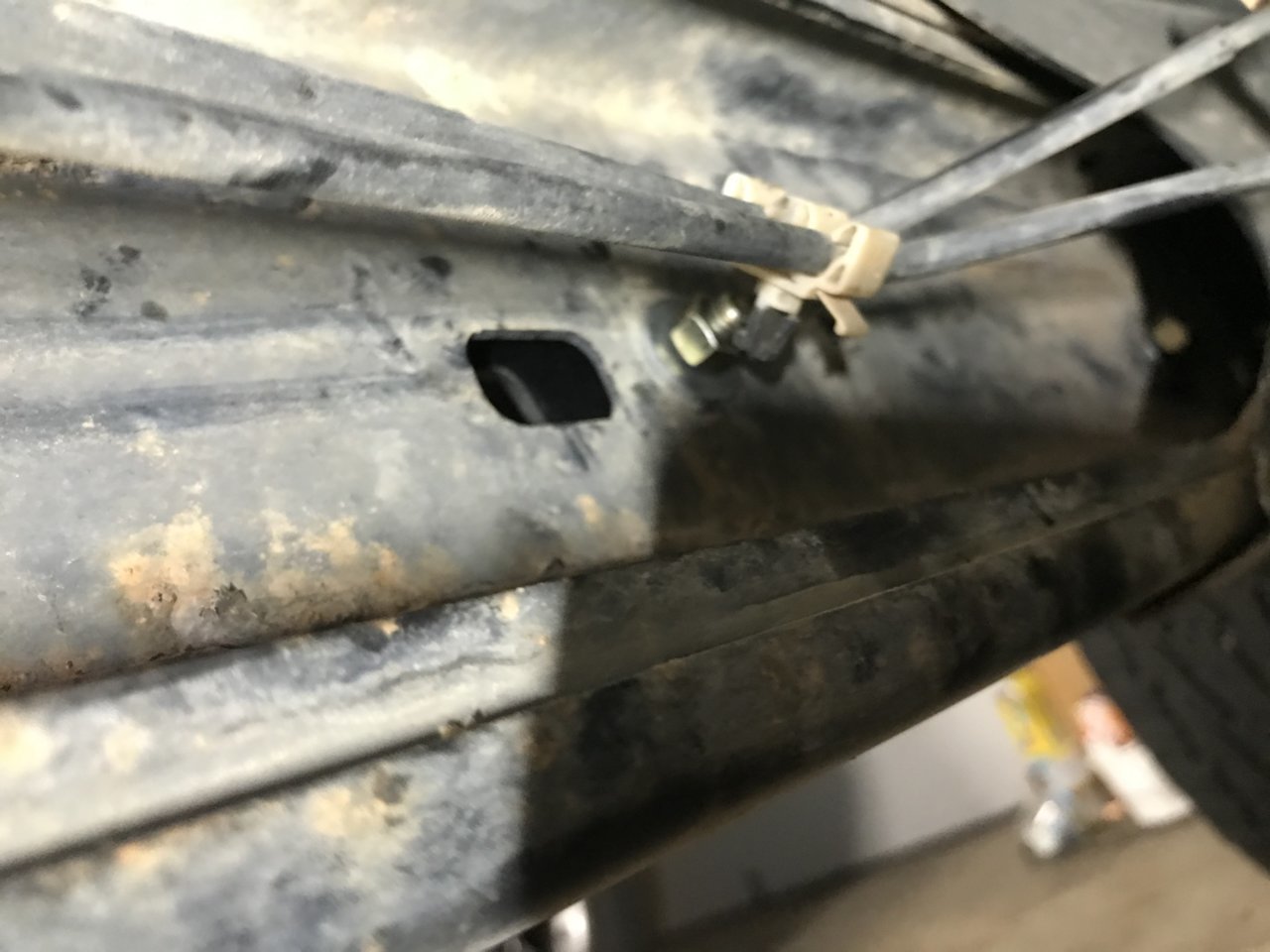

    Okay @ovrlndkull ive got 1/2x1.25 bolts here, and one 3/8 in that hole that the brake line holder was.
    One 1/2x1.25 in that hole with room for one above the 14mm reused in the bottom of slider.
    Room for a 1/2x1.25 in that frame spot one 3/8 in that brake line holder hole, then two 1/2x1.5 in the front spots. Does all that look right?

    Did you get the one up in the very front you have to stick your arm up in the frame at the very front for that one.

    Yea that was the first one, try and do the difficult stuff first. Should the 3/8 bolts go in the brake line holder hole or put those mounts back there?

    Mine are still there. I pulled my brake lines out of the way and left the little plastic clips there but that isn't a half bad idea to throw some 3/8" bolts there.

    That was the only place I could guess the 3/8 bolts would go? I’ll look tomorrow may take them out and put brake lines back if they’ll go since looks like I’ll put more 1/2 bolts than most do.

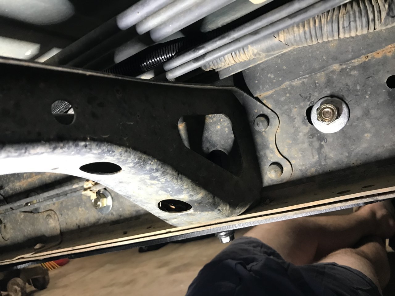

    Well their on there lol, had to trim for an extra frame rivet. Overall not bad really like them better than oem steps!

    Hey @ovrlndkull that rivet was about an inch over and 11/2 up from the end, got to use my new grinder everything else went pretty good.

    Ok cool I'm going to send your pic and measurements to Eddy. Thanks man
