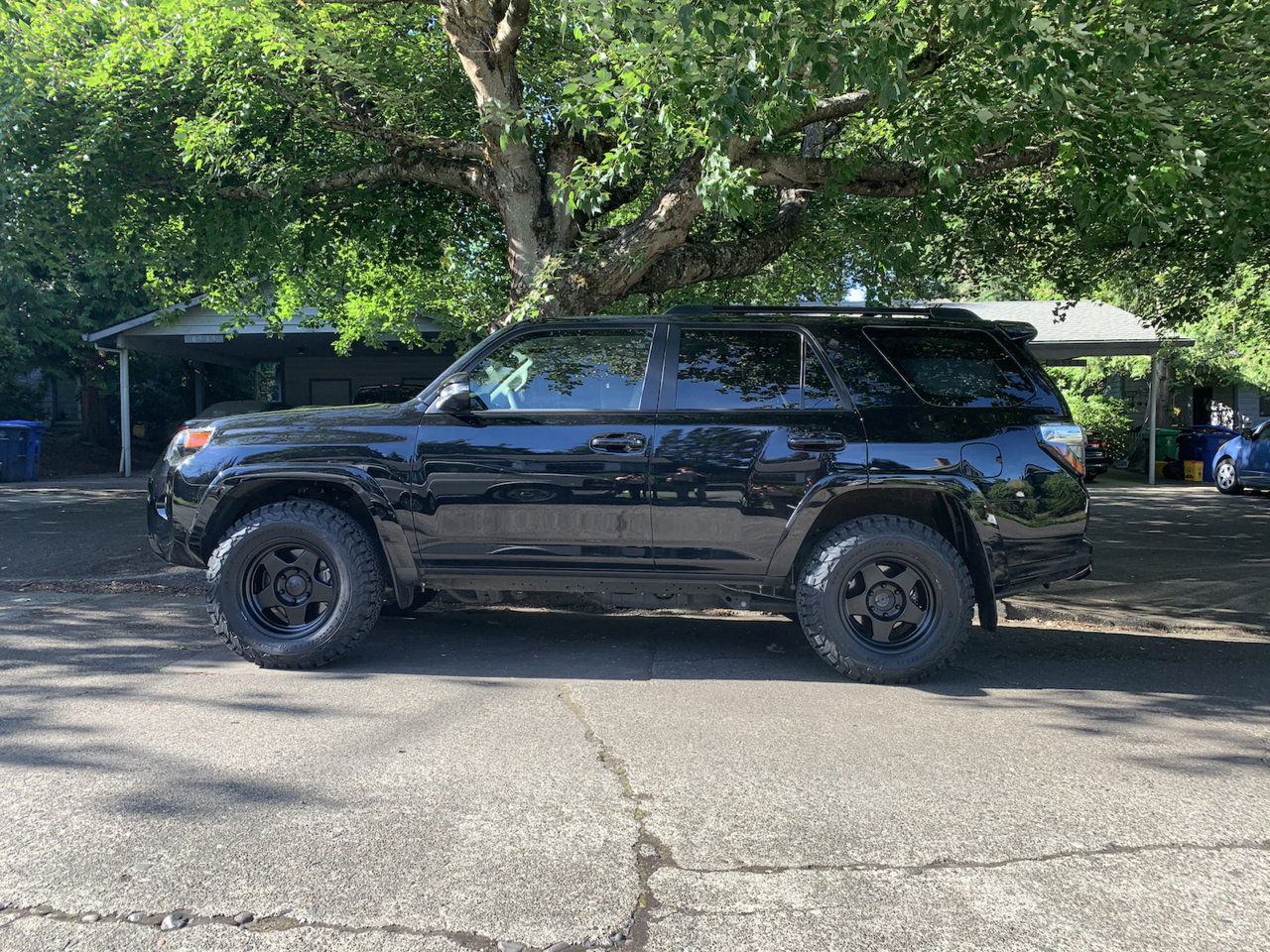

    ended up going with the SCS F5's!
    they create a good amount of rub when reversing, but looking into cutting the liner.
    however, the poke is super minimal and exactly what i wanted.
