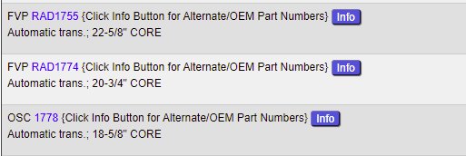

    I need to replace the radiator on my 2004 Tacoma PreRunner V6, Auto - I've been looking in RockAuto for the correct one and not knowing much on which one the truck has in it now its a crapshoot.I hate to get the wrong one and have the hastle of returning it. The truck VIN#5TEGN92N04Z373929 if this helps anyone to let me know which radiator to get from RockAuto. While I'm at it I may as well replace water pump, hoses and Thermostat while I've got the front apart. Truck has 175K mls and the temp gauge is starting to go above 1/2, will have to do some serious cleaning before installing the new rad/WP/T-stat since it looks like coffee is running in that rad now. (dark brown liquid)

    @Nessal - Thanks for the links
    The issue is not where to buy but more which radiator to buy. Here's a small sample of RockAuto choices
    which one is the correct one (see the different cores sizes) - I can go and measure the radiator are the dimensions top/bottom or left/right

    I think if you measure your current rad then you can match it up better. I'm thinking the difference between those might be the manufacturers making them to difference sizes. I hope someone can correct me if I'm wrong but the difference was between a manual and automatic because the automatic radiator has a built in transmission cooler...though I don't know if that is relagated to only a certain trim.

    I'm getting this as the most likely toyota raditator part number candidate. 16410-0C042
    s0,, Denso 2213138 or the FVP RAD1755,,at first glance
    Bust out the tape measure and check things before ordering, like spacing between cooler fittings on the bottom of the rad, core size, ect.
