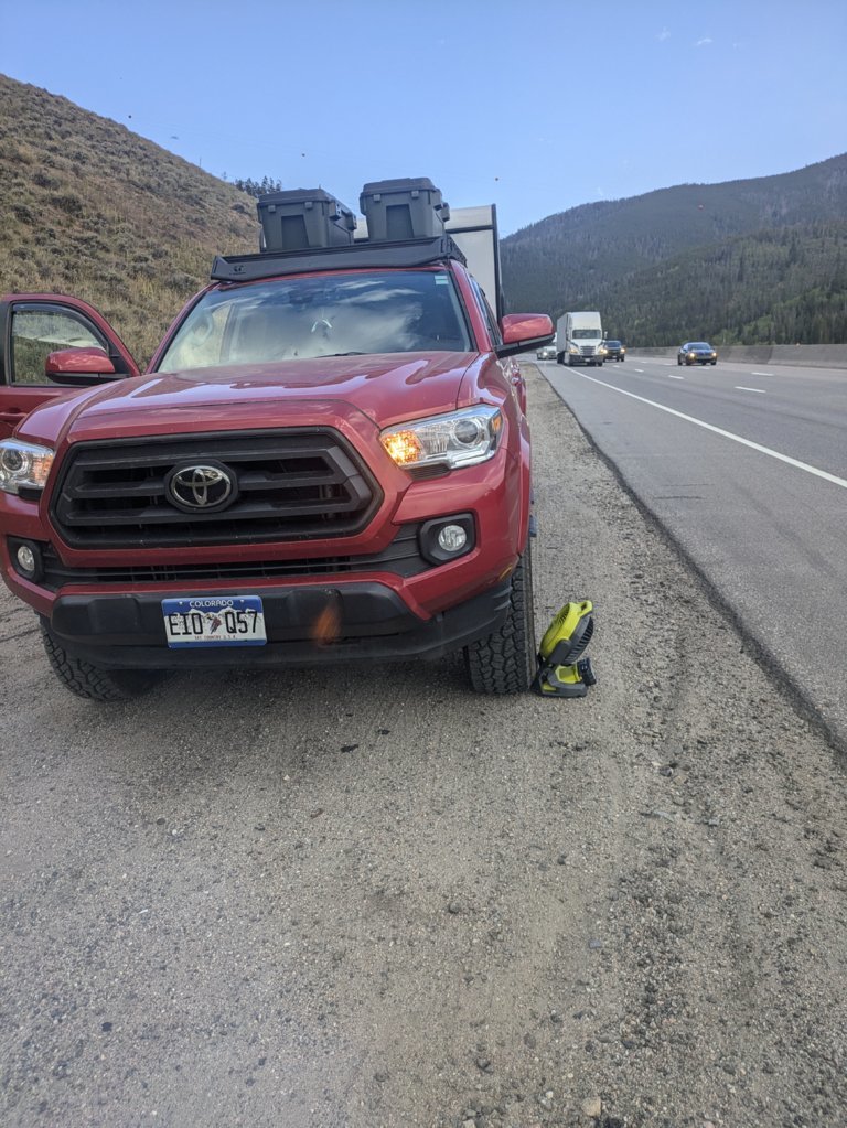

    Looks like my new camper might need some better pads, have been getting some shaking when they get too hot on I70. Haven't weighed myself yet but I will soon, I think my pads might just be a bit old, probably stock? Not sure.
    Any suggestions for high quality pads to upgrade to? Trying to avoid a big brake kit, but I might consider it if this keeps up. Usually not an issue unless there's a ton of stop and go like today.

    Not even sure that is a trailer. OP please clarify, slide in camper or trailer?

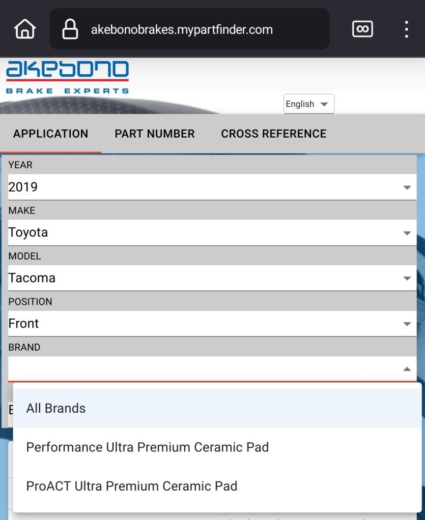

    I'm about 50% pad material. First I have heard of akebono. They offer two types for the tacoma, both ceramic. Any idea which ones you went with?

    I'm not sure. We had a discussion on the shop floor, the Akebonos being firmer (harder compound) and I said go for it. Four years ago they cost $109. Why not try the least expensive of those listed? He recommended the stock Toyota pads for the rear drums.

    Looks like a travel trailer from the pic.
    Definitely check those trailer brakes!

    It's a contractor topper, not a trailer! Custom bed platform built inside.
