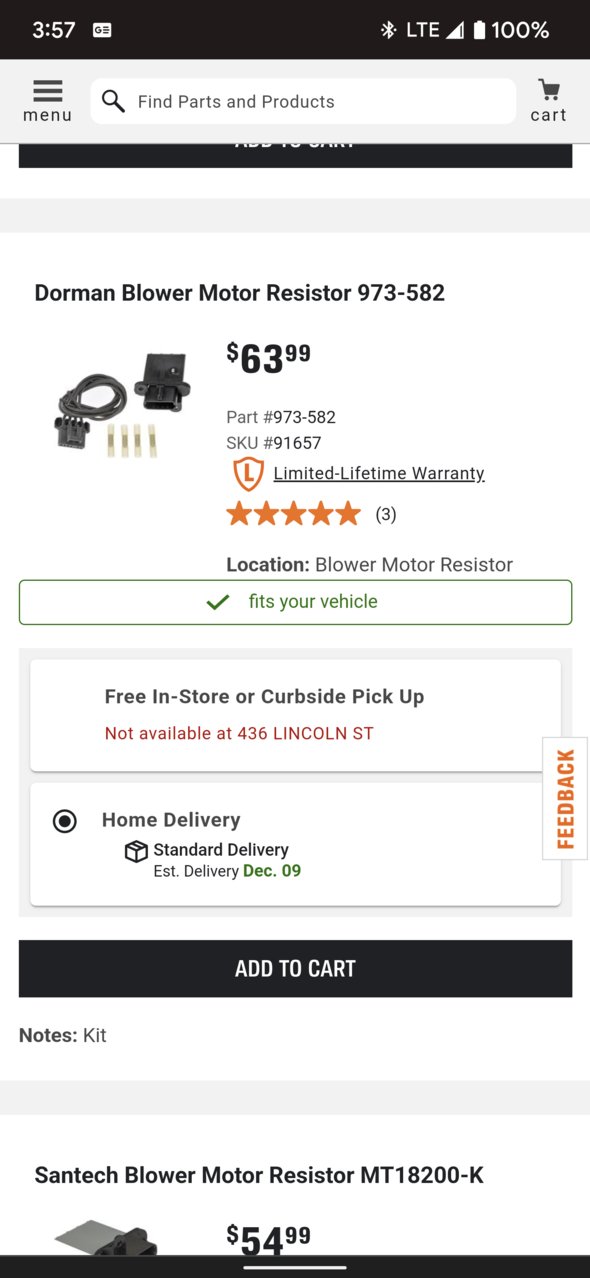

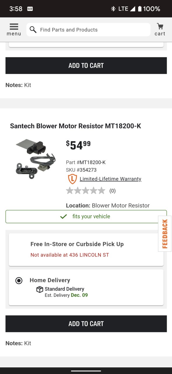

    That is sad. I hope they're not throwing new resistors in and charging you.
    Buy this. They say it is not available at the store. I chose in Portland but you can have it shipped to your house. This is an easy repair. The only tool you really need is a crimper. This can be found in the electrical tool section of home Depot. Look for the standalone crimpers that do the actual crimping on the opposite side of the hinge. These give you more leverage and make a tighter crimp.
    Good luck.
