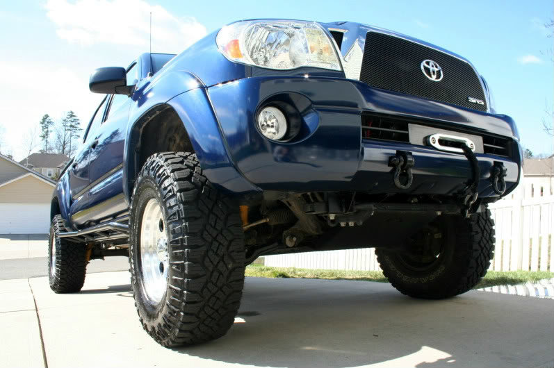

    If you stalk Streetsideauto long enough, you can get a super deal on a Warn. I picked up my M8000 for about $430 by time I had all of the discounts and gift cards they offered.
    Mount is the undercoverhwms
