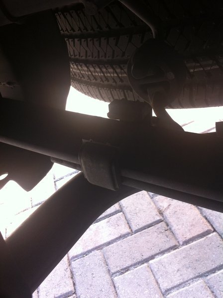

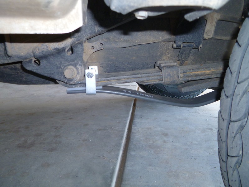

    I have a 2007 2WD Prerunner and I believe these are 1" lifting blocks the previous owner installed. I noticed my 3 pack leaf springs only have two clamps which I thought they were suppose to have 3 or 4 on each sides spring pack. Do these look ok or should I install the U bolt fix to help out with the axle wrap which I mostly notice at stops.

    I think you've got a leaf missing or either they changed it up for the 2nd Generations.

    Not sure and I was wondering why there was such a huge gap in the brackets...

    I believe they made a 2+1 factory leaf pack BUT my truck has the tow package which apparently is the reason I have a pink pulley in the engine bay. The owner I bought it from was the original owner and he would tow around his fully dressed Harley. He mentioned when he first bought the bike he actually drove a state away to pick it up and drove home with it in the bed ( i have the long bed). Is this correct they made a 2+1 the truck rides great I have some axle wrap at stops but I never haul anything except for a gun safe recently which cause the truck to barley squat down a bit.
