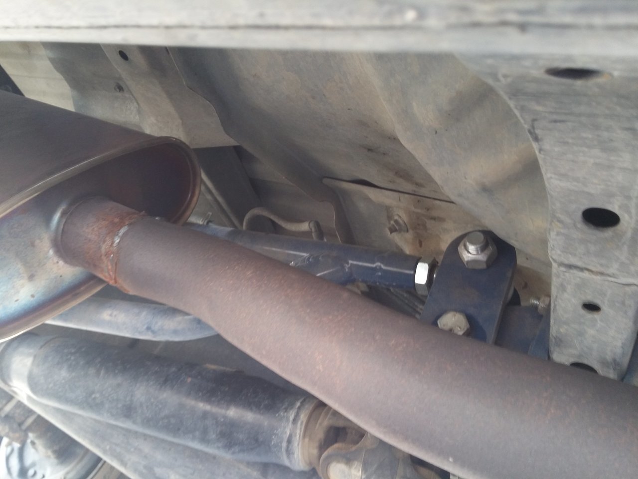

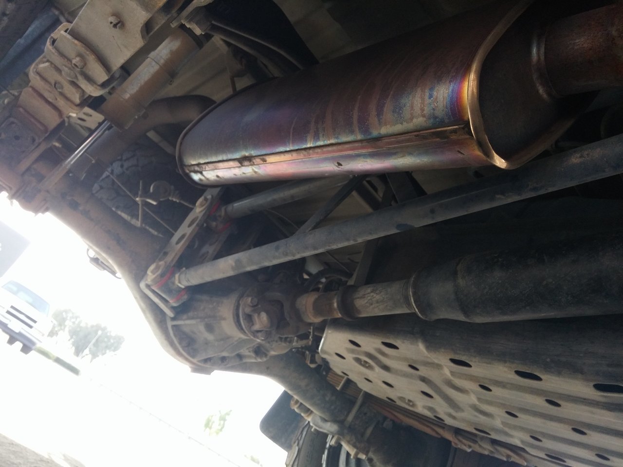

    So I just got around to installing the whole helper set, and I also had my truck raised while installing them. I did forget to take a measurement for a before and after compare. I think with the truck lifted, there may be a 1/2" or so of raise. Not the purpose of the install, but damn, I'm quite pleased with the end results. I also removed the front sway-bar, so that boat rocking action was live and well. Until I threw these on. It's almost like sway bars for the rear.. I like it, am impressed, and feel it keeps the tires pasted to the road, whit less roll. No axle wrap. And now to get the feel offroading.... Thanks everyone, Bros of the Taco for all input...

    That setup will hit your frame as the picture shows the OEM bump removed and this in it's place. Also, that pic is not a Tacoma from what I can tell.
    Go with the BudBuilt unit.
