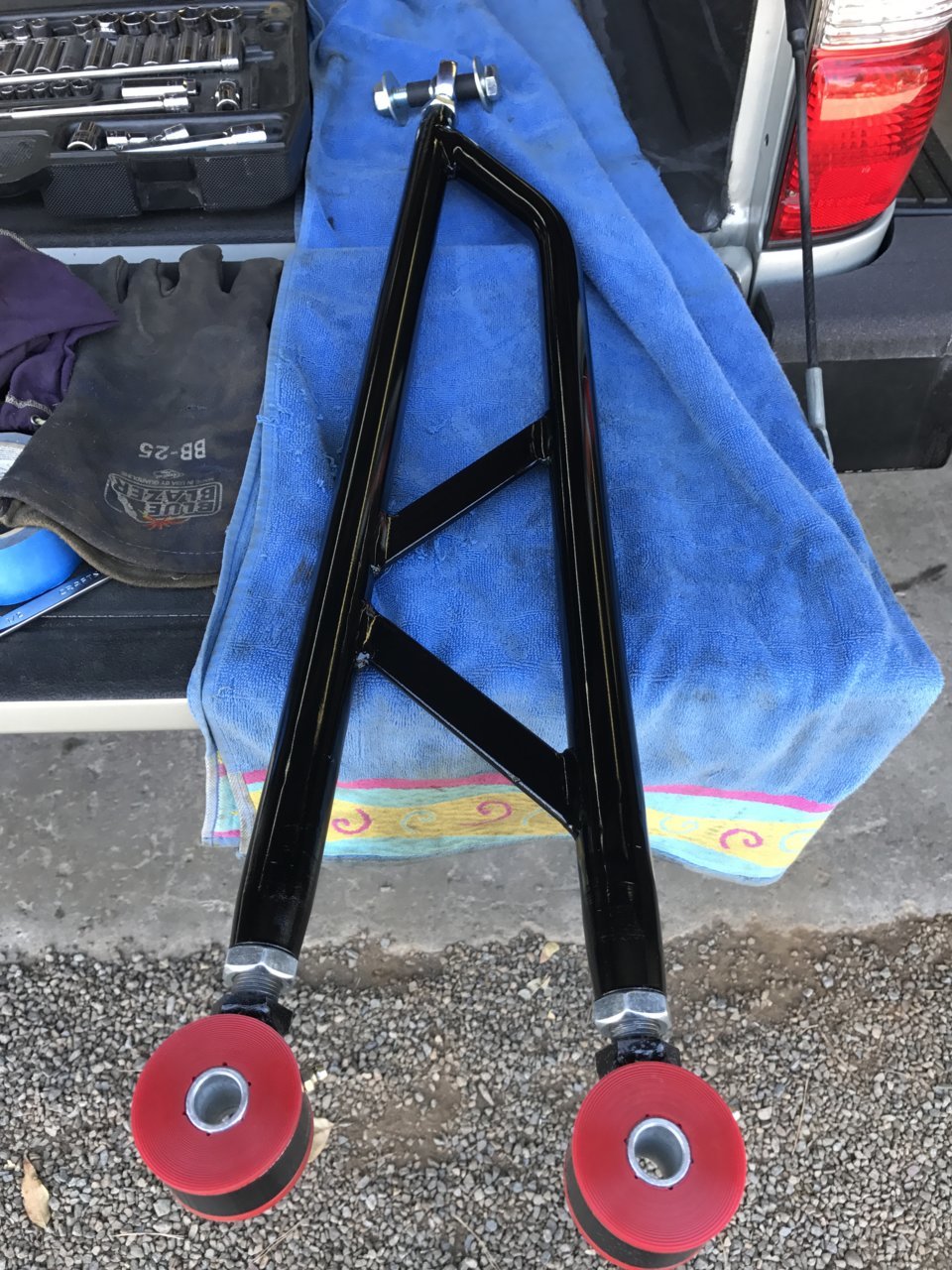

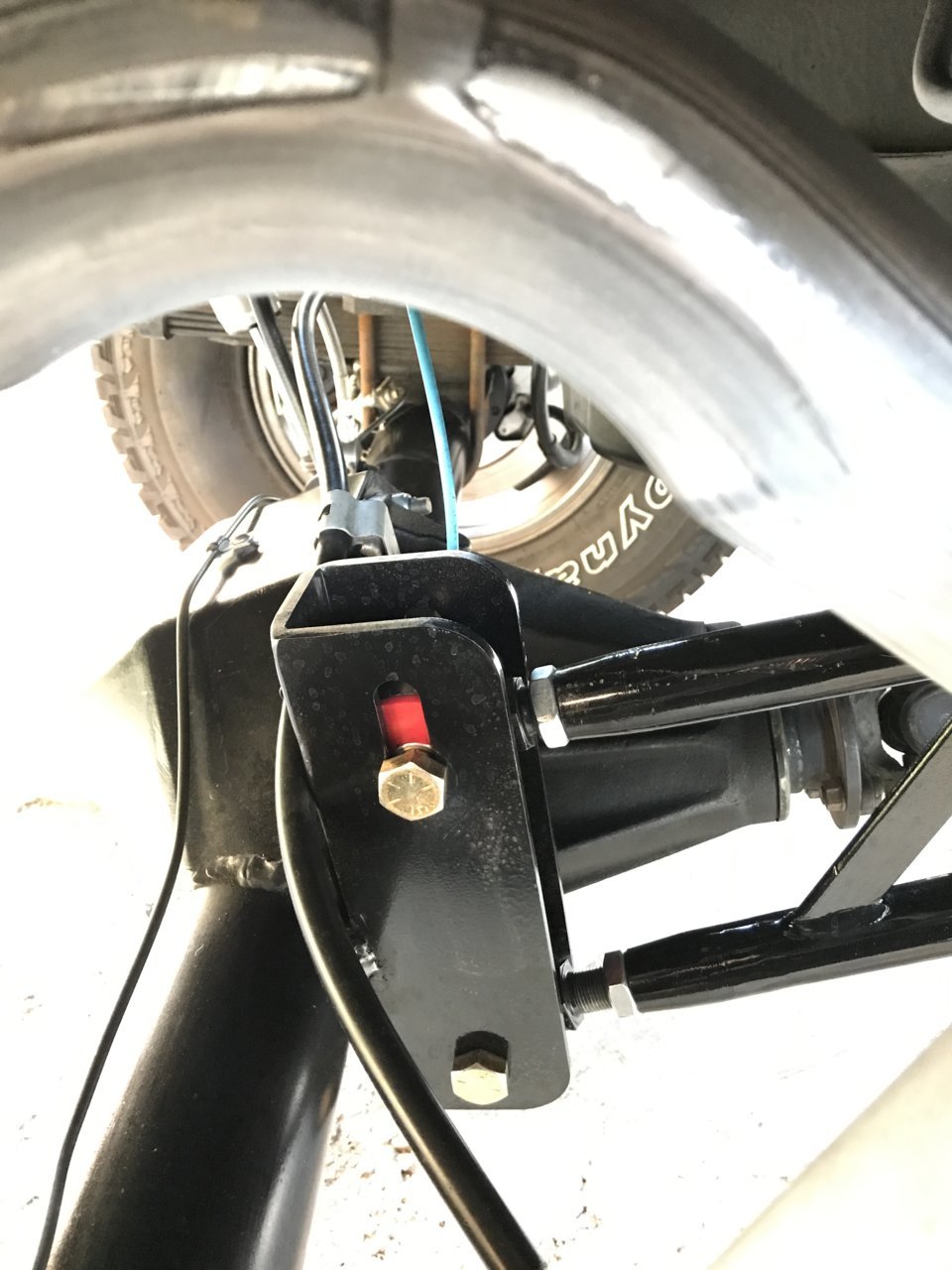

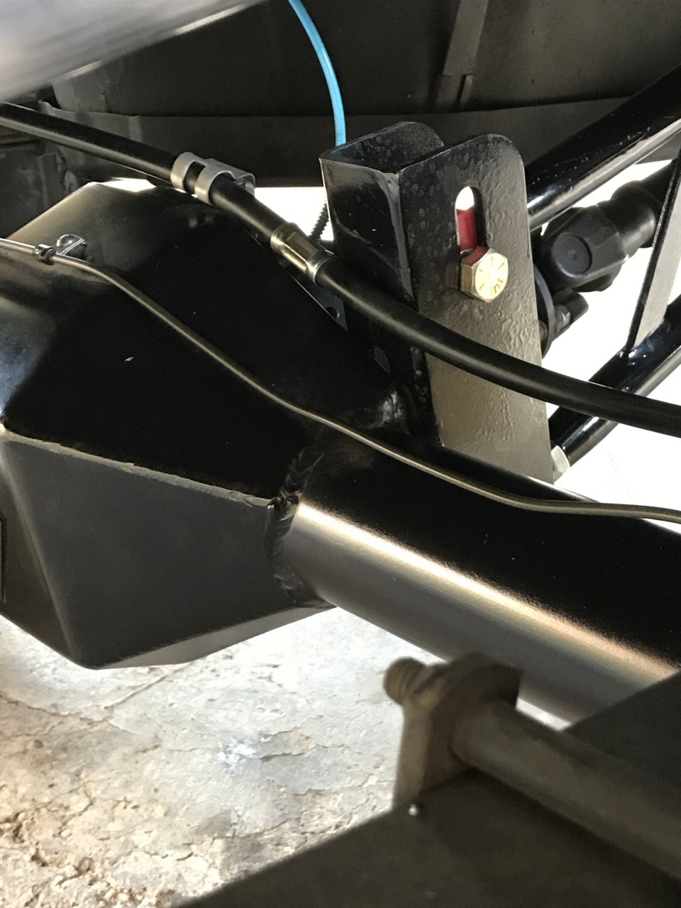

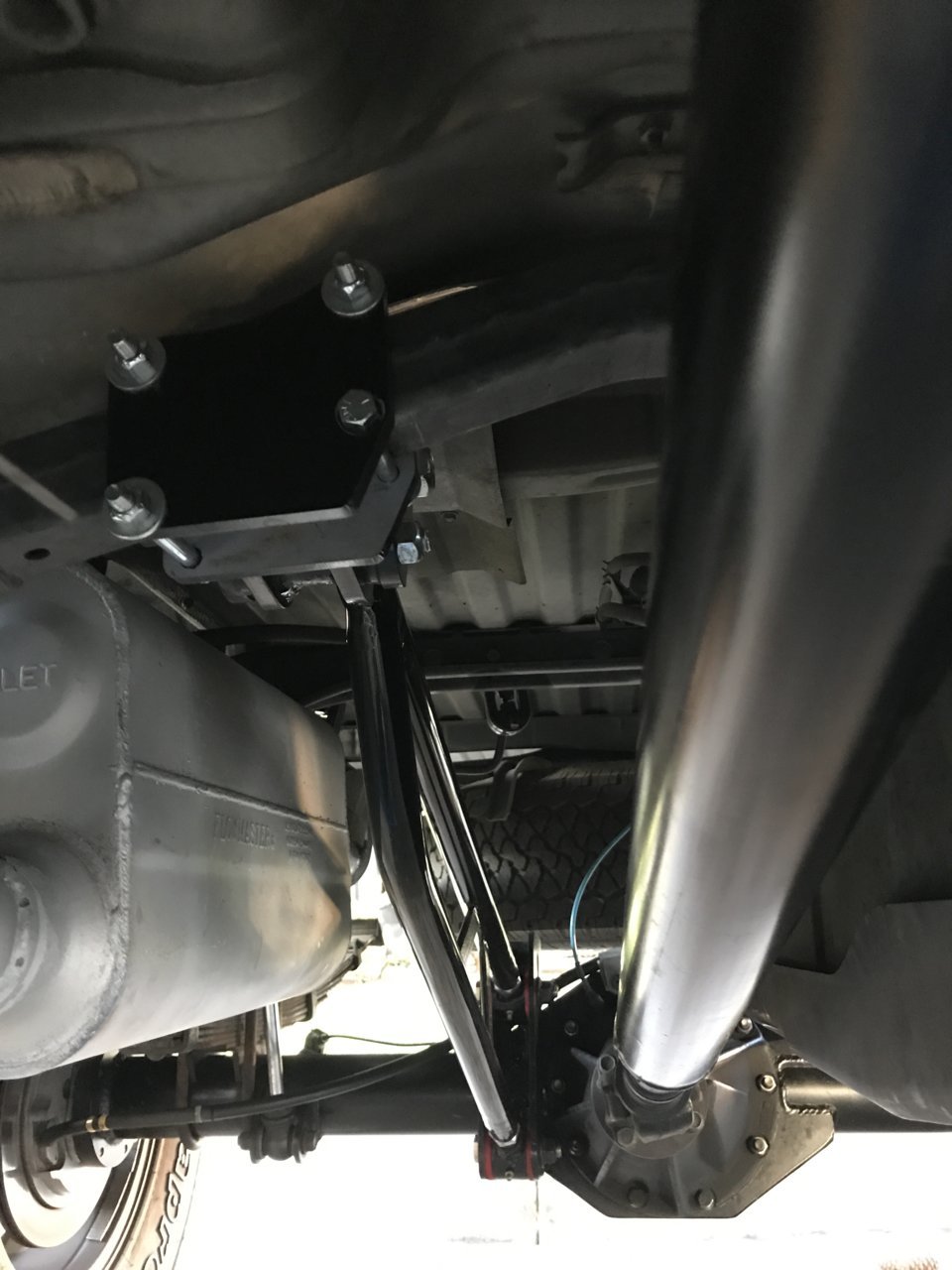

    This is how to completely eliminate axle wrap if you have leaf springs. Bud-Built sells them. It's a beautiful part for sure.

    I did modify mine as the pieces are for extra cabs & 4 door 1st gens. I have a regular cab short bed.
    Mine will be available soon as I'm 3 linking the rear so I will no longer need this awesome part.

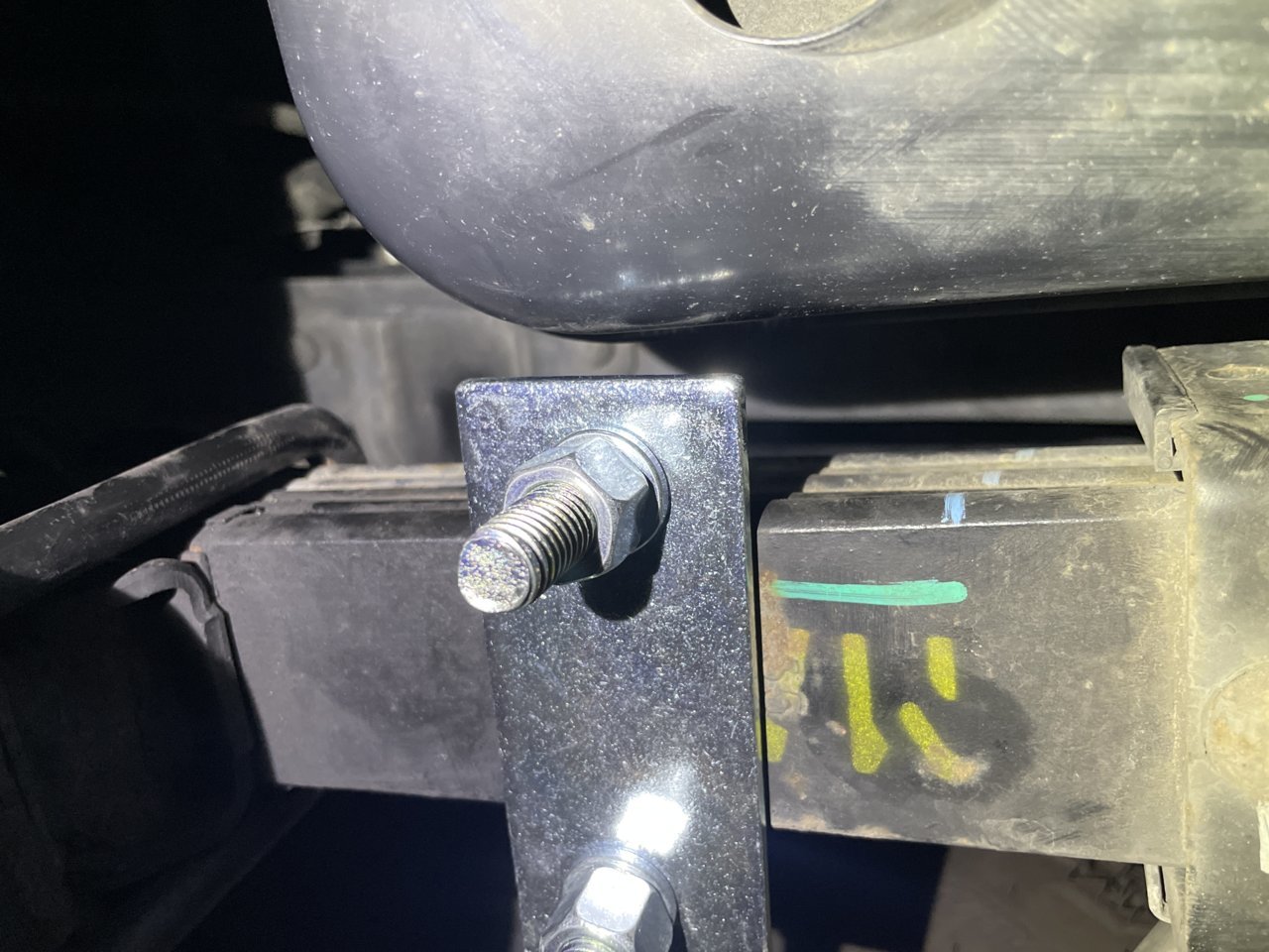

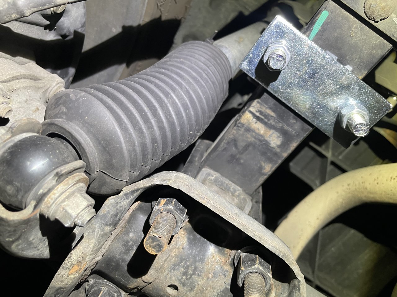

    Reviving this old thread - but hello from a 3rd Gen owner who has been experiencing axle wrap for quite some time: I found this thread and decided to give the clamps a try. I bought the 2.5in kit from autozone and wanted to check in with y’all to see if the width is too close for comfort. On the driver side it’s pretty close to the gas tank and the passenger side it’s kinda-ish close to the Shock. My question is - from daily driving will there be enough flex to contact either the gas tank or the shock? Or is it safe? Or is this cause for concern - and I should shave off some of the plate or look into getting the 2in kit? Appreciate any help!

    well; after a good while, and some good suspension travel on just the highway, I removed my axle wrap contraption. It marked my shocks and tank enough for me to think twice.

    Good to know - just saw your traction bars posts. Hmmm
