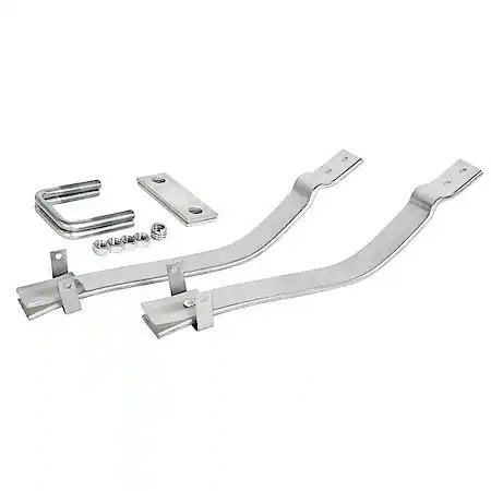

    Not sure if this was covered BUT you can go to harbor frieght and back in the towing section look for the anti rattle hitch reciever clamp its 12.99 you will hafta but 2 its enen heavier duty still than that kit.
    If anyone needs to see a pic of what im talking about i can send you a pic.

    Send a picture or link please!
    Edit I found it i believe: Anyone used this before?

    Yes ive had mine on for 2 years. Be prepared though i had to grind lightly on the side of spring for the u bolt to slide on. I like these better cause the steel is thicker an you can really tighten the nuts down. I have the other style on my other first gen. Both work fine.

    After doing a bit of research I’ve discovered that the Hellwig 2002 traction spring should solve this problem. Since I can’t get Hellwig anywhere in western Canada I’ve had to order them online and will install them when they get here in a week.
    I also wanted to install the rough country 3-1/2 half inch lift springs to replace the BDS blocks the previous owner put in the truck but Rough Country is another brand that in Canada is difficult to get because nobody wants to stock it, they just want to make money off of drop shipping them.
    The U-bolt/clamp in front of the stock U bolt might clamp the springs together but it doesn’t really spread the load out and I can’t see that lasting very long.
    The original post has a helper spring underneath the front of the stock spring instead of on top where a traction spring should go.
    I will post results up when the parts arrive and I get them installed
    If everything goes smooth, it looks like it’s only a 30 minute install.

    I installed the Hellwig 2002 today
    I am not sure why the OP installed his on the bottom of the spring when they are designed to go on top of the spring, but if it works for him, it works for him.
    It does make a little difference but with the 4” block and badly worn out springs it probably doesn’t do as good of a job as if the springs were new. I recommend this inexpensive mod to anybody that wants to rid their vehicle of axle wrap especially after putting blocks in their truck.
