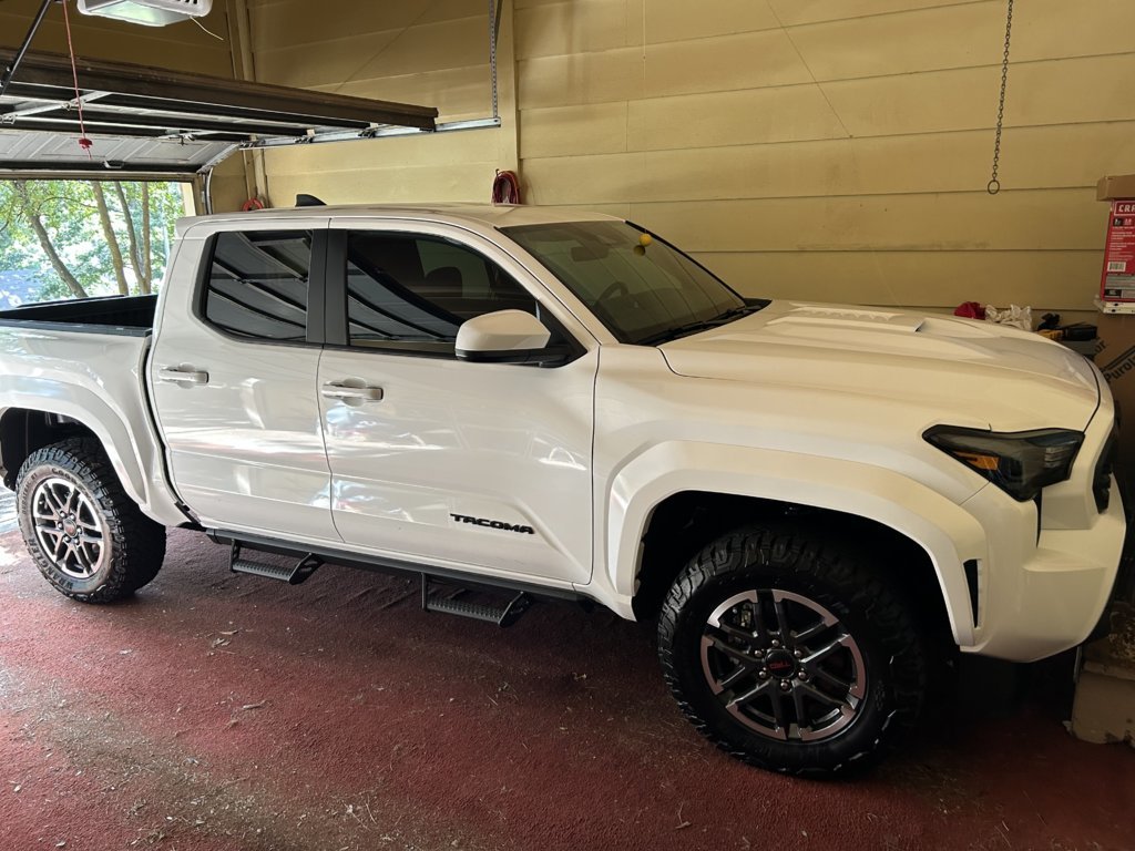

    New to the forum, just bought a 2025 Tacoma TRD Sport came with Goodyear 265/65R18 Wrangler Duratrac tires. On the tires it says... Max Pressure 50 psi. Dealership set to 36 psi. Would appreciate recommendations for their prefered psi to run, for 95% of the time city/highway driving - Thanks ! 2025tacoma.jpg
